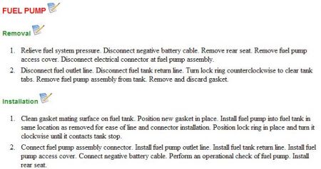

IS THERE AN EASIER WAY TO CHANGE THE PUMP WITHOUT DROPPING THE TANK? PLEASE GET BACK TO ME AS SOON AS YOU CAN.

Your vehicle is equipped with an access panel, no need to drop the tank..Replacement procedures are below..
