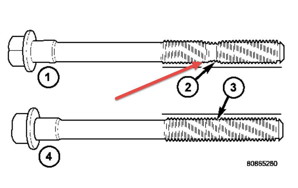

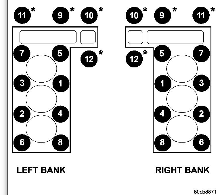

I am for cylinder head bolt torque specs, timing marks, and timing cover specs. and any helpful information with in stalling the pass. side head.
We had a ceased intake valve that caused the rocker arm to explode in pieces. Thanks for the help

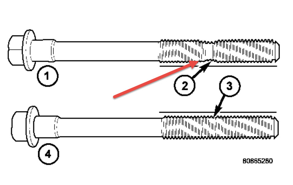

there is to much to copy due to timing chains. your best bet is to rent a book and print out what you need . you can do that through our site here and it will rent for a week. here is cylinder head stuff though. Starred bolts need sealer installed on them. also first pic shows necking on bolts if any of them show that or stretching where thread is not correct then replace them.

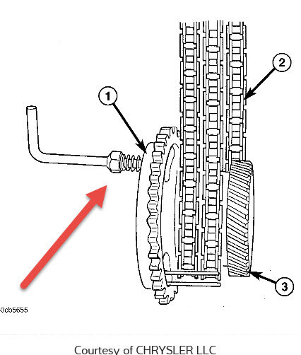

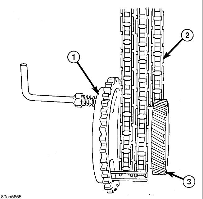

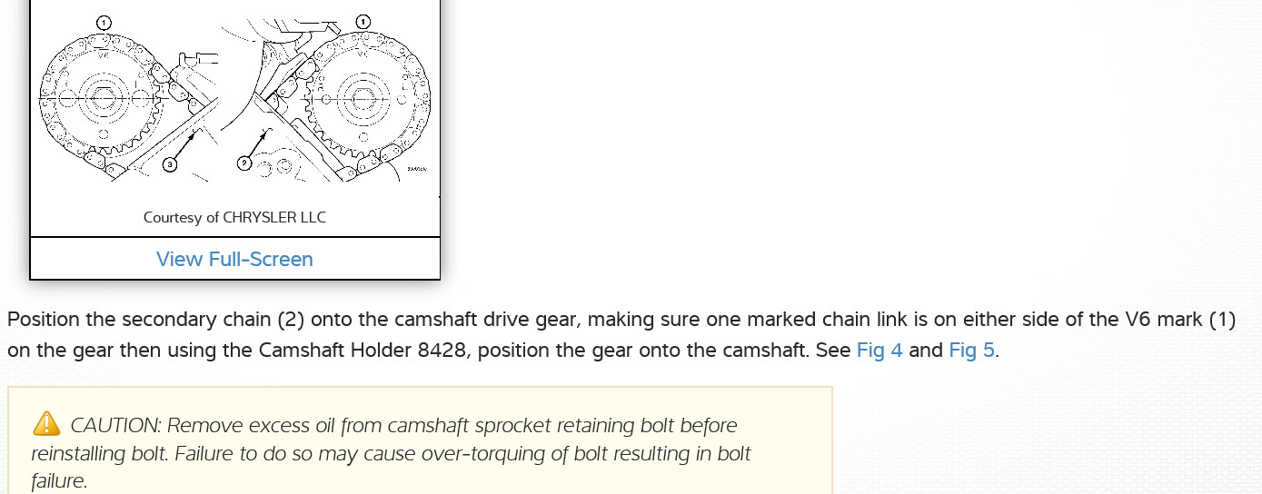

Its a 07' 3.7L i think about 136k on mileage, do you have any info oon this special tool to hold the sprocket above the crank sprocket? Can i make a tool or is there a trick? any info on this job would help a whole lot, this engine design looks like garbage to begin with
Feb 11, 2016 at 1:35 PM
HMAC300
  • 48,601 POSTS
tool looks like a bolt but hard telling what size it is they also talk about a camshaft holder but don't show a pic of it..
