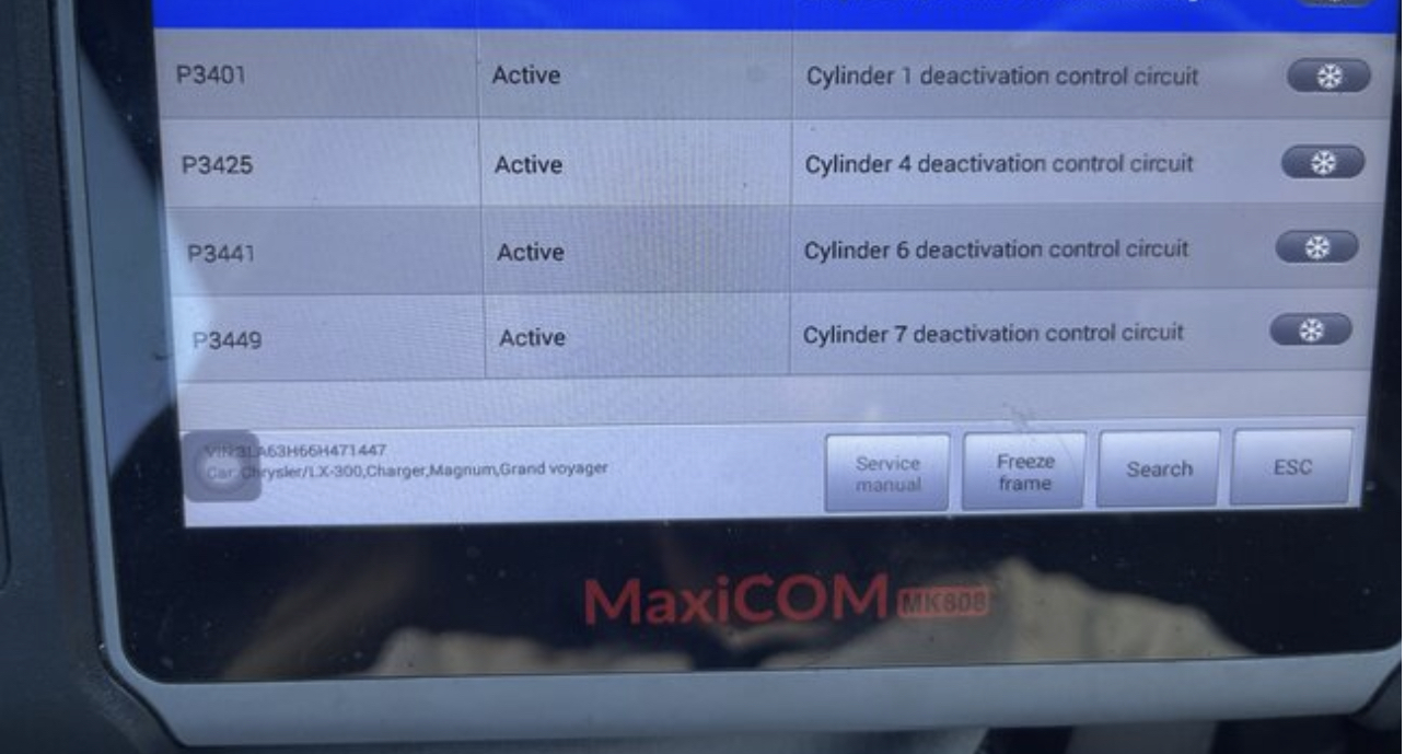

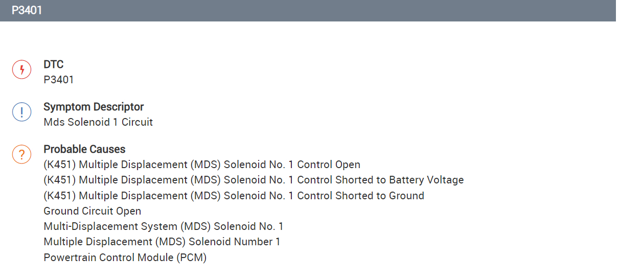

It's the same numbers every time, I delete them then they come back. Inactivation for 1, 4, 6 and 7 just like most people report.

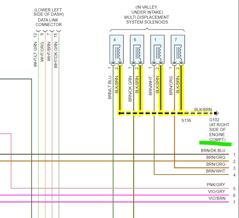

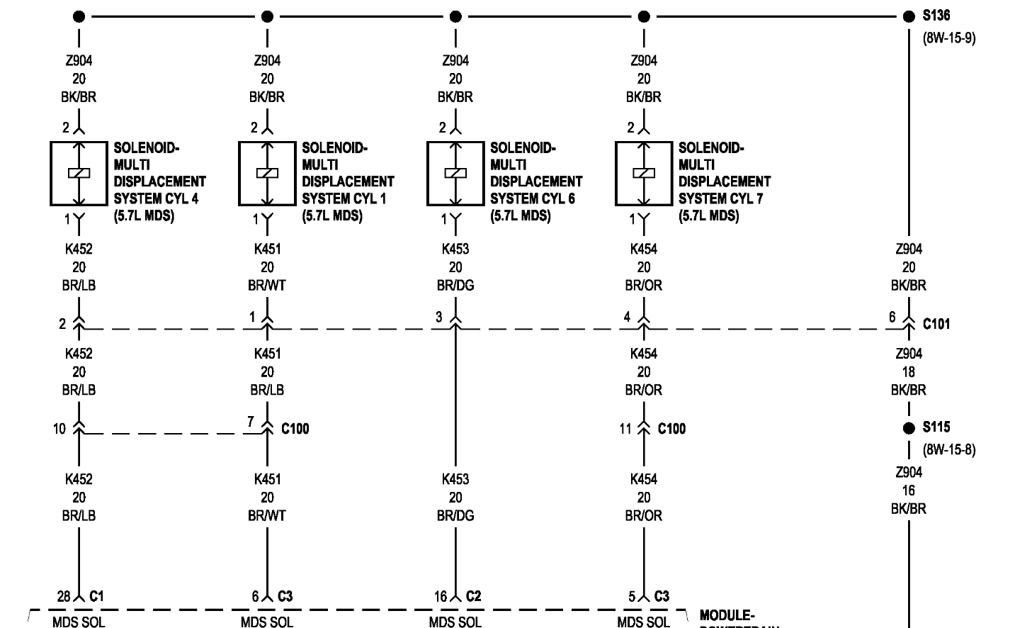

Hello, are you getting cylinder misfire codes with MDS codes? The multi displacement system has 4 solenoids under the intake manifold on this model, they are power side switched components, so the ECM provides power to activate the solenoids. So, the question is the engine running on 4 cylinders or are you just getting codes for MDS circuits? What exact code numbers are you getting? Since the solenoids are power fed on individual wires and share a ground, the ECM might be monitoring either current flow or voltage and running some self-test and not seeing what it's supposed to see. I'll post the wiring diagrams for the solenoids.
Since it sounds like you're having codes for all four cylinders, I would say most likely this is a Ground issue. It's unlikely that all four wires coming from the ECM are having an issue unless they share a connector which has a problem. If the vehicle is running okay on all eight cylinders, then it sounds like the system is failing some self-test of those circuits. I'm looking on the OEM diagrams to see if there are any shared connectors anywhere.

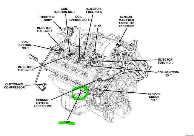

Okay, is this a v8 or straight8? So far on the OEM diagrams its only showing on the srt8 engine, but I'll keep looking. And it looks like all four control solenoid wires and the one ground all share a connector. Cylinder 4 and 1 also share a connector further down towards the ECM. But C101 has the five wires we need to check. And are the codes setting at just key on engine off? You said they come back right away,

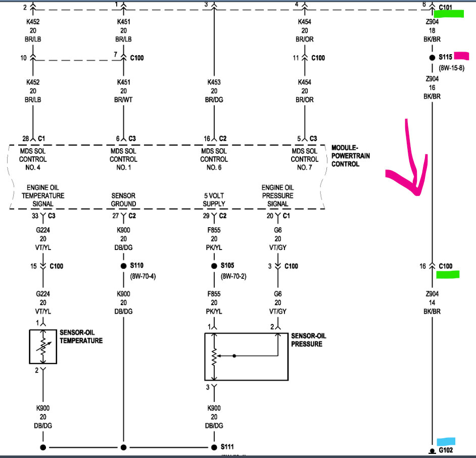

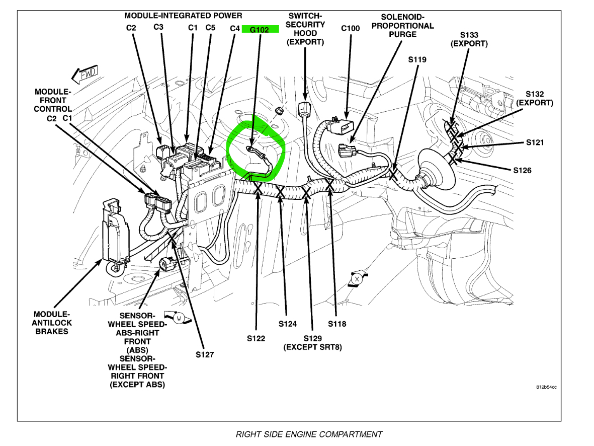

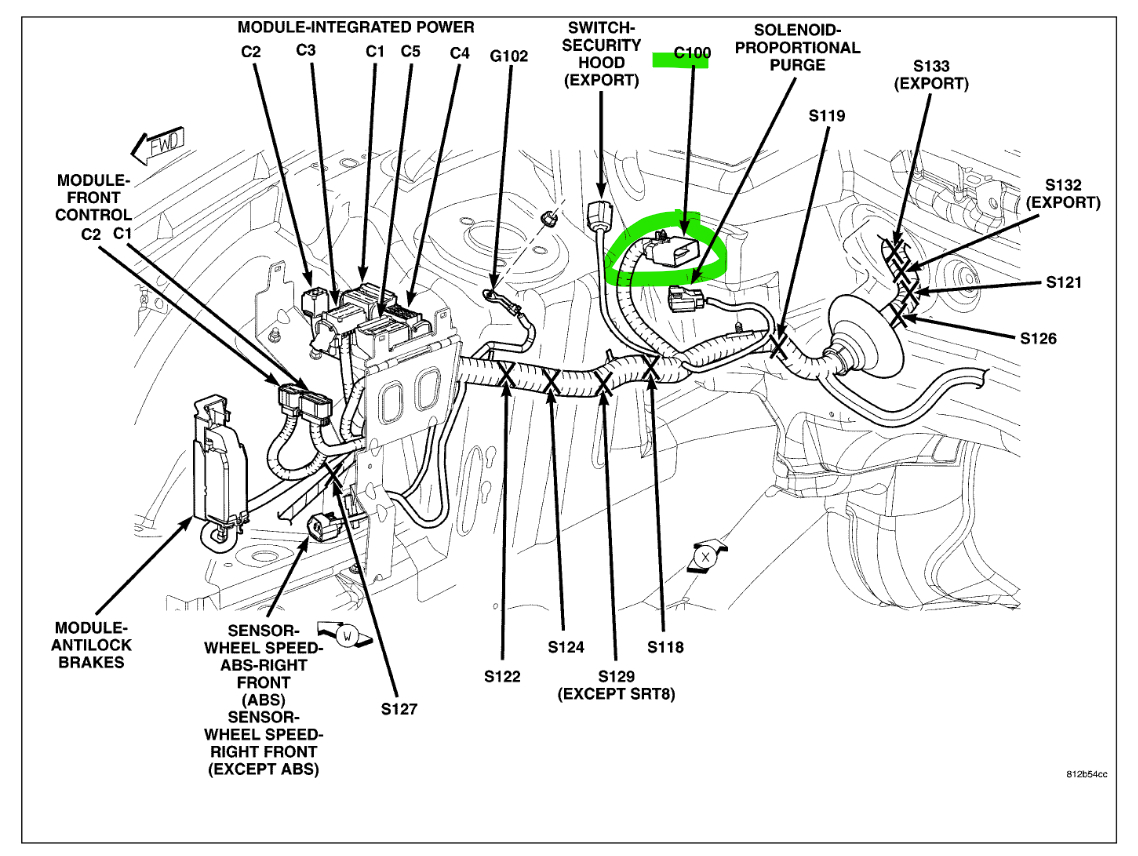

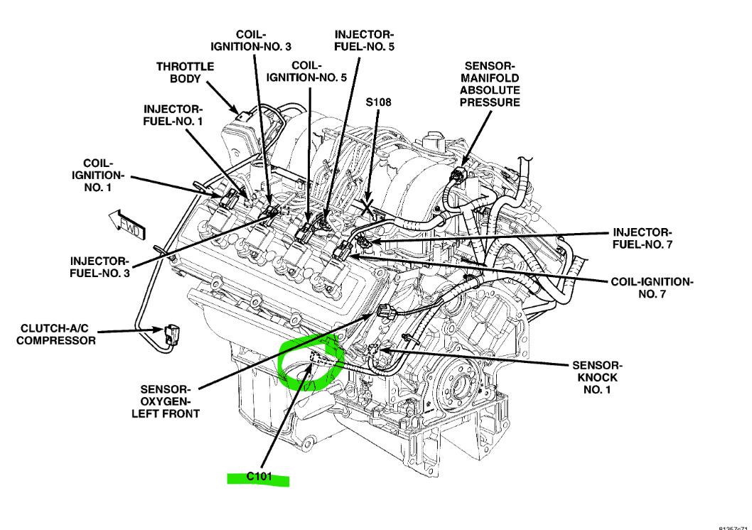

I think it's a wiring issue as well. I'm trying to locate this C101 connector. See if you can locate this ground G102 (third diagram). The c101 connector is just the five wires for the solenoids.

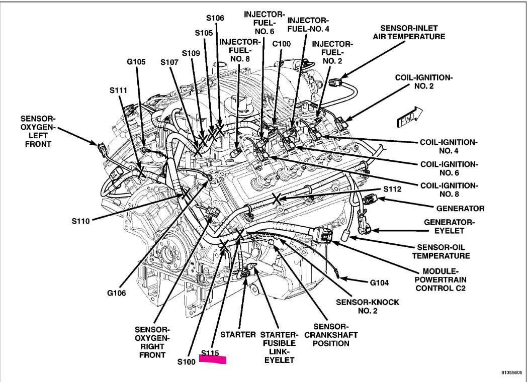

The fourth diagram is the OEM with the connectors and splices we need to be concerned with. S115 s136 and connector c101

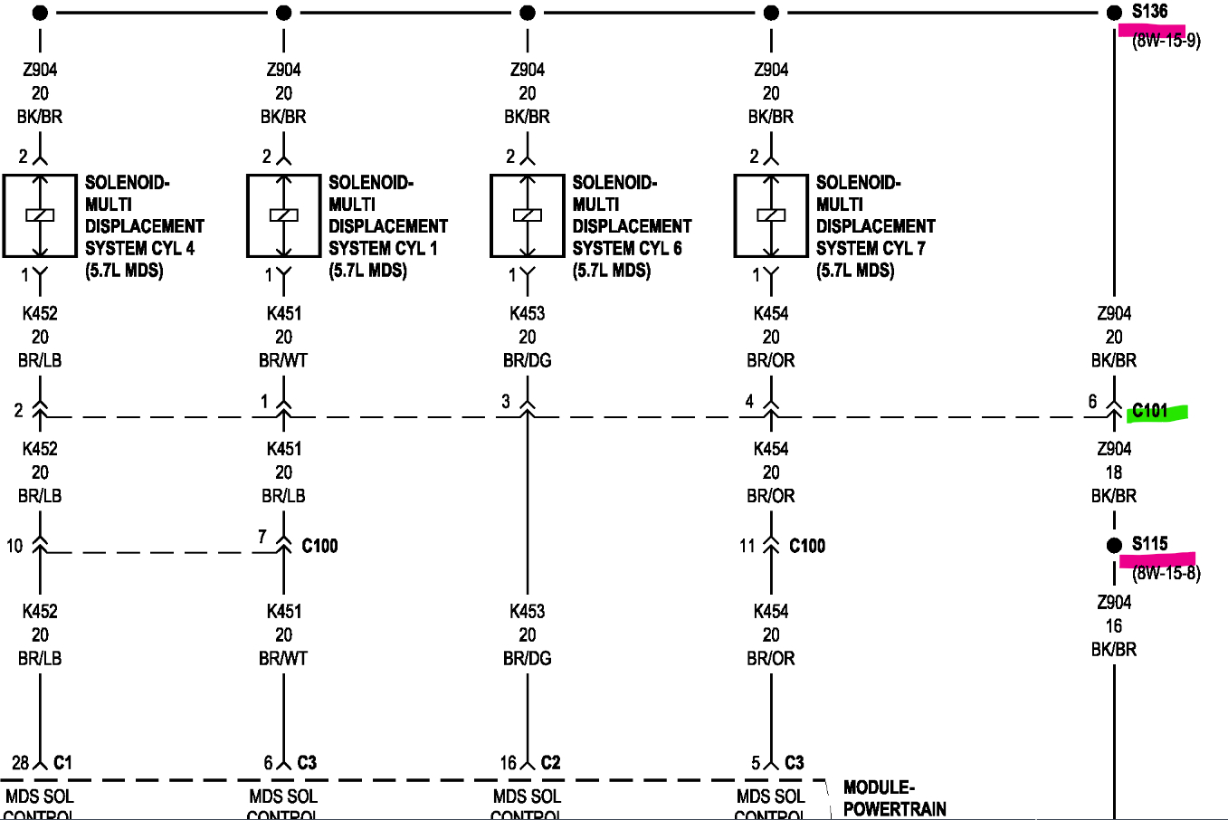

The fifth diagram shows s115 (splice) that's on the ground side, so anything on the ground side is of concern because it will cause all four solenoids or circuits to fail any self-tests.

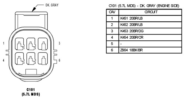

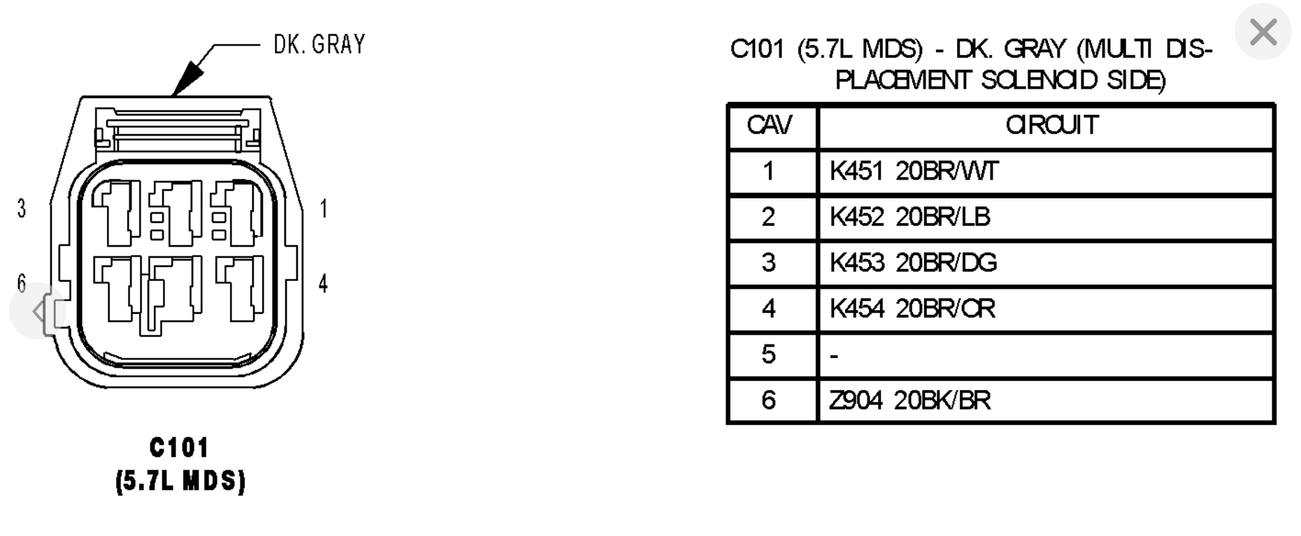

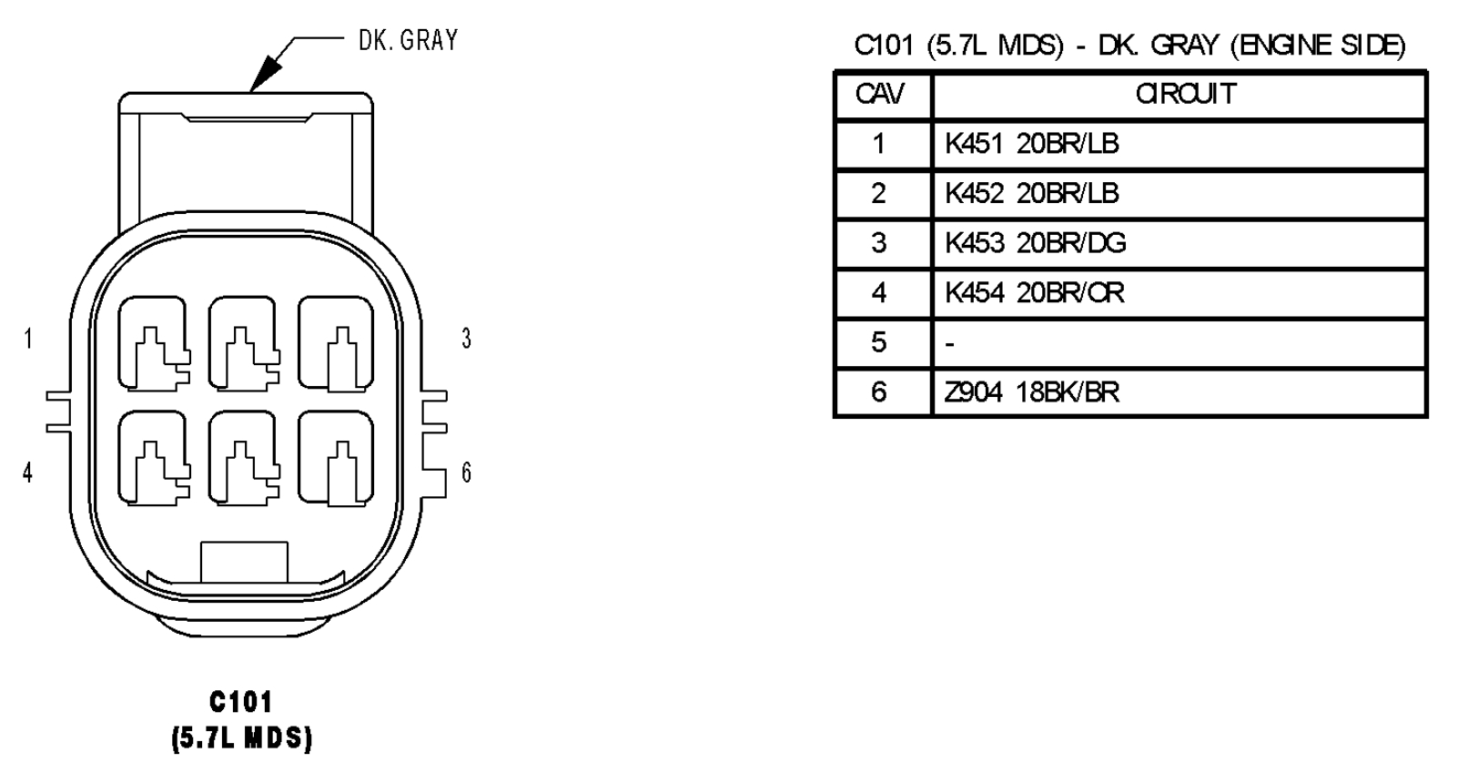

Ok the seventh diagram is c101 on the driver side rear of the engine, that's the connector with all five of the wires for the MDS solenoids. The Black wire with a Brown stripe is the ground. It should have continuity to ground even with the key off.
But after the c101 connector the wire runs to the c100 connector then finally to its ground location g102, they have it running through multiple connectors for some reason. But it's a black/brown wire the whole way.

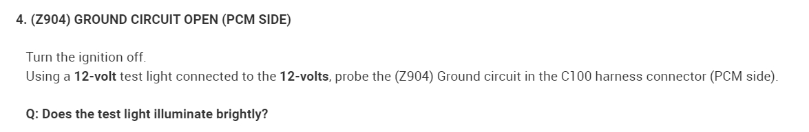

I know I keep adding things here, but the 10th diagram is a quick ground test at any of the connectors with a test light hooked to battery positive. Since this wire is always grounded it should light the test light with the key off.

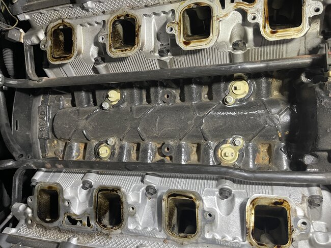

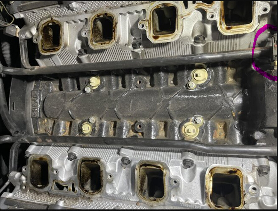

I just removed the intake, and I don't see any solenoids or harness.

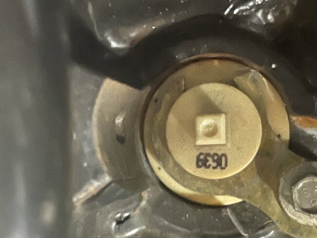

Were you able to find the c101 connector in the seventh diagram on the driver side rear of the engine with those five wires and colors? Usually, they are in that valley under the intake. What's this connector to the right in the picture, is that a 5-wire connector? This is the Ford OEM diagram for your vehicle, and the ECM is not going to throw codes out for a system it doesn't have. It's there, but I would concentrate on the wiring harness more than the solenoids. I don't think all four solenoids failed at once, a bad ground is really the only thing that would set all four circuit codes. Unless it's an ECM fault. Here are some possibilities, but this is only for one of the solenoids, so it can't be all of these causes.

I understand but there is no harness for MDS and none have any harness connected to them or a place to connect them. Have you seen the picture?
Saturday, October 22nd, 2022 AT 4:08 PM
BHAMDOC1973
  • 2,018 POSTS
No, that is a 1 wire connector.
Saturday, October 22nd, 2022 AT 4:09 PM
BHAMDOC1973
  • 2,018 POSTS
This all-look factory with no dirt or oil or harness or anything cut. Very strange.
Saturday, October 22nd, 2022 AT 4:11 PM
BHAMDOC1973
  • 2,018 POSTS
I know what it is now, it's a block off plug, they sell them on Amazon. Someone has just disconnected them I guess at some point, that is why the codes are not affecting the performance.
