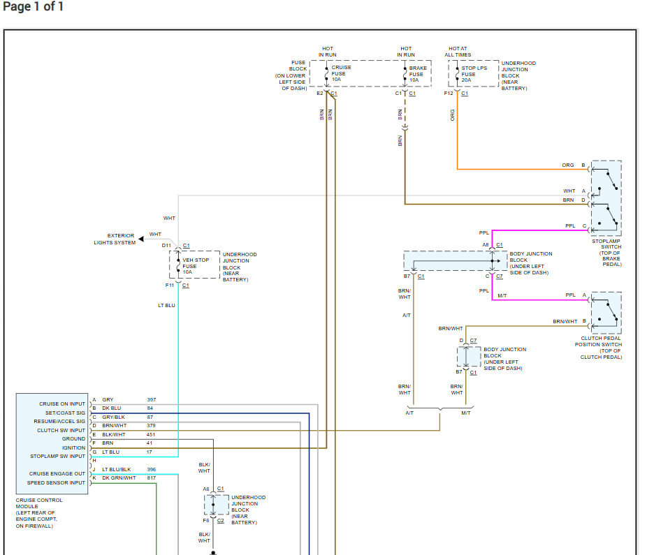

cruise control will not work at all, not even the indicator light. When I pulled the connector on the cruise control module and checked for voltage pin 'g' 'LT Blue' wire does not indicate voltage with or without brake pedal pushed.

The voltage from the ltblue wire come through the brake light switch as a separate circuit and two fuses, (STOP LPS and VEH STOP) both in the under hoor fuse panel, if both fuses are good, see if the ltblue wire has power when the brake light is pushed and if not I would replace the brake light switch. Here is the cruise control wiring diagrams so you can see how the system works. Check out the images (below). Let us know how it goes

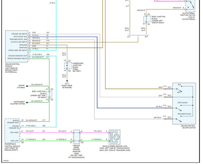

Thanks for the electrical schematic. If their was 2 pages I only got 1page. If not the bottom was cut off.

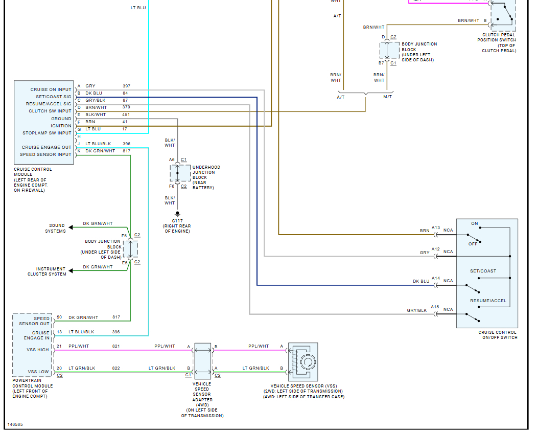

Sorry about that, here is the other half. Did you find where you were losing power to the module?

Just replaced the brake switch, no change at pin g on cc module. I'm taking tomorrow off. Have a great Thanksgiving

Sounds good, I would check the brown and ltblue wire for power at the CC module when the brake pedal is depressed. This can help eliminate this part of the system, have a good thanksgiving see you when you get back :)

Hey Ken, truck is fixed. $900 to repair Rat eaten wiring under the fuse panel in the engine compartment. Oh well live and learn. Thanks again for your help.
