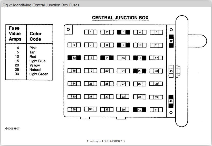

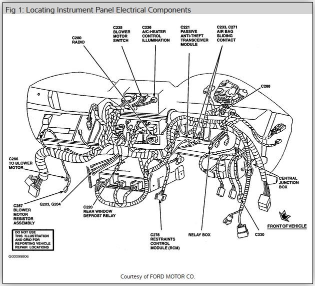

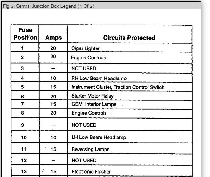

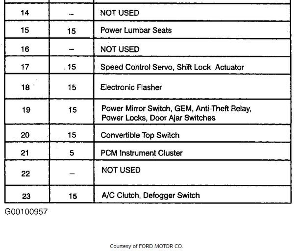

The cruise control does not work. I need to know exactly the location of fuse. Fuse cover missing.
Sunday, October 1st, 2017 AT 11:39 AM
HARRY P
MECHANIC
2,295 POSTS
This should do it. Look at #17.
