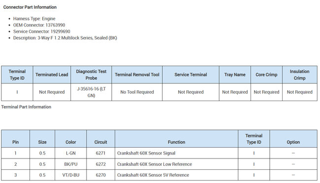

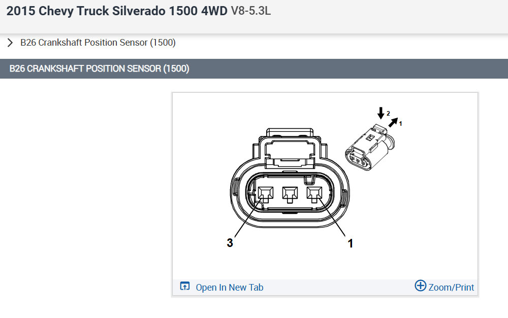

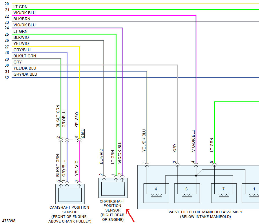

Have one wire is connected to the connector (purple with blue) but two of them came off which is one green and the other one black with purple where do they go?

Sure, here is the crankshaft position wiring diagrams and connector views so you can get the wiring repaired correctly, check out the images (below). Let us know if you need anything else.

Okay, thank you! Just one more thing, on my connector is 123 so the black with purple would be in middle and the green on the side is that fine?

The green wire is one the right side of the connector as you look at it with the safety clip on top.
