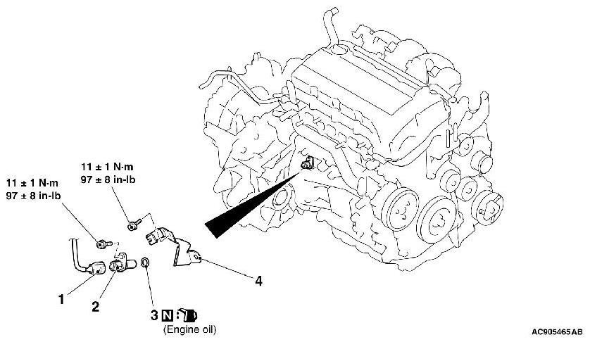

I need to locate the crankshaft sensor on my kb4t 2014 l200 engine.
Any diagrams would be much appreciated..

In the US, this vehicle isn't offered. Also, I just ran through all the Mitsubishi trucks offered here and they all have 2.0L engines. I attached a picture of that engine and the crankshaft position sensor's location just in case you accidentally typed the wrong engine size.
Let me know if this helps.
