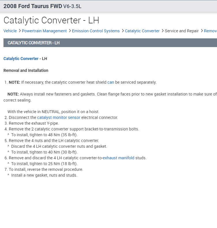

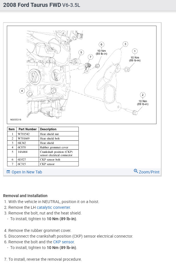

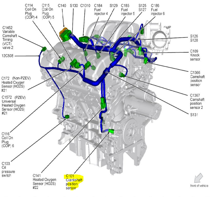

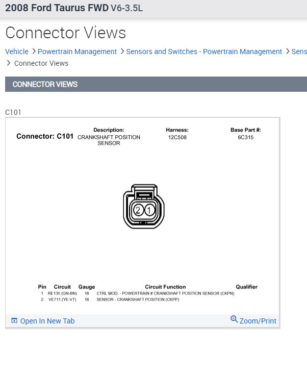

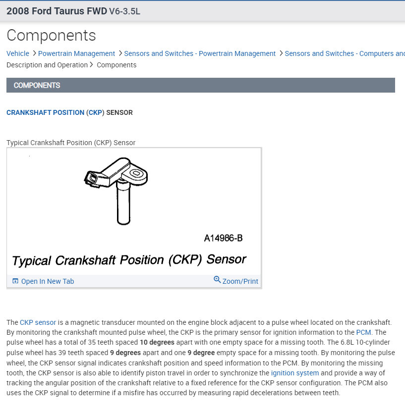

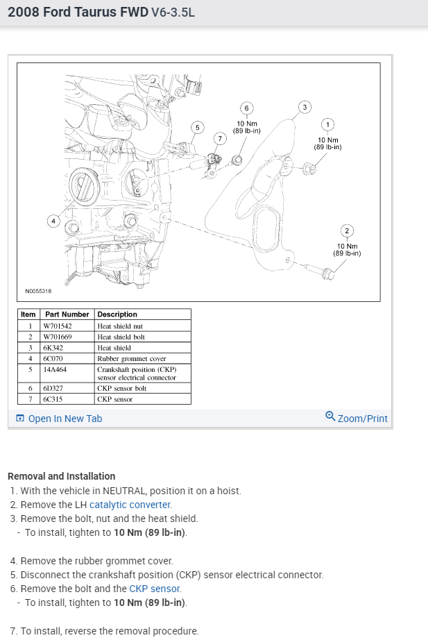

I need help locating a crankshaft sensor.
Wednesday, June 1st, 2022 AT 5:56 PM
SQM
MECHANIC
6,383 POSTS
The crankshaft position sensor is located on the lower left-hand side of the engine.
In order to replace the sensor, you will first have to remove the left-hand side catalytic converter.
I have attached diagrams below for your reference.
Let me know of any questions.
