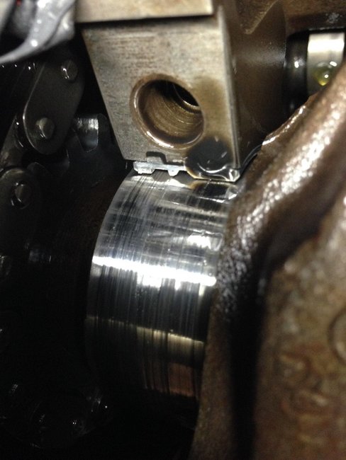

Had the front crankshaft seal replaced by a mechanic. Because I was away when the job was done, the mechanic dropped the car off at my garage. When I first started the car, it seemed to run rough and had a different sound. I immediately went back to the shop and the mechanic agreed that it shouldn't be driven. Several days later the mechanic told me that the car was all set, I arrived at the shop, started the car and it was still running rough. I again left the vehicle at the shop and several days later he showed me a damaged crankshaft. Could a crankshaft go bad as a result of a bad seal replacement? Car ran great prior to the seal replacement.

He showed me a photo of the crankshaft scored/scraped and now there is metal particles in the oil pan.

See 4 photos attached.
Oct 30, 2019 at 10:42 AM
There is only one picture.
That bearing is junk and most likely the crank is damaged.
I would love to know why this happened.
Is that the only bearing that is damaged?

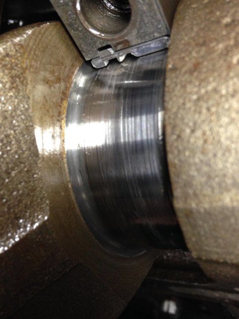

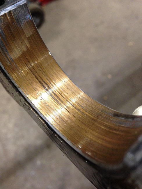

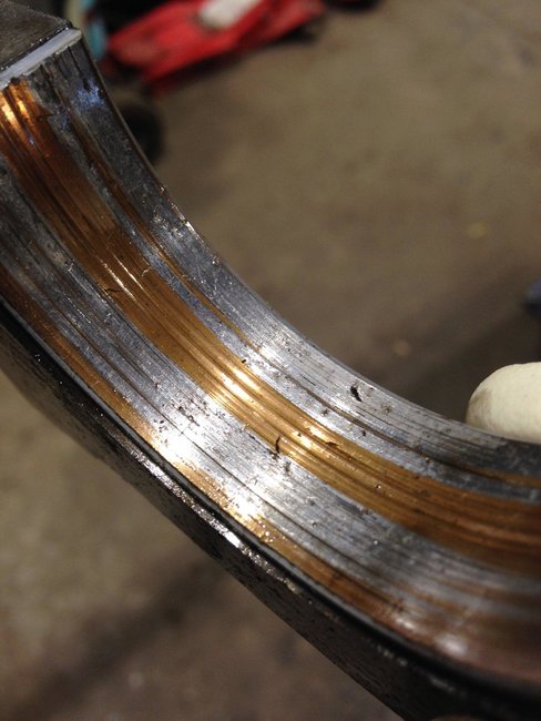

Other bearings are damaged, see other photos. I also would like to know why it happen.

Did you see the other photos ?
Oct 30, 2019 at 1:07 PM
Wow. The crank is wiped out.
Was there any issue prior to this failure?

The car ran great prior to this failure. Now the mechanic is thinking that the oil pump was the factor?
Oct 30, 2019 at 1:16 PM
No, not at all. You are at the point of removing the engine for a complete overhaul.

My gut thought is that the engine was run with no oil after the repair.
Oct 30, 2019 at 2:02 PM
CARLOS MELO
  • 11 POSTS
How do I prove that ?
Oct 30, 2019 at 2:05 PM
You cannot unless someone there tells you. I doubt they will own up to it.
You are in a rock and hard place.
Oct 30, 2019 at 2:15 PM
CARLOS MELO
  • 11 POSTS
Indeed I am. Running without oil is the only thing that makes sense.
