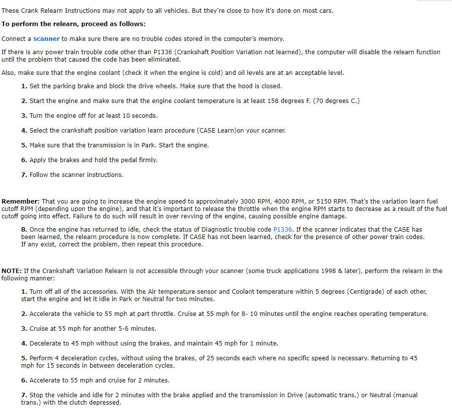

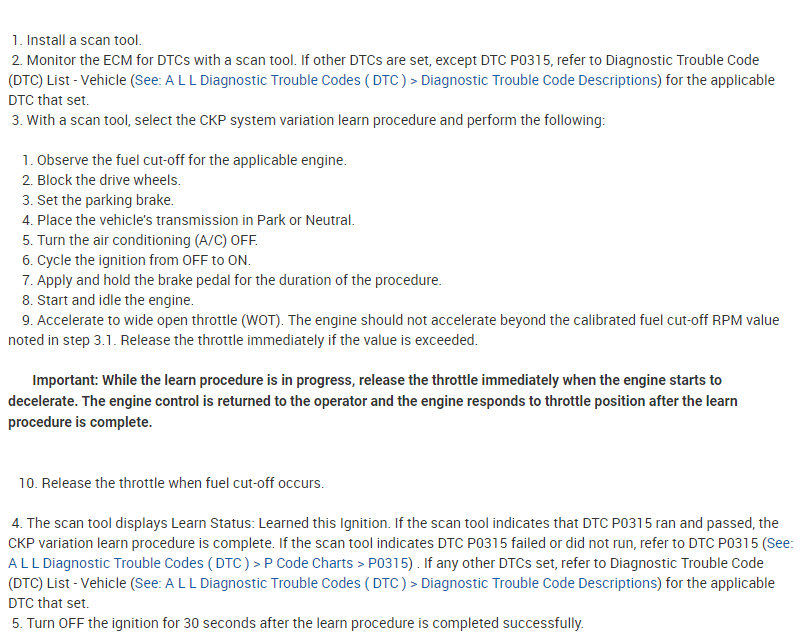

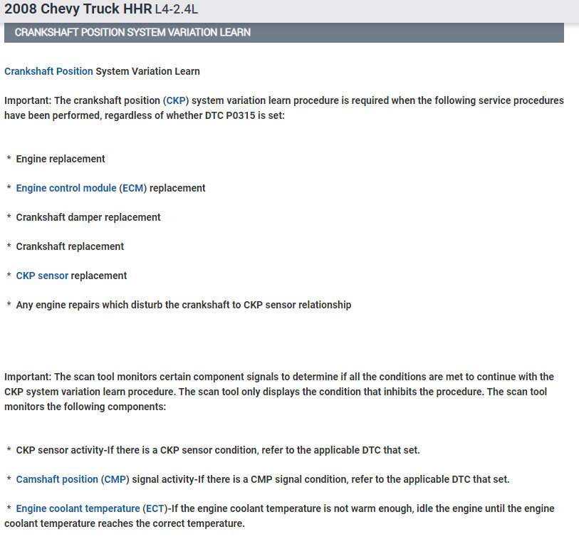

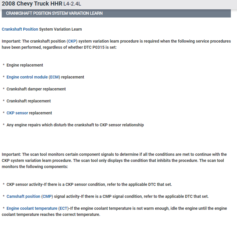

Replaced CKP sensor now need to do the relearn do not have access to scanner and mechanic could not get it until next week.

Unfortunately this will need the scan tool in order to complete the relearn.
However I have attached a generic relearn that might work on your HHR. It is the third image.
Let me know if you have any questions.
