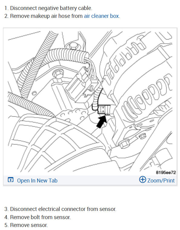

Where is the Crankshaft position sensor located?
2008 CHRYSLER PACIFICA
169 MILES • 4.0L • 6 CYL • 4WD • AUTOMATIC
KATELYN MARIE KLUSAW
Cankshaft position sensor locatation.
Nov 2, 2024 at 3:11 PM
  • 54,520 POSTS

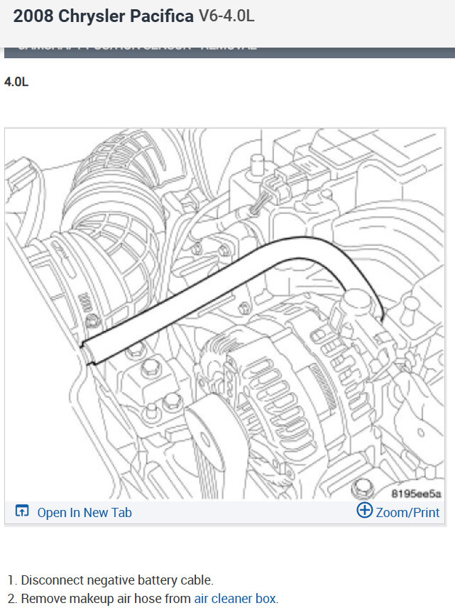

Sure here is the camshaft location, but if you are chasing code the sensor might not fix it. It could be the timing chain needs to be replaced. Here is the location as requested, it looks like it is under the alternator. Check out the images (below). Please let us know what happens.
