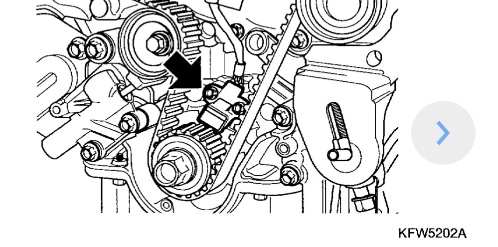

I need to know exactly how to replace the crankshaft position sensor
Nov 9, 2025 at 12:00 AM
KRAKENAUTO
  • 40 POSTS
It is located in the timing belt area. Under the cover, positioned near the bottom crank pulley.
Remove all the belts, lower crankshaft pulley, upper timing covers, lower timing covers. Motor mount removal may be required. And once the lower timing covers are removed, the crank position sensor is easily accessed through the fender well.
