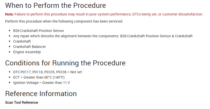

Where can I find the crankshaft position sensor on the car listed above with an ecotech engine?
Apr 7, 2025 at 2:26 PM
  • CAR REPAIR CONTRIBUTOR
  • 110,193 POSTS

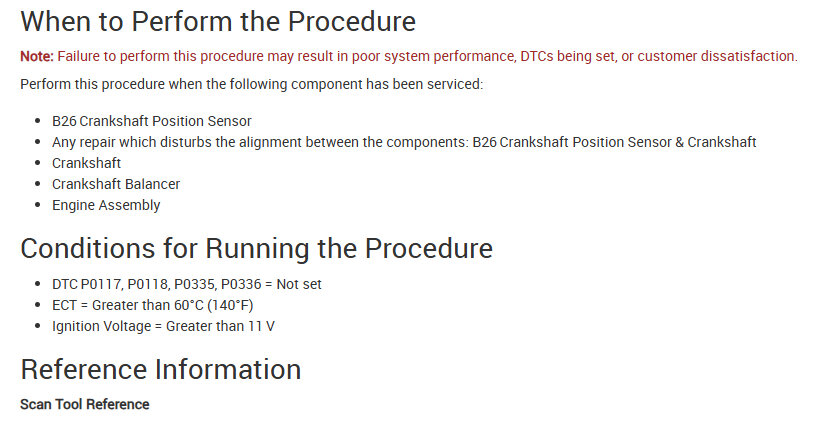

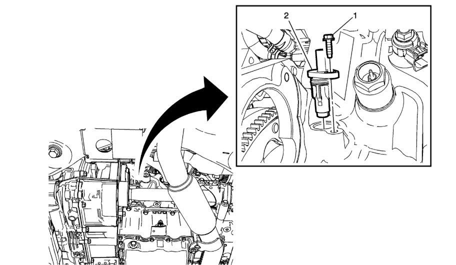

The sensor is located at the rear of the engine and on the top of the transmission bell housing.

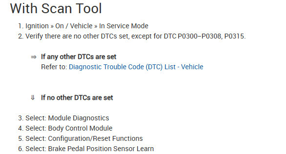

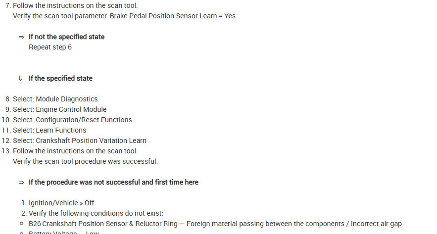

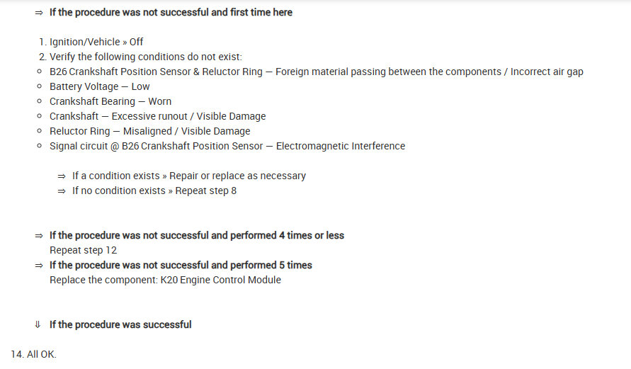

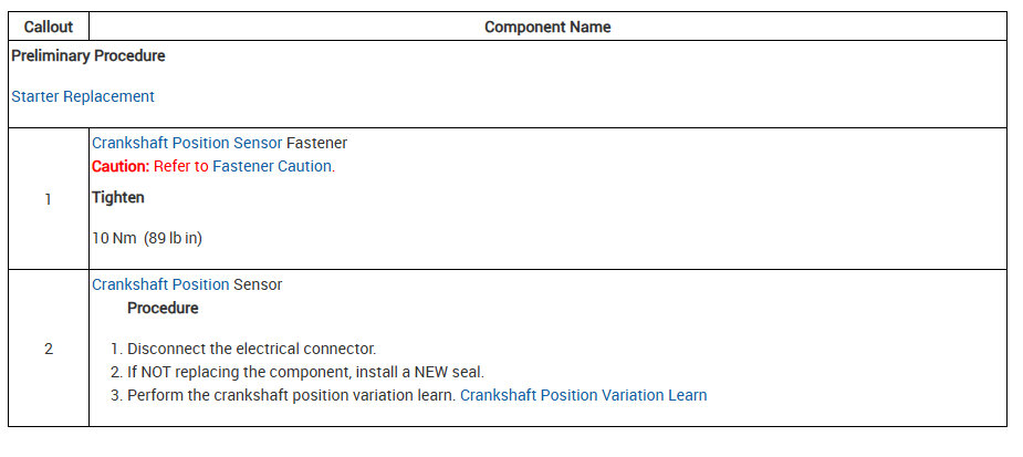

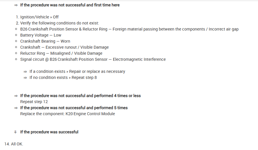

I attached a pic below that shows its location. Pic two are directions for replacing it. The last pics are the relearn procedures (simple to do but requires a scan tool).
I hope this helps.
