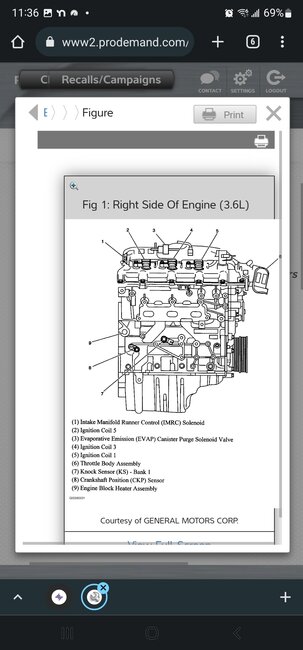

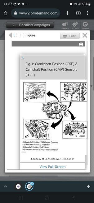

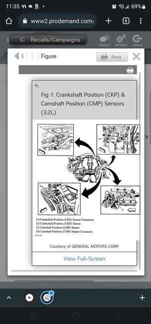

I need to know the location of the crankshaft position sensor. There is no info on the internet about the location of this sensor. Hopefully you can help me with this.

I put all three scenarios for you since you didn't list the engine size. Let me know if you need any more assistance.
Thank you,
Louie
