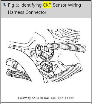

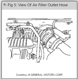

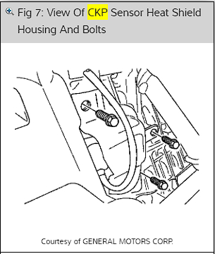

Where is the Crankshaft Position Sensor located?
140,000 MILES • 2.5L • 6 CYL • 2WD • AUTOMATIC
SJOERD

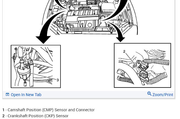

I can't find the location of the Crankshaft Position Sensor. The vehicle listed above is a petrol vehicle (the LF4 engine I believe). The car is also known as the Chevrolet Evanda or Daewoo Tosca.
Does anyone have a picture or drawing of the location?

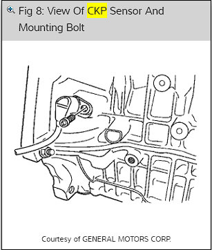

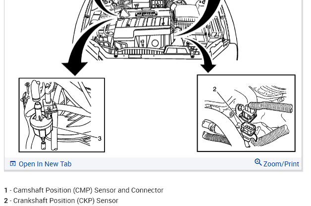

It looks like the sensor is in the transaxle bellhousing, toward the front of the vehicle. Sorry, the images I have are very basic.
According to the shop manual:
1. Disconnect the negative battery cable.

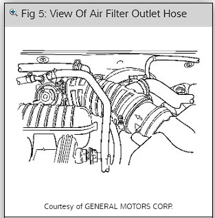

2. Remove the air cleaner outlet hose.

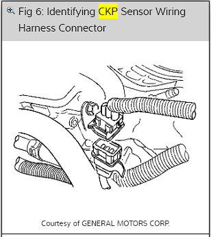

3. Disconnect the CKP sensor wiring harness connector.

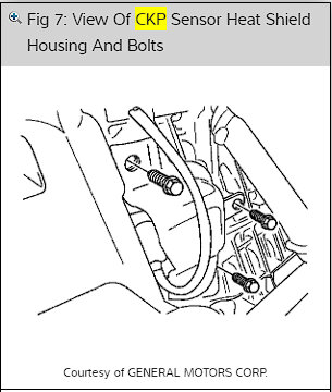

4. Remove the CKP sensor heat shield
5. Remove CKP sensor.
CKP sensor bolt torque is 62 lb. in.
Heat shield bolt torque is 71 lb. in.
I hope this helps. Have a good day.
