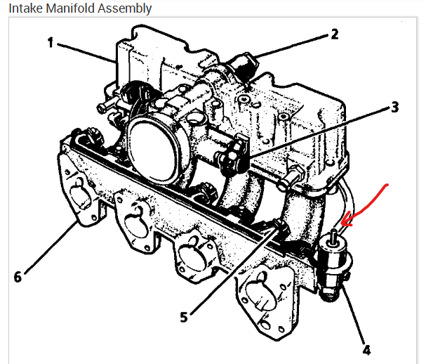

It sounds like the fuel pressure regulator needs to be replaced, I would remove the vacuum line from the regulator to see if raw gas is present and if so the part is bad. Here is a guide to help as well which shows the most popular causes of hard starting.
https://www.2carpros.com/articles/engine-cranks-excessively-before-starting
Here is the location of the fuel pressure regulator so you can check it out. Check out the images (below). Please upload pictures or videos in your response

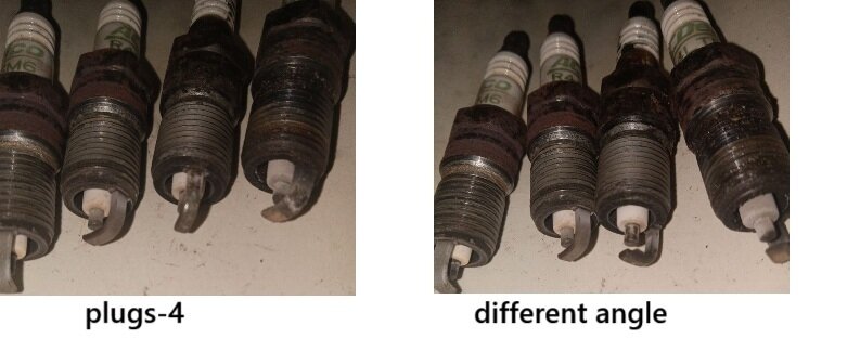

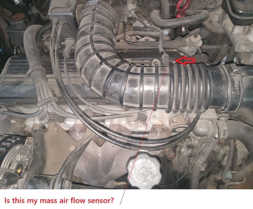

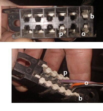

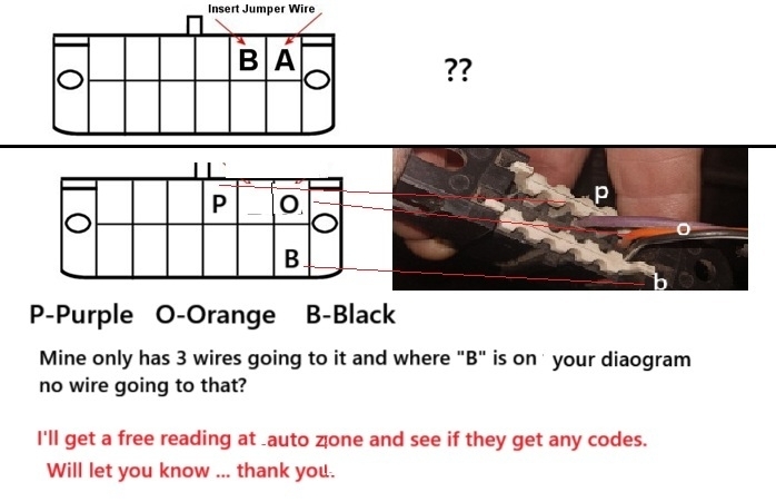

Could not get any codes. Mine looks different than the picture you sent. No matter how I hooked them together I got no codes to read by flashing engine light. I also tried disconnecting, I think it was the MAS and it started up better. And here is a pic of plugs I replaced. I will try fuel regulator next and see if there is any gas coming out but i do not see or smell it so far.

The sensor in the second image is the air intake temperature sensor. The spark plug looks lean, have you changed the fuel filter lately?
Here is the correct way to run the codes:
https://www.2carpros.com/articles/buick-cadillac-chevy-gmc-oldsmobile-pontiac-gm-1983-1995-obd1-code-definitions-and-retrieval-method
This car has a MAP sensor not a MAF sensor FYI. Please go over this guide and get back to us.

I was thinking filter to. I will put a new one in.I am hoping it's not pump because as you know that's in the gas tank. As far as codes go i'll see about it Monday because I can't get anything using jumper. Will let you know...thank you
