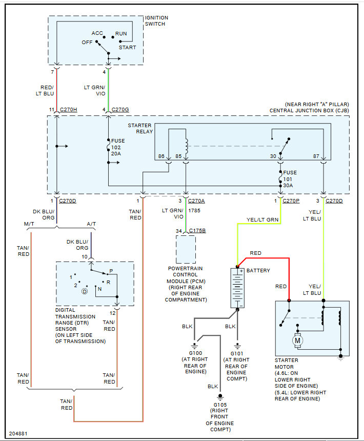

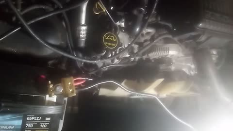

bought with no starter. got starter - wiring all messed up. rewired both batteries, starter, alternator. still not turning over. changed relays and fuses, no change. changed coils and spark plugs, still no change. had one battery... got second - cranks a few times, no start. fuel pump engages. fuel filter, unsure... we think that maybe we dont have the starter, alternator and batteries connected in the correct order.
we cant find a definite wiring diagram online and Chiltons has us confused on locations!

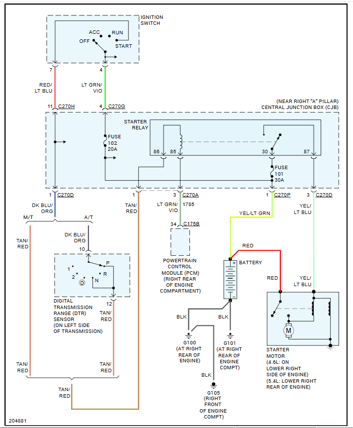

No problem, I can help you fix it. So to be clear the engine is cranking over (starter) or the engine is cranking over but not starting, please upload a video it will help us. It is probably a 5.4 liter engine btw. I could be the starter relay is not working but here are the wiring diagrams so you can double check the repairs to the starter harness. Also, please go over this video as well

Ok... This was a couple of days ago... We've since burned out the starter, and replaced it. The truck started with the new starter, we tried to drive it down the street, it stalled, wouldn't start again, killed the battery... We are just gonna leave it there for the night...
We will try again tomorrow... We appreciate any and all advice!

It looks like you don't have a serpentine belt on the engine correct? if so do not drive the truck anymore until the belt is replaced. This will cause the engine to over heat and the battery not to charge. Thanks for the video it helps.
