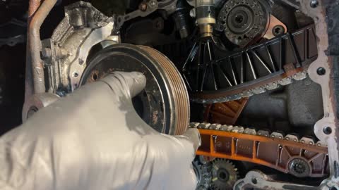

Posted this question before but I cannot find it. One cold day tried to start it it made a noise and died, then kept trying but didn't start, sounded like starter is bad or no compression. Left for another day, floored it and tried took forever but started, would idle fine without misfire but if u take your foot off would die. No codes at all. Pulled camshaft cover, and I am seeing the chain is not lined up based on what I know, also, the tensioner I believe is way out unless am mistaken, need your input on it. Only 94k and a chain stretch? Maybe, not sure. No codes no matter what. Took off intake and HPFP in case its stuck, compression was all 30psi across before I took everything off. Does not make sense, something happened all of. Sudden, don't know If it bent valves or just jumped time, can't see any indications from intake holes.

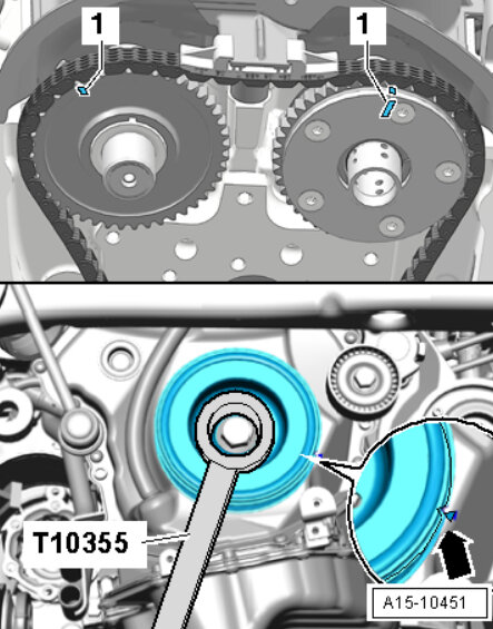

The timing chain looks good so I don't think it jumped, I have seen the wrong weight engine oil hold the lifters up and cause this issue. Did the engine oil get changed recently? Here are the timing marks if you want to double check them. Let me know if the marks are on or not. The chain marks may not line up, just check the marks on the balancer and camshaft gears. Check out the images (below). Please let us know what happens.

I have not changed the oil. It looks black. Ill check the marks again but I know they are off

Okay, I don't know if the crankshaft timing chain gear has a keyway so it may have slipped. So if the marks are on check the #1 piston to see if it is at the top of the cylinder bore.

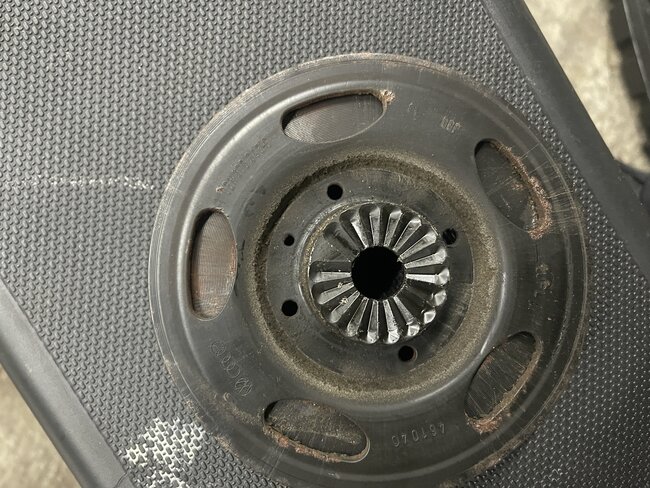

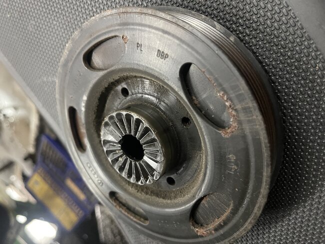

Sorry, I meant for the timing chain drive gear on the crankshaft. Thanks for the images. Like I say the engine oil can be causing this be not allowing the lifters to adject correctly. They will hold the valves open. Is it 30 psi across all cylinders?

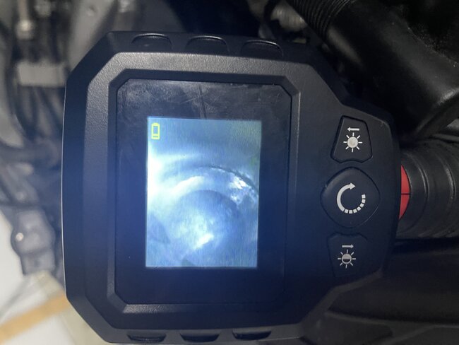

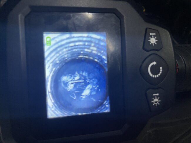

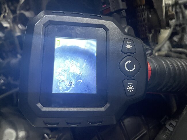

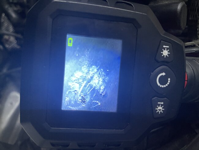

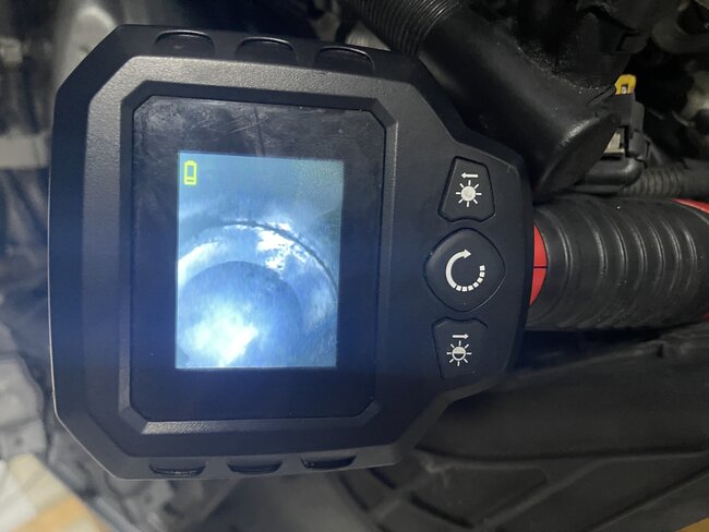

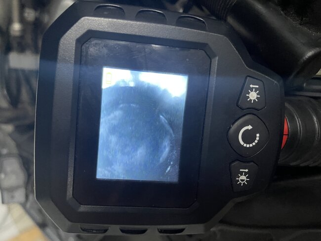

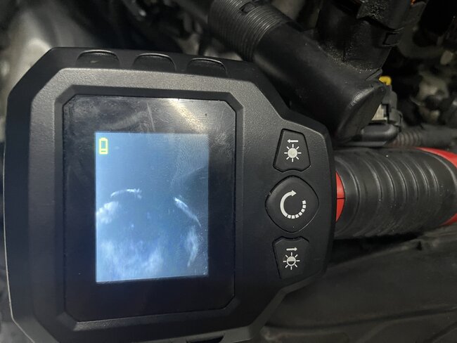

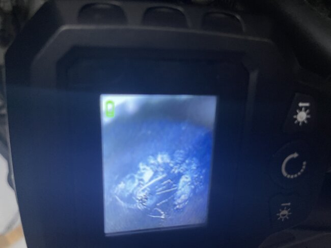

Ya sorry I had an issue with one of the accounts so I tried the other account. Here are some pictures of the top of cylinders, not sure if you can see any marks at all for the valves. Only thing is that the first cylinder has some scratches from the screwdriver I installed IT to make sure its on TDC.

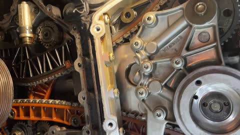

I son't know this happened, even with the tensioner still on but all the way cant believe it has stretched this much? I dont see anything broken or any gears stripped on the driveshaft gear itself.

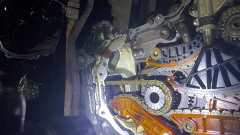

And here

WOW, that is a worn out chain or the tensioner is not working, good find. I would replace the timing chain kit which should come with a new tensioner and guides, replace them all. Was the engine making noise at idle? It should have been lol. I would try to do a leak down test to make sure none of the valve got bent. Ken

There was no noise except for that one time when it started and died. Thing is I dont want to put more money in a chain kit to find out engine is done, but then engines are not cheap. Leak down test only requires the tool correct? Intake manifold, vac pump and HPFP need to be put back?

Correct, the leak down tester you can rent form Autozone for free and it takes no tools which you can leave the engine as is to do the test.
