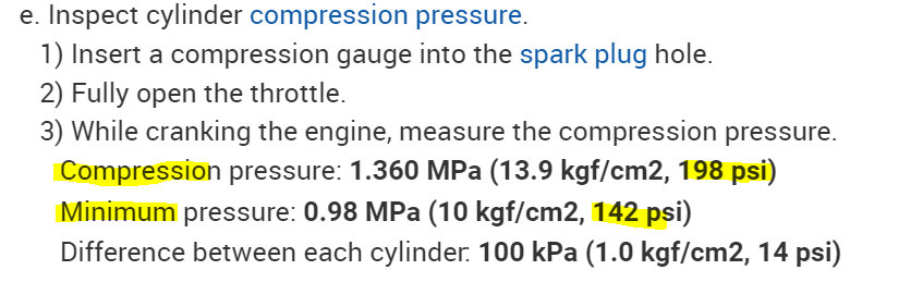

The compression is too low. If everything was checked and good, my first suspect is the timing is off.
If you look at the pic below, it shows the manufacturer's specs for compression. The minimum is 142 PSI, and you are well below that.
Try testing compression wet. Add about a tablespoon of motor oil into the cylinder through the spark plug hole and see if the pressure goes up a good bit.
Let me know what you find.
See pic below.

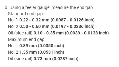

If the valves are good and it holds the compression it produces, the only other things would be a bad head gasket or the rings. Did you check the end gap on the rings? I remember you had the block machined and bored. Did you get the correct oversized rings?

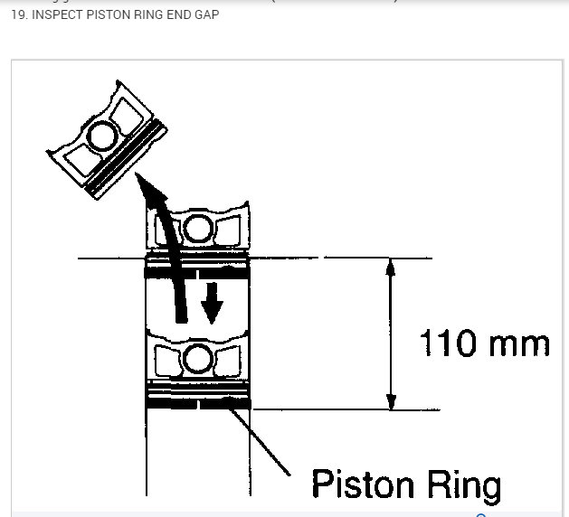

That is where the problem likely is. Did you install new rings? How much did you take out with the hone?

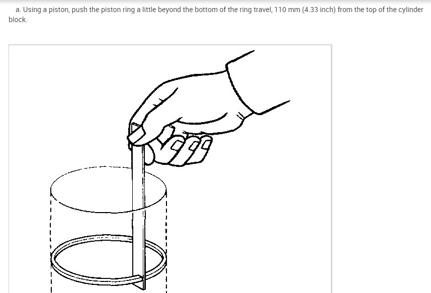

I attached directions for checking the end gap on piston rings. I have a feeling the cylinders are worn and the rings and that's why it isn't building compression the way it should.
When you said it was bored, I figured there were new pistons and rings as well. And no, you can't replace the cylinder walls. If you could, it would be more expensive than buying an engine. You can bore them to a point and use oversized pistons and rings, but it isn't worth the effort.
Take a look at the attached and let me know your thoughts.

Just for clarity, I replaced all the pistons and the rings with the standard size.
I think you're right; the rings gap may have been slightly on the higher side of the scale causing the low compression I'm getting.
