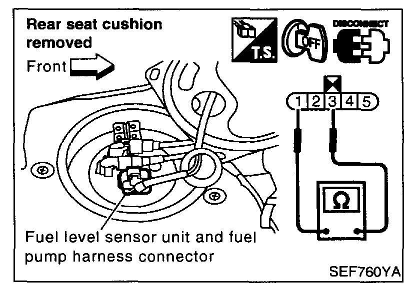

Has spark at plugs, but no fuel going to fuel rail. I pulled fuel pump, pump spin on bench?

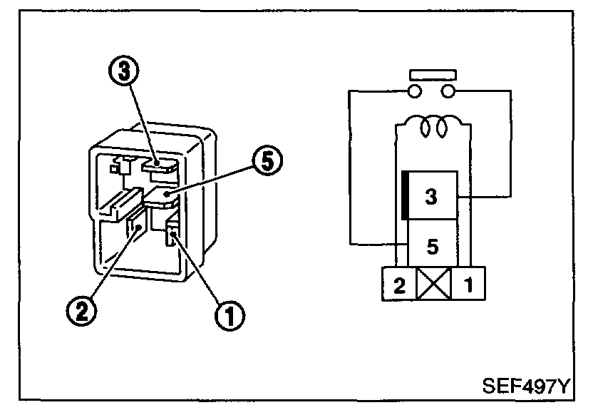

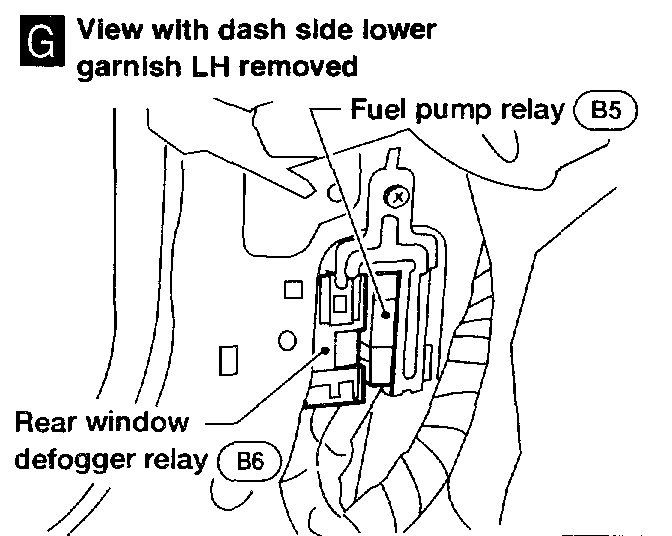

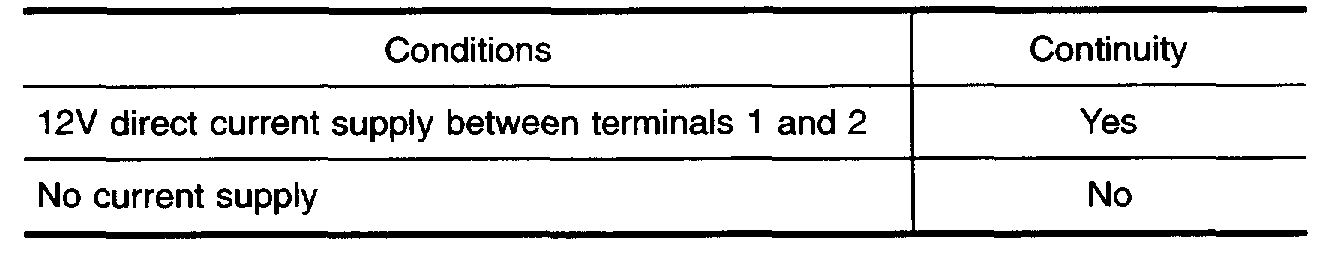

If there is no power, check the fuel pump relay located in relay box in the vehicle Here are the directions for testing the relay. The pictures attached correlate with these directions. The directions are straight forward.
__________________________
FUEL PUMP RELAY
Check continuity between terminals 3 and 5.
If NG, replace relay.

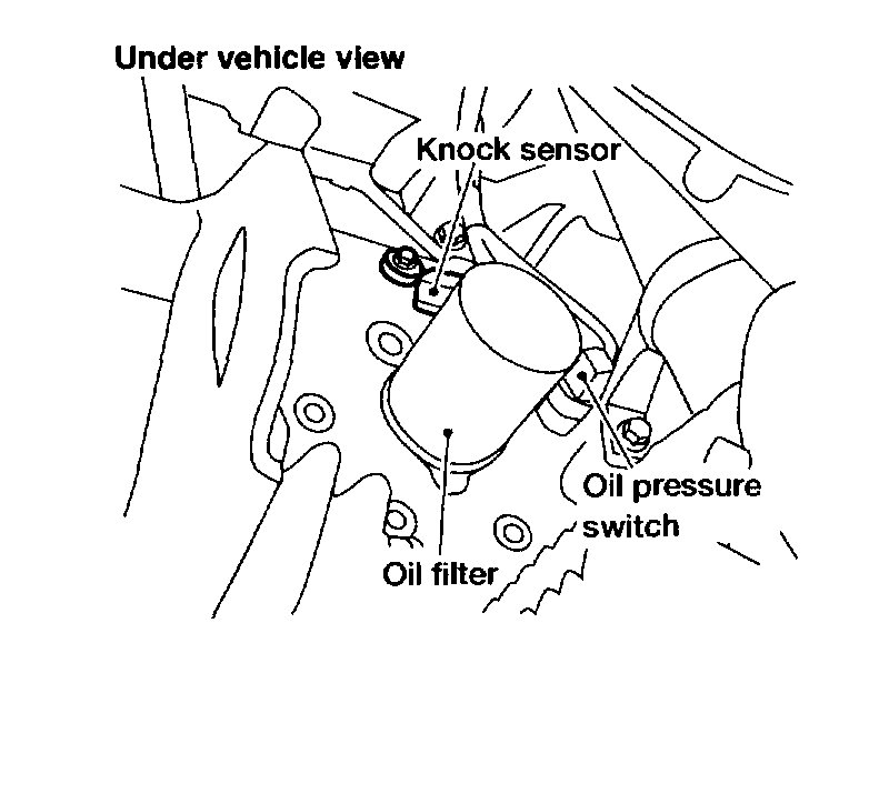

Next, the oil pressure switch can shut down power to the relay. I've attached a picture of its location. Make sure the connection is good, clean, and tight. I also attached a picture of the fuel pump relay's location (pic 4).

The last picture correlates with these directions. It's to check the pump. Make sure it meets the specs listed.
FUEL PUMP
1. Disconnect fuel pump harness connector.
2. Check resistance between terminals 1 and 3.
Resistance: 0.2 - 5.0 Ohms [at 25 °C (77 °F)]
If NG, replace fuel pump.
