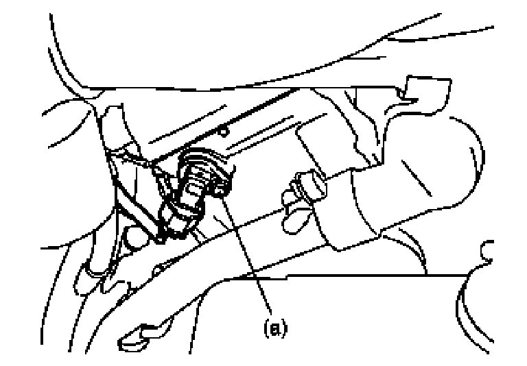

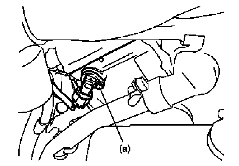

Are you getting spark and fuel to the engine? And I agree, this has nothing to do with timing. However, if timing has jumped a couple teeth, it can cause damage and this is an interference engine.
I note that you are a mechanic. With that in mind, check for spark and fuel to the engine. I will note that the cam sensor is mounted on the timing belt cover, so make sure wiring hasn't been damaged. The crank sensor is on the transmission, so that isn't an issue.
If you have spark, fuel, and an injector pulse, then I would be checking engine compression. If you have all of them, it should run. One is the problem. I attached a picture of the cam sensor location. Also, make sure when the belt broke that no wiring was damaged or disconnected. If it was jumping around hitting things, it could have damaged grounds or anything.
