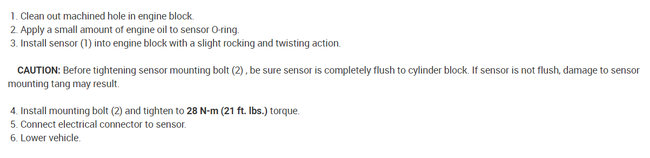

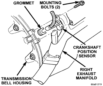

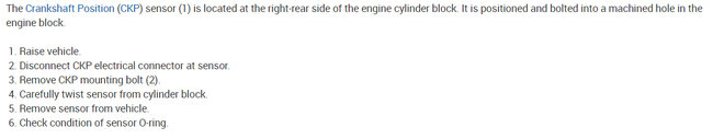

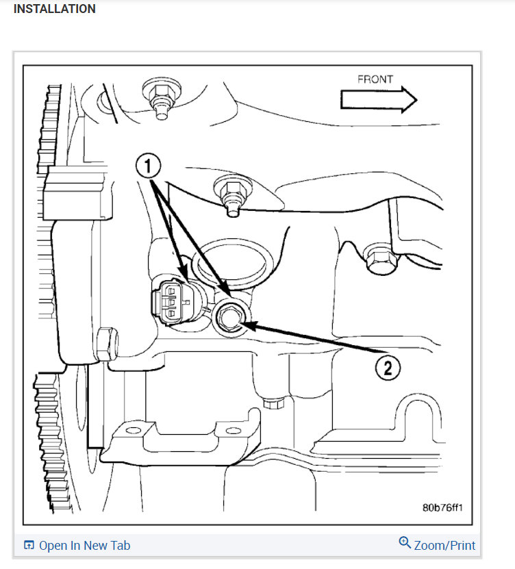

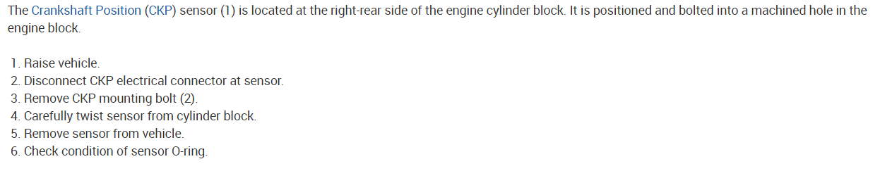

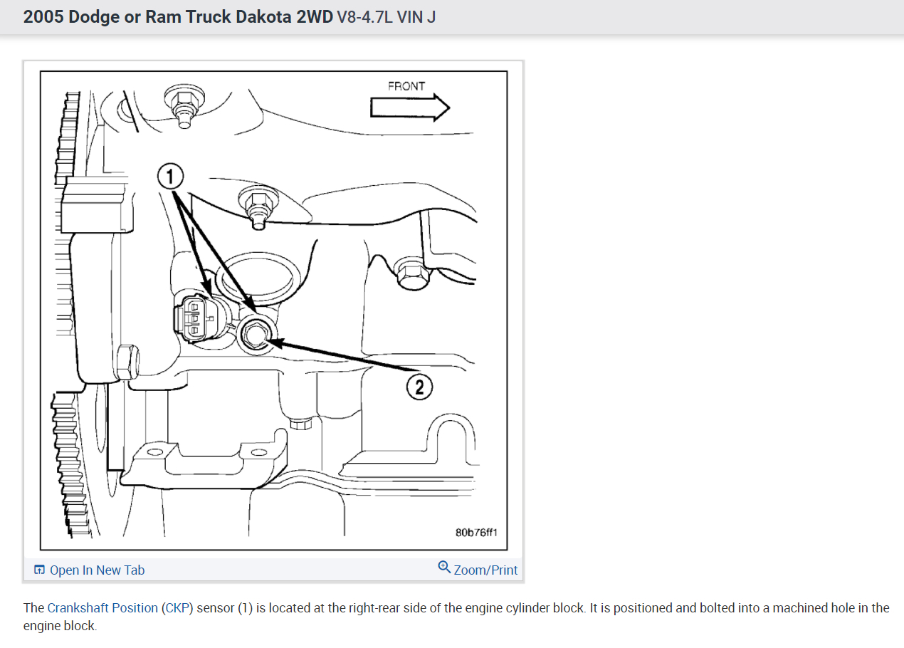

You could have a bad sensor however, if you have not learned the CKP sensor then that will cause the type of issues you are getting. When replacing the sensor the PCM needs to learn the new sensor so it can locate the windows of the tone wheel.
You need a scan tool to do this but before we do that try to do what is called a TLC relearn. That means go to a safe location and accelerate up to 65 MPH and then decelerate down to under 40 MPH with no brake or accelerator input. Do this 4 times in a row and it will force a relearn procedure. This may cause the PCM to relearn the crank as well. If this doesn't work then we will need to have a scan tool and perform a crank relearn procedure. That should correct the concern. Here is a guide to help you step by step with instructions in the diagrams below to show you how on your car.
Check out the diagrams (Below). Please let us know if you need anything else to get the problem fixed. Thanks

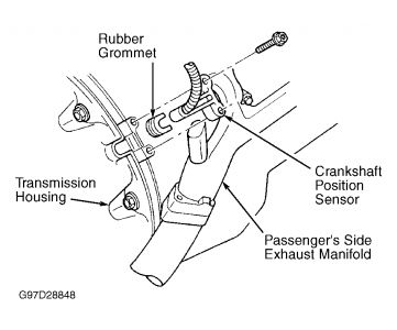

The check engine code on my truck said I needed a crankshaft sensor. I have looked but could not locate the sensors location. So can you please help me in finding where it is at exactly? A picture of its location would be extremely helpful.

It is on the right rear of the block, behind the starter.
https://www.2carpros.com/images/external/91107313.gif

On a 4.7 its on the right side under the exhaust manifold of the rear cylinder no where near the starter which is on the left (drivers side)
My crankshaft position sensor broke off in the housing when trying to replace it. Can someone please tell me what is located directly behind the sensor? We have tried drilling a hole through the old sensor and using a screw to pull it out but was unsuccessful. We have tried to pry the old sensor out with another failure. I know that dropping the oil pan would be the proper thing to do in this situation. I need to know what is directly behind the crankshaft position sensor and also would I have to pull the motor to drop the oil pan? Detailed information would be greatly appreciated!

What is behind it is the crankshaft. You have the right idea with drilling the old one but if that does not work. You do not have much choice but to drop the pan. Make sure you force some carburetor cleaner and then WD40 into there to loosen the varnish up.

I need to replace the crankshaft positioning sensor in my dakota, but I can't seem to find whereit is located. Please help if you can.

Check the image below
https://www.2carpros.com/forum/automotive_pictures/99387_crank_sensor_52_1.jpg

need an image of where does it goes?
Sunday, January 10th, 2021 AT 11:50 AM (Merged)
  • 75,992 POSTS
REMOVAL
The sensor is bolted to the top of the cylinder block near the rear of right cylinder head. The sensor is accessed by removing the right front fender liner.
https://www.2carpros.com/forum/automotive_pictures/12900_cps_2.gif
