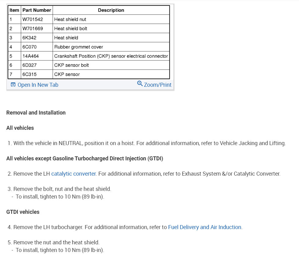

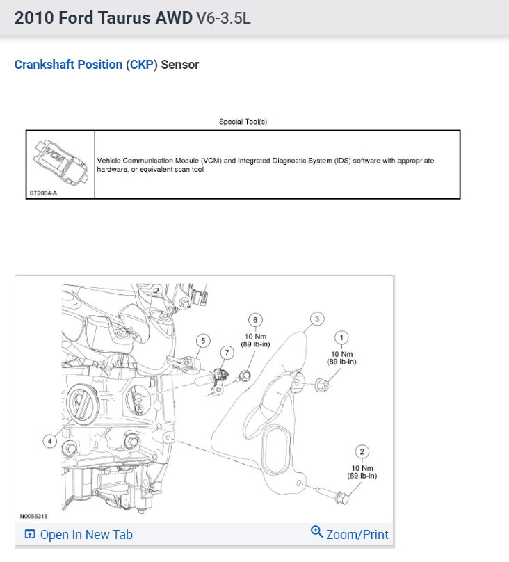

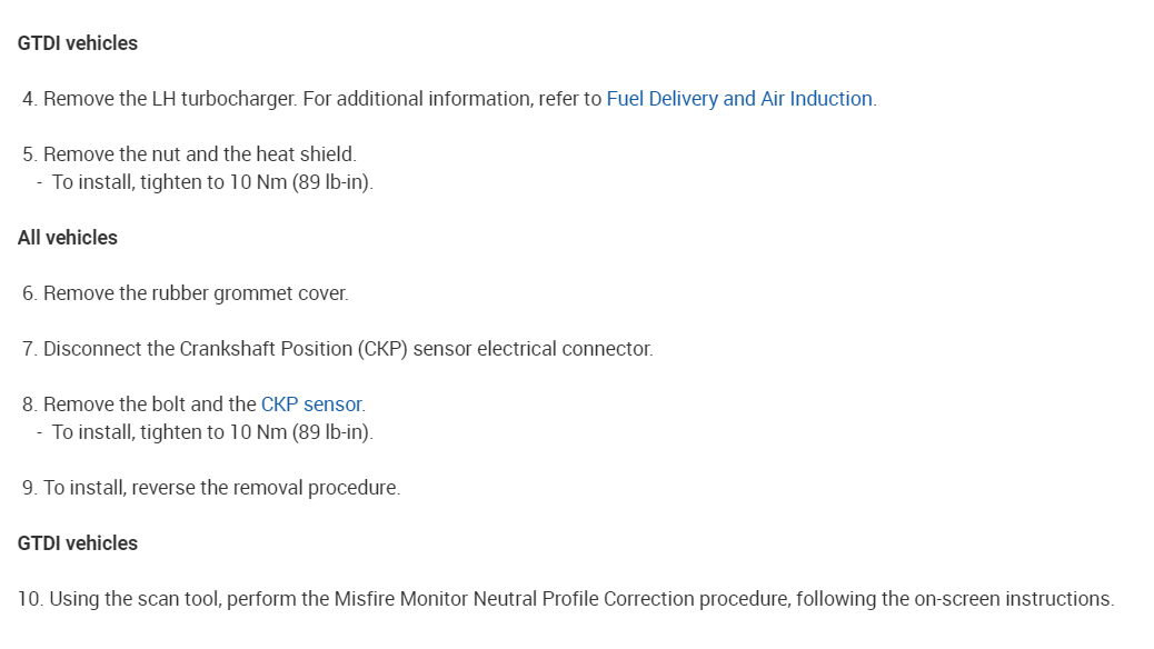

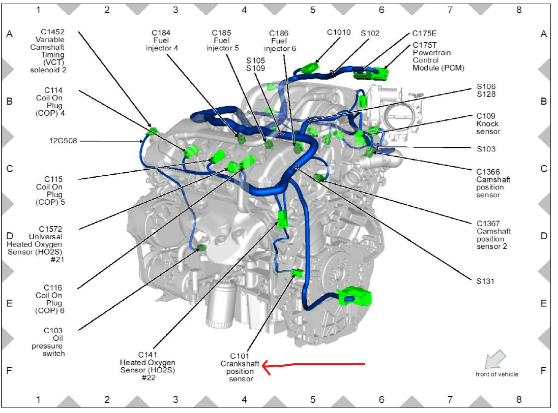

Crank shaft position sensor location needed.
Sunday, August 27th, 2023 AT 6:56 AM
KEN L
MASTER CERTIFIED MECHANIC
55,499 POSTS
Here are the location and the instructions on how to change out the crankshaft position sensor. Check out the images (below). Please let us know if you need anything else to get the problem fixed.
