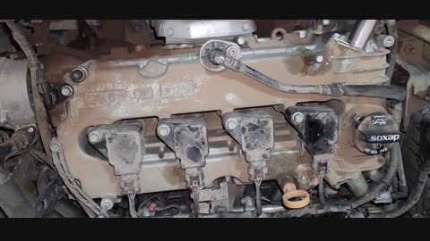

Here's the video.
May 27, 2025 at 6:02 PM
RHERMO
  • 7 POSTS
Just shakes more than anything.

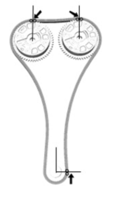

Yep, it sounds like the timing chain has jumped and now the engine has low vacuum. This is why the brakes are not working as well. Here are the timing marks if you want to install a new chain, tensioner and guides. This is the only way to get the engine codes to go away and for the engine to run correctly. Check out the images (below). Please let us know what happens.
