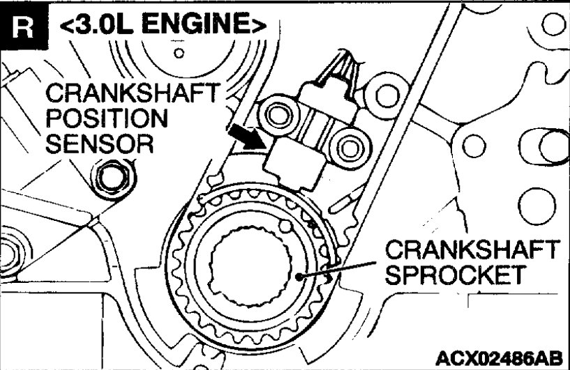

Where is the crank shaft position sensor located? This is a 3.0l engine.

It is located right above the engines actual crankshaft.The accessories and covers on the front of the engine will have to be removed to gain access. Here is a basic tutorial showing what's involved for the replacement:
I've attached a picture below of your cars sensor location.Hope this helps and thanks for using 2CarPros.
