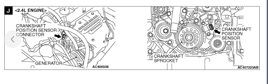

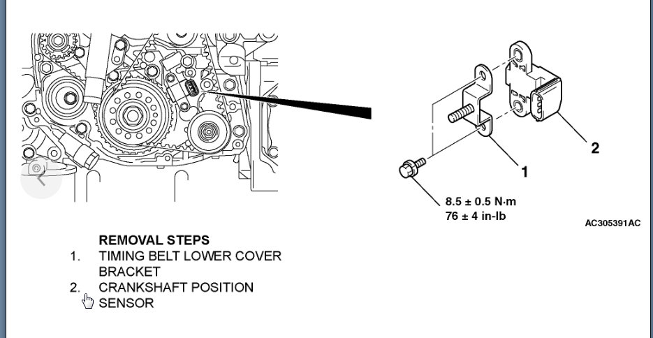

I need to know where the crank position sensor is on my car listed above. I can't find any videos online for the 2007. Can you help me?
May 9, 2020 at 12:54 AM

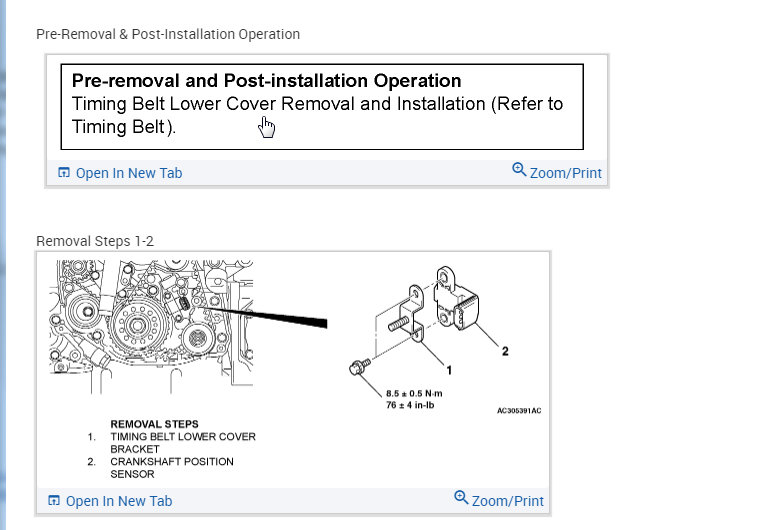

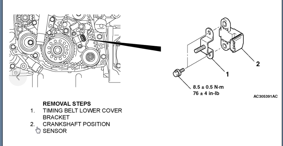

More then likely you are not finding it because it is covered by the lower timing belt cover. I attached the process and location. You will see it next to the crank pulley because clearly it needs to measure the crank rotation.
Let me know if you still need more info. Thanks
