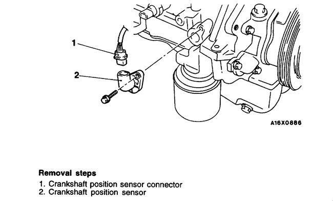

No spark, no fuel.
Wednesday, March 25th, 2020 AT 1:06 PM
SCGRANTURISMO
  • 4,897 POSTS

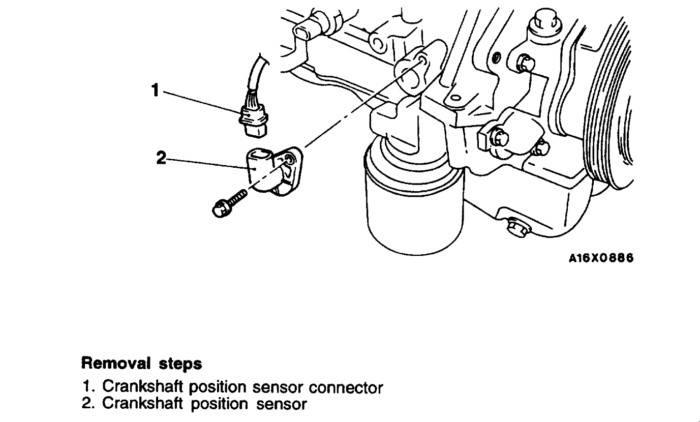

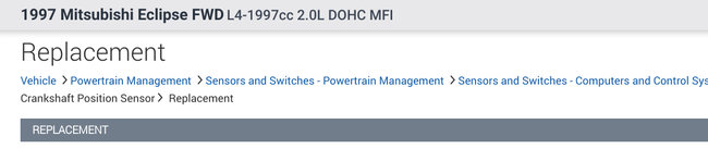

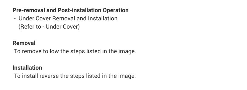

This could be a problem with your vehicle's Crankshaft Position Sensor[CKP]. In the diagrams down below I have included the instructions for the removal and installation of the CKP for your vehicle. Please go through this guide and get back to us with how everything turns out. We can go from there if needed.
