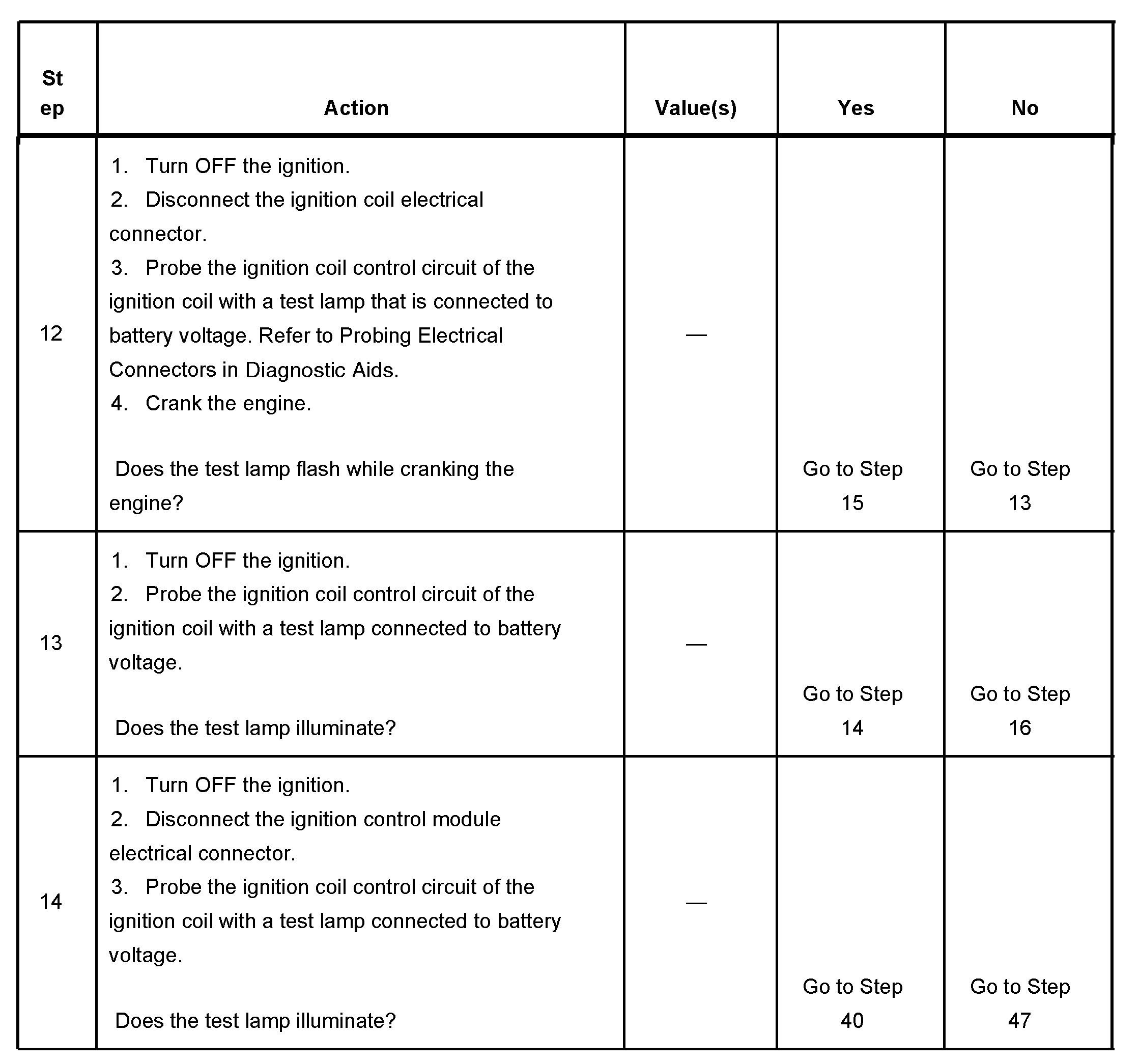

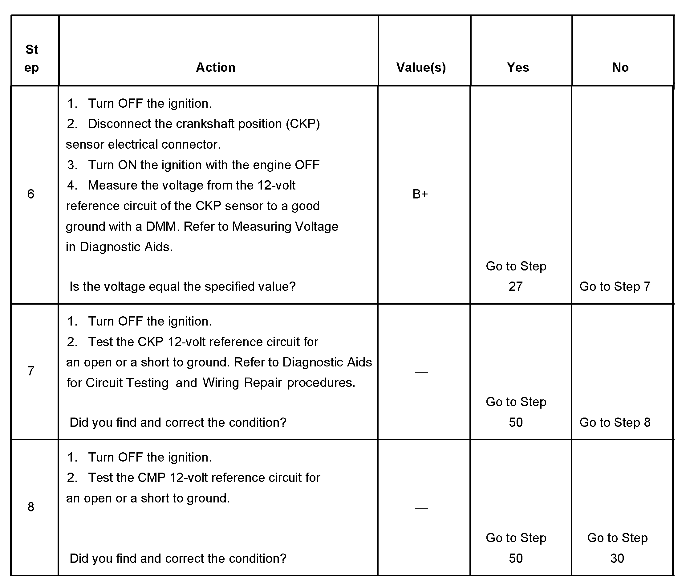

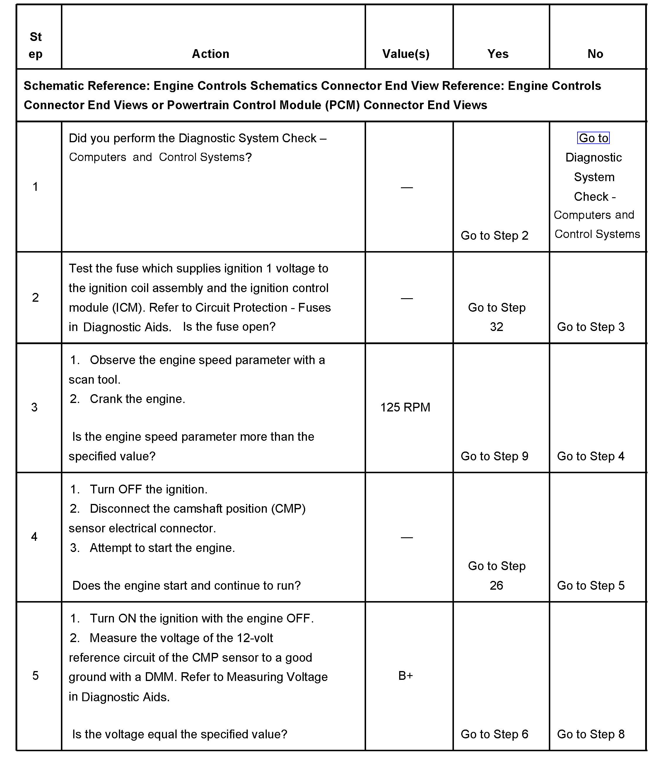

Truck ran fine, parked in yard. Next morning would not start. Turned over fine. Checked spark. No spark from ignition coil. Checked resistance on coil primary and secondary, both within specs. Checked signal from ECM at ICM and from ICM at coil with test light. Had good signals on both. Have power on coil and ICM pink wires in on and start position of switch however voltage dropped from 12.6 to 11.5v while starter turning. Replaced coil, ICM, crank sensor and ICM connector. Still no spark. Could the voltage drop while starter turning cause the coil output be too low to jump the gap? It sounds normal while cranking.

The rule of thumb I learned years ago was 9.6v was a minimum while starting to allow it to start.

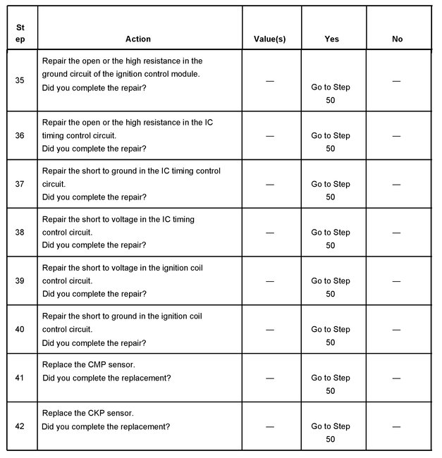

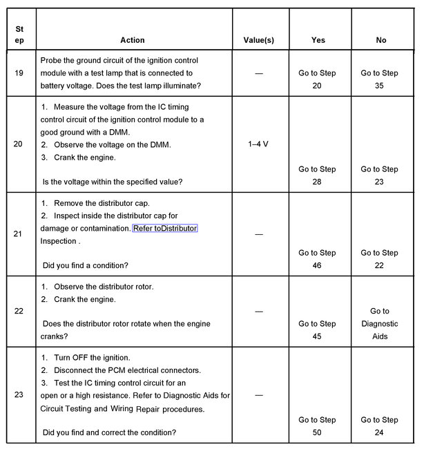

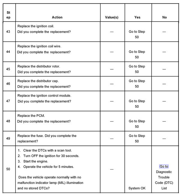

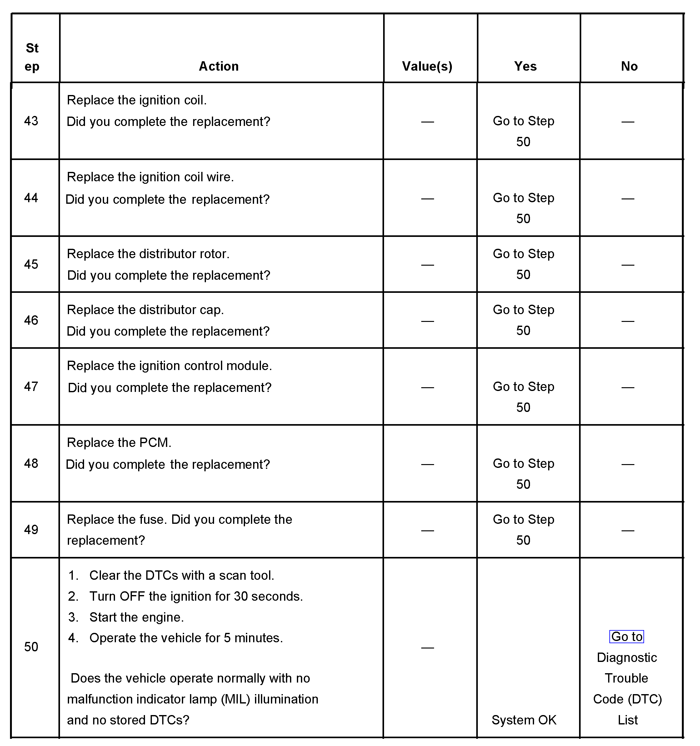

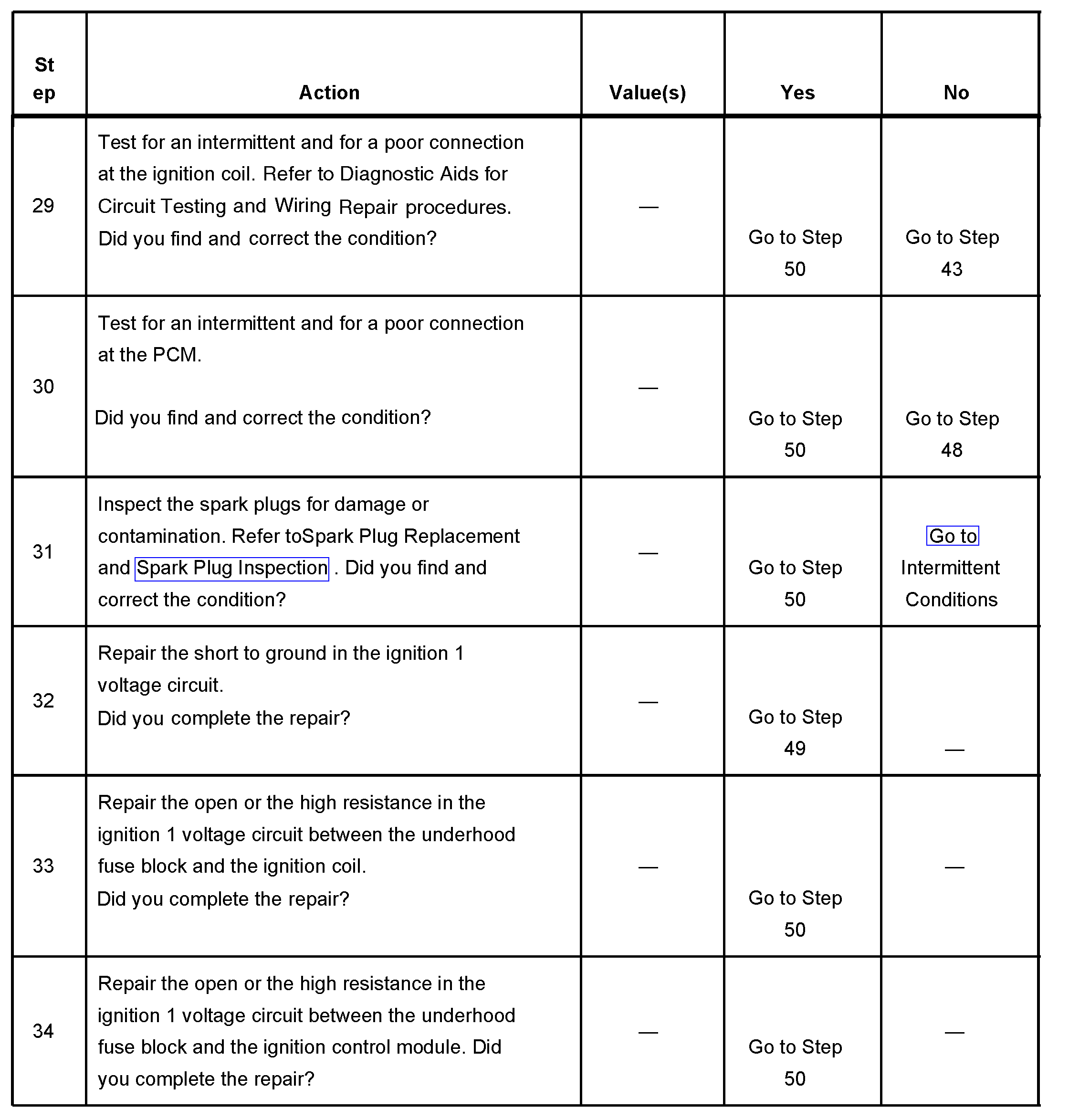

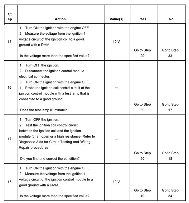

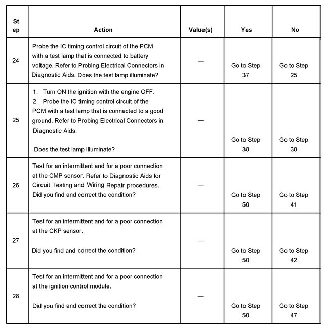

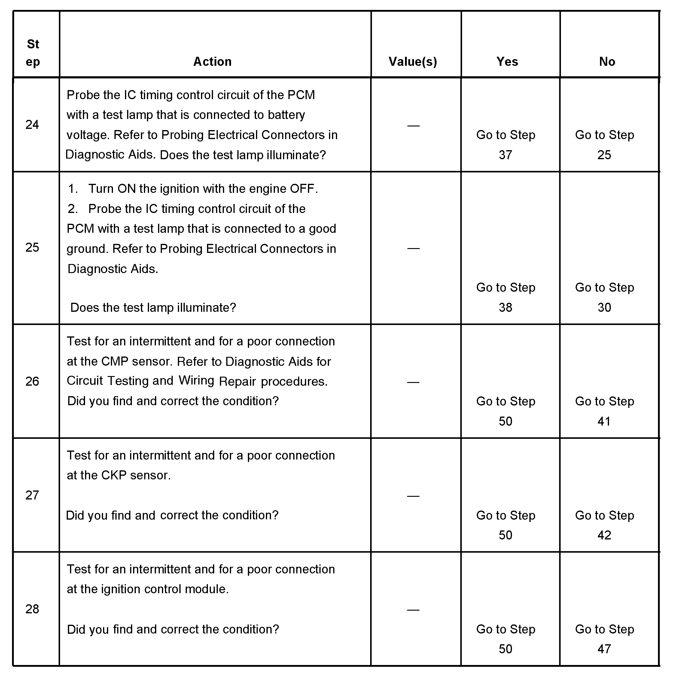

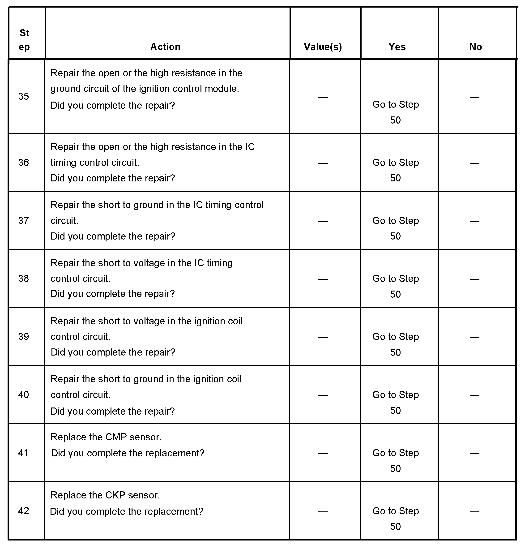

As far as the problem, I am attaching the diagnostics for a no spark condition. I have a feeling you have already done a lot of it. However, look through it and see if there is something you may have missed. The attached pics are the actual flow charts. If I'm reading them correctly, it could even be related to the cam sensor.

Steps 1-5
pic 1
Steps 6-8
pic 2
Steps 9-11
pic 3
Steps 12-14
pic 4

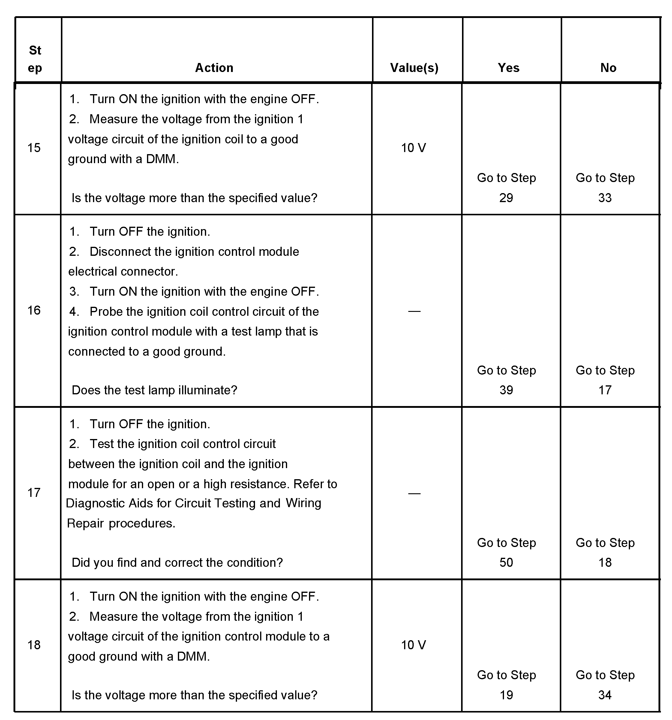

Steps 15-18
pic 5
Steps 19-23
pic 6

Steps 35-42
pic 9
Steps 43-50
pic 10

3. This step is testing for a crankshaft position sensor (CKP) signal to the PCM.
4. This step is testing for an internally shorted camshaft position sensor.

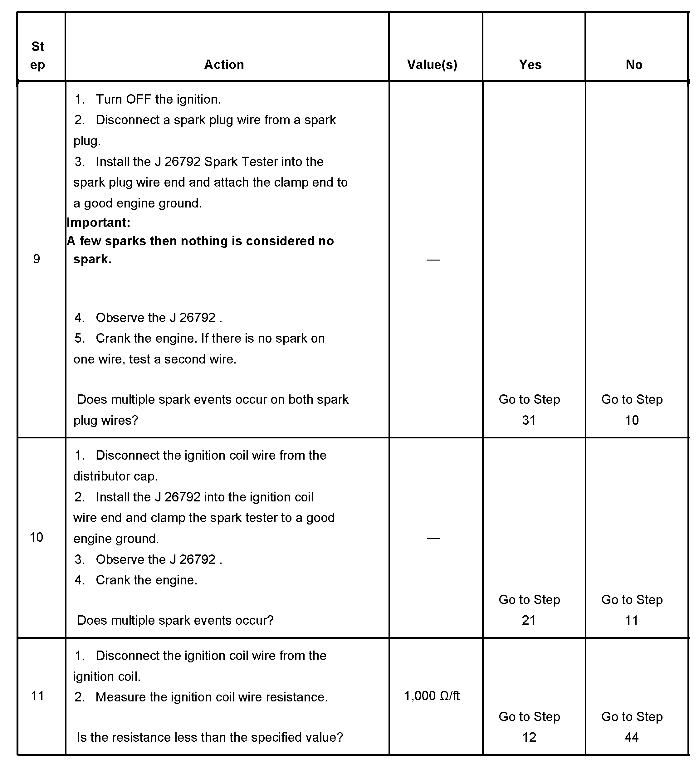

9. This step is testing for spark output at more than one spark plug wire. The J-26792 requires a minimum of 25,000 volts to operate.
10. This step determines if spark is being delivered to the distributor cap.

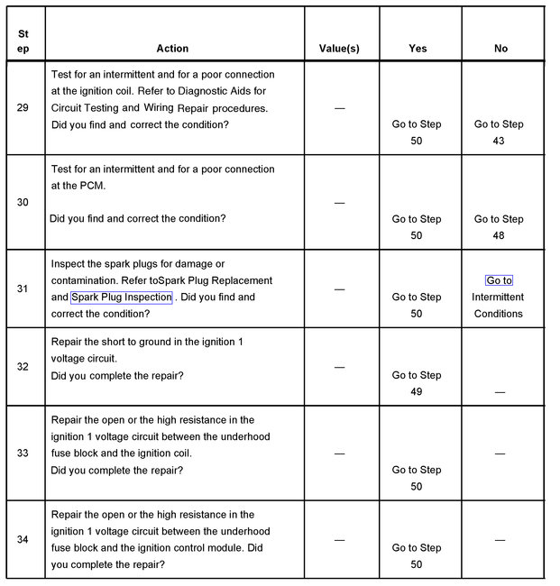

You guys are great. I got to step 29 in your diagnosis table, testing the coil connector. Although it had the correct outputs, I could not verify that it was making good contact with the coil, so replaced it. Was so confident that we hit the switch and it fired right up. Thank you so much.
