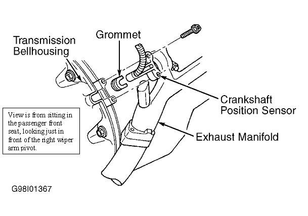

A 1998 model is getting close to when they started where the engine, once running, could continue to run if one sensor failed, the crankshaft position sensor or the camshaft position sensor, but as with the older models, the computer needed to see signals from both sensors to start running. What we need to do next is connect a scanner to look at the state of those two sensors during cranking. Cranking by itself is usually not sufficient for a missing signal to set a fault code, so we can't assume anything just because there is no related code right now. We need to verify both signals switch from "No" to "Present" when cranking the engine. If they are both present, the next suspect is the injectors are being shut down by the security system. When that happens, the engine should run a few seconds if you spray in starting fluid.

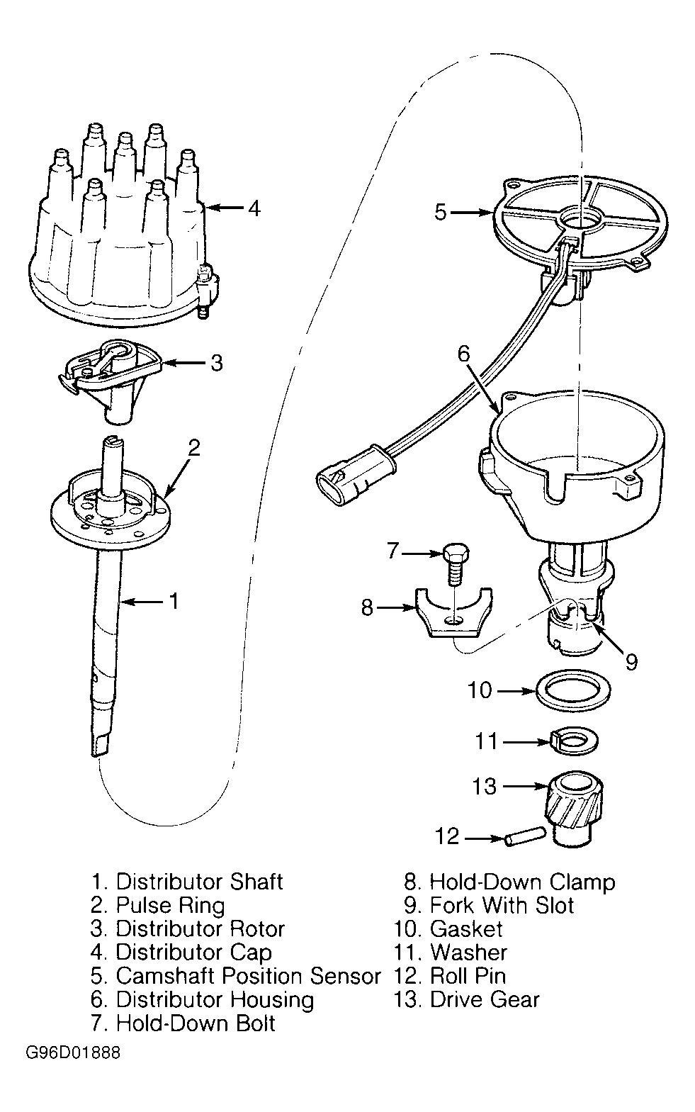

Thanks for the information on Scanners. I think the cost would be prohibitive since I don't do this for a living. I did install a camshaft sensor about six months ago. Is there some way we can move forward without the scanner, to the next step and assume they both work or replace the camshaft sensor? If not I could try to find an equipment rental sixty miles away when I go to town. What do you think?

The crankshaft position sensor for your engine is an improved design over the original ones. The first ones needed to be installed with a special paper spacer to set the critical air gap. Yours has a redesigned mounting bracket that makes it impossible to set wrong. There have been some stories about the magnet core cracking, causing a popping or back-firing problem. I've never run into that myself. This sensor does have internal electronic circuitry, as evidenced by it having three wires instead of two. That circuitry lends itself to failing by becoming heat-sensitive on all car brands. A common symptom is they work fine as long as you're driving, but cause a crank / no-start right after a short stop, such as when stopping for gas. While standing still with no natural air flow, heat from the engine migrates up to the sensor, causing it to fail. We call that "hot soak". The sensor usually works again after cooling down for about an hour.
The crank sensor on your engine is somewhat hard to get to. It's in the transmission bell housing, right behind the right cylinder head. I would only replace it as a test if I already had a new one on hand. The problem with intermittent problems is when you do replace a random part, you will never know if that solved it. You will only know it did not solve it if it acts up again. I wouldn't want to drive to another state and risk it acting up again. If you can find a missing signal on a scanner, that would give you the confidence to at least know you're in the right circuit.
