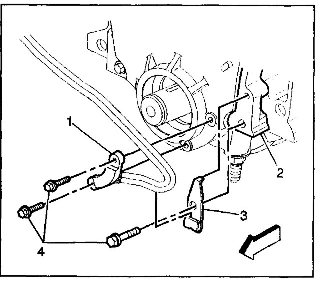

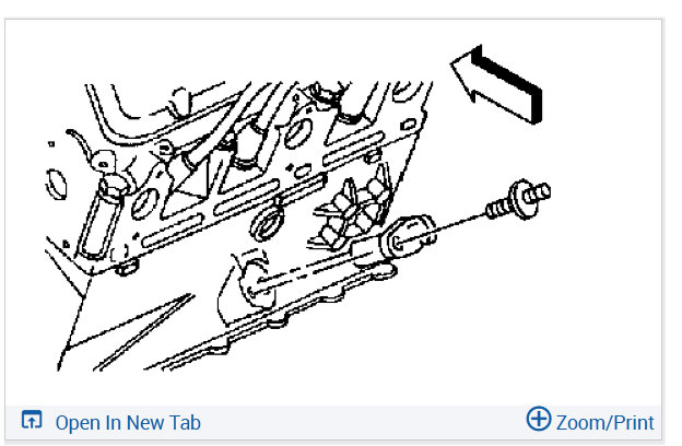

A couple shots of starter fluid starter fluid and she comes to life. Now the cooler it is outside takes a little more. On a side note, my cooking fans won't come on thought they were fried until I hard wire straight to 12v they not fried. Keeping those 2 factors in mind I replaced the coolant temperature sensor and it changed nothing (wish I would have done that when I was messing with the injectors that was a pain in the you know what) now I did change throttle position sensor and now she'll starts back up soon after I turn her off but if I wait a few hours she needs that drink (a buddy recommended AA. He's a moron). Okay, behind the harmonic balancer is 1 CPS and the other is the one connected to the ignition control module correct? And where is the camshaft position sensor? Typing on this phone is making my thumbs sore, your turn.
Monday, May 26th, 2025 AT 7:21 AM
KEN L
  • MASTER CERTIFIED MECHANIC
  • 55,469 POSTS
Yes, one crankshaft sensor runs the ignition and the other the injector system, if you replaced one I would do the other. Here are the locations. Check out the images (below). Let us know how it goes.

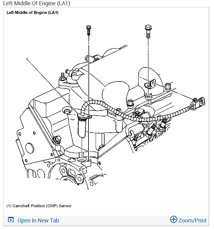

Thanks I'll keep you posted. By the way can you tell me where the cam position sensor is?
Monday, May 26th, 2025 AT 1:11 PM
KEN L
  • 55,469 POSTS
Np, here is the camshaft sensor location. Check out the images (below).
