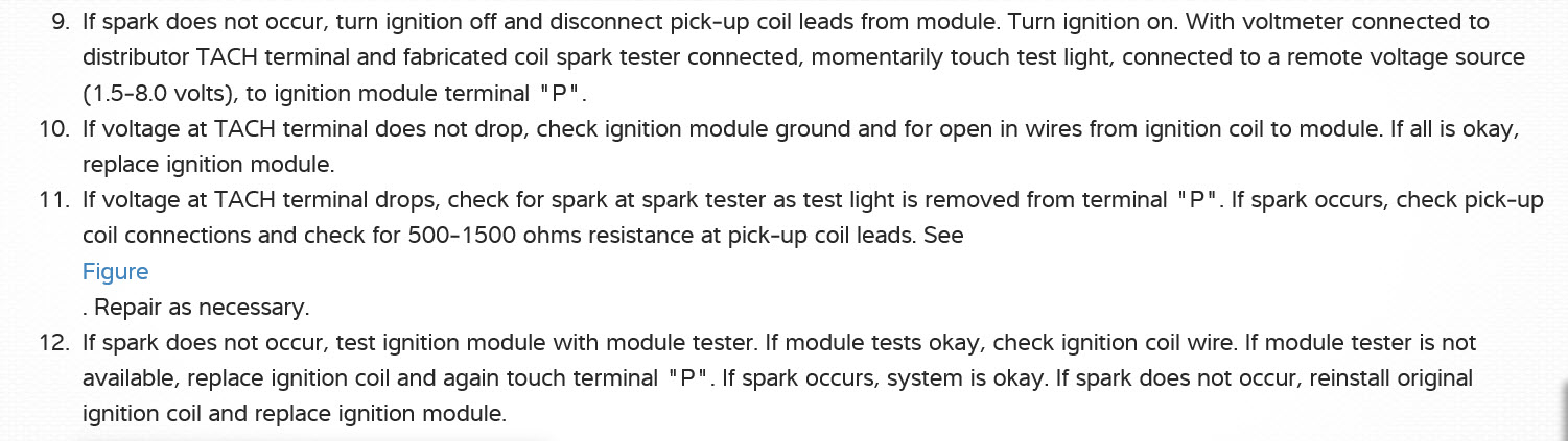

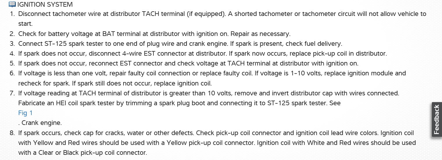

Last time truck driven it bucked several times rather violently when accelerating. Thought it a fuel issue. Then truck set for a month while I was in hospital. Now cranks but never fires a lick. Engine does not appear to have adequate spark (weak yellow orange) and does not appear to be getting fuel. New coil, ignition control module, distributor cap, rotor, fuel pump relay, fuel filter. Still weak spark no fuel. Seems something is interfering with the ECM start routine but I can't figure out what. The manual indicates this model does not have a crankshaft sensor. Could it be the ECM? Any help appreciated.

Check coil wire for resistance all plug wires/coil should not have more than 5000 ohms per foot check coil reisistance as well. Then check wires from pick up coil to module in dist sometimes these go bad also if internally mounted coil check for a bad or broken coil piece

Pickup coil was bad and apparently not sending signal to ECM to fire ejectors. Replaced pickup coil - now ejectors are firing and spraying gas into throttle body. Still no start. Spark at plugs is only yellow-orange instead of blue/white. Does not appear to be hot enough to ignite compressed gas. New coil, new ignition control module rotor and distributor cap. Nothing else spark related to replace except plug and coil wires. Could old bad wires be knocking the spark from a new coil down to the point it is not hot enough to ignite gas? Thanks.

Don't think so but you never know on that. Try a new set and check compression before you replace wires. If you have a tach wire on this disconnect it and see if it starts as this will not allow vehicle to start if shorted. See pic for other things to check but disregard things you have replaced. Also check ecm fuse. Tach wire is white
