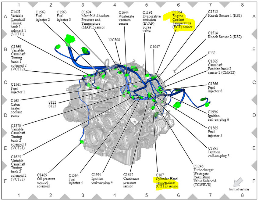

Where is the coolant temperature sensor located?
2012 FORD F-150
225,000 MILES • 3.5L • V6 • 4WD • AUTOMATIC
CHADDERBOX
Location of the coolant temp sensor (ECT).
Jan 22, 2025 at 9:21 AM
BORIS K
  • 836 POSTS
The engine has a coolant temperature sensor (ECT) and a cylinder head temperature sensor. The ECT is at the rear of the engine and the CHT sensor is mounted on the cylinder head and under the intake manifold

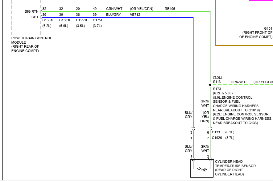

Picture 1 shows locations for both. However, most of these only have a CHT sensor. Picture 2 gives you a better view of the CHT location.
Cheers, Boris

CHADDERBOX
Although, the picture you are using as a ref. is not an ecoboost motor, as for it doesn't have turbos in place.
Jan 24, 2025 at 7:11 PM
CHADDERBOX
Again, looking at the ref. picture, I don't see any ECT mount on rear of the engine. The 2 sensors indicated on rear of both heads, are the intake and exhaust cam pos. sensors. Can you very your stated ECT location?

BORIS K
  • 836 POSTS
Looking at the wiring diagram for the cooling system it appears that the cylinder head temperature sensor is used.
Cheers, Boris
