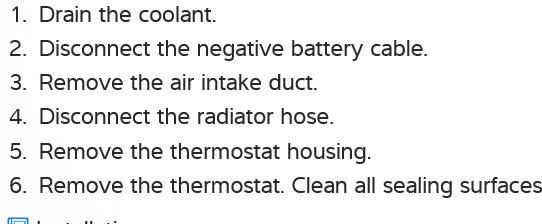

Is the thermostat in the block where the top radiator hose connects?
Wednesday, May 4th, 2016 AT 6:32 AM
HMAC300
MECHANIC
48,601 POSTS
Instructions in picture shows how to replace it. It should be under top radiator hose.
Here is a guide on how to change it.
Image (Click to make bigger)
