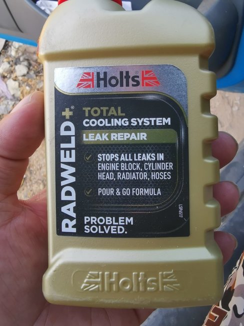

In vase there is no bubbles can i use a coolant system leak repair as shown in the picture or will harm the engine?
Nov 20, 2019 at 6:31 AM
  • 110,190 POSTS
I never recommend using these products unless it's an emergency. Also, the problem isn't a leak but the opposite, pressure isn't releasing. Is coolant leaking at some point?
Nov 20, 2019 at 2:49 PM
