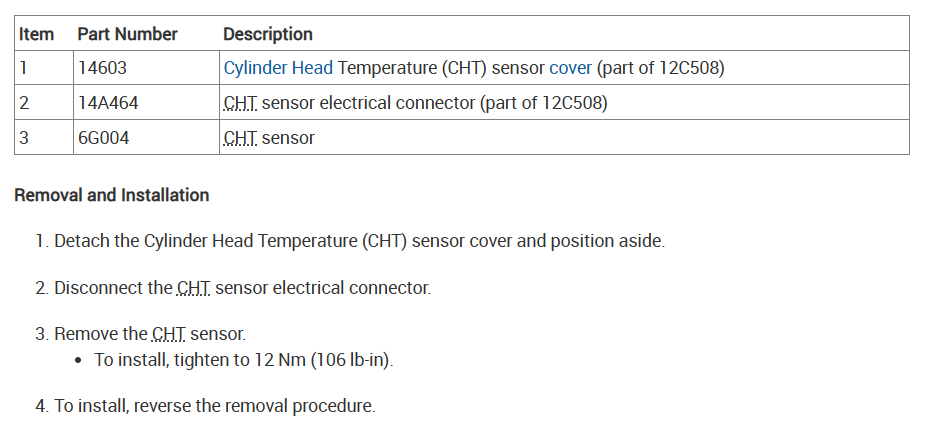

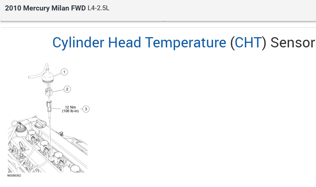

Where is the coolant temperature sensor located?
2010 MERCURY MILAN
110,000 MILES • 2.5L • 4 CYL • AUTOMATIC
SILLYKAT
do you have a diagram for where this is located?
Feb 20, 2025 at 4:01 PM
  • 54,503 POSTS
So they call the engine coolant temperature sensor a cylinder head temperature sensor which is located on the cylinder head near the spark plugs. Check out the images (below). Let us know if you need anything else.
Feb 21, 2025 at 10:22 AM
