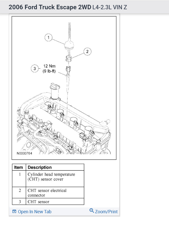

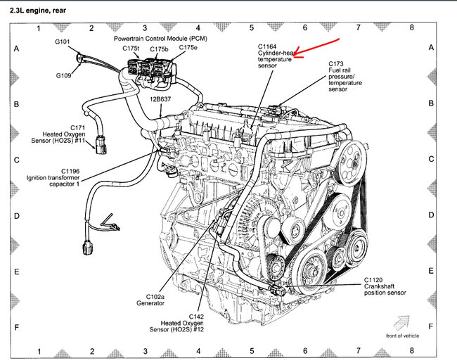

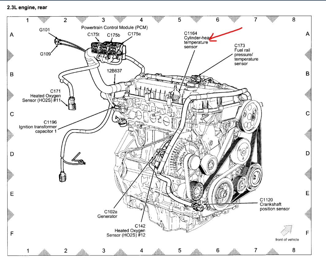

Need location of coolant temperature sensor.

Sure, the engine coolant temperature sensor is in the middle of the cylinder hear under the rubber plug, check out the images below to show you the location and how to change it out for a new sensor. Please let us know if you need anything else.
