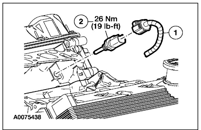

Coolant temperature sensor missing an extension?
2003 FORD F-150
225,000 MILES • 4.6L • V8 • 2WD • AUTOMATIC
WILLIAM DYER
Sensor is 2 blade. It was broken off when I bought it. There are no connectors on the wire harness that fit. Am I missing an extension wire/cable?
Sep 28, 2025 at 4:21 PM
  • 54,494 POSTS
So by engine coolant sensor, I think you mean the engine temperature sensor which is under the intake manifold, correct? There is no wiring extension for that sensor, it is part of the main engine wiring harness. Here is the sensor location so you can check it out yourself. Check out the images (below). Please upload pictures or videos in your response.
