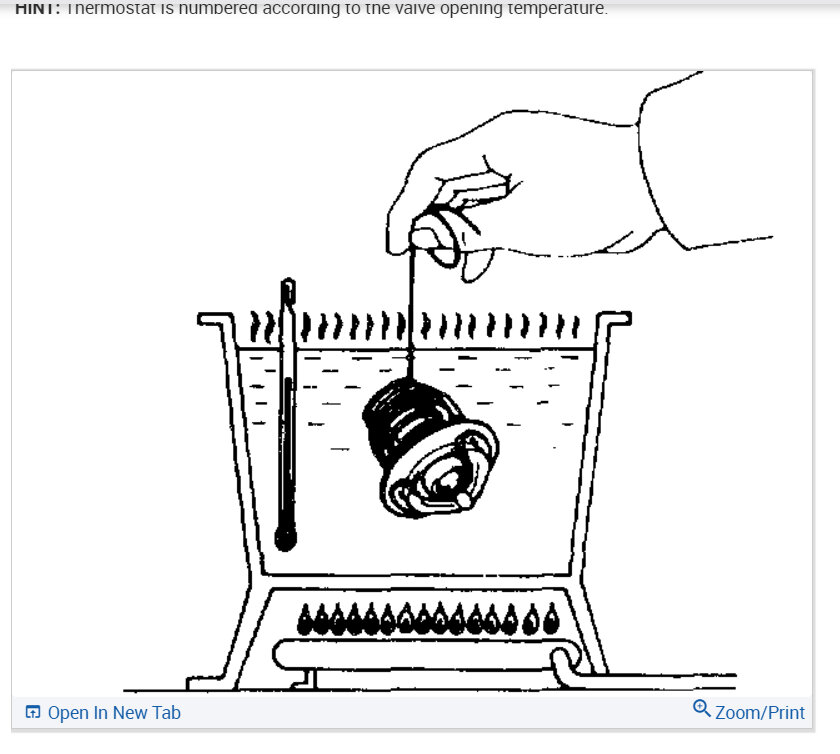

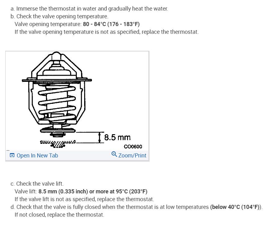

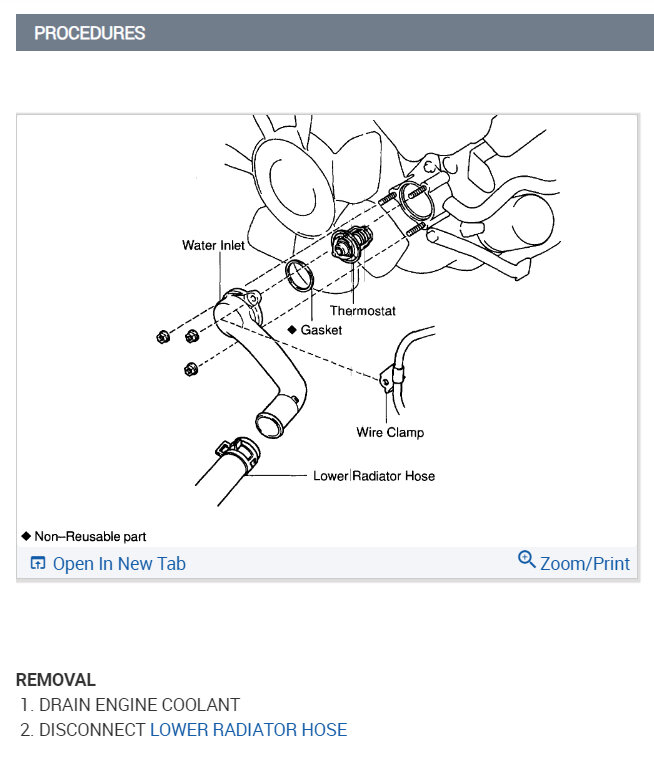

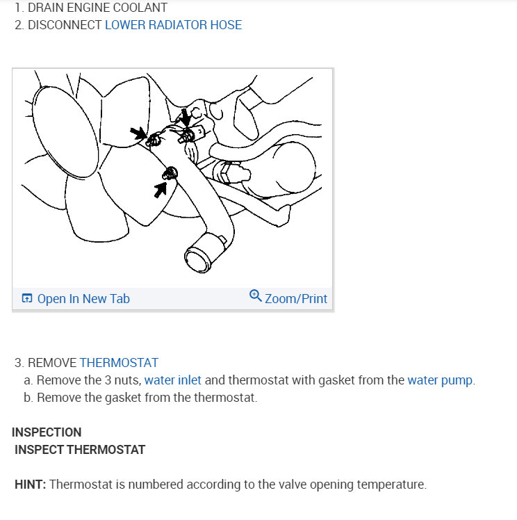

It sounds like the thermostat is stuck closed and I noticed that it has not been replaced and if so, the new unit is defective. Here is how to change it out. We always had luck by jacking the rear of the car up, but you can try the front of the car as well. Check out the images (below). Please let us know how it goes.
