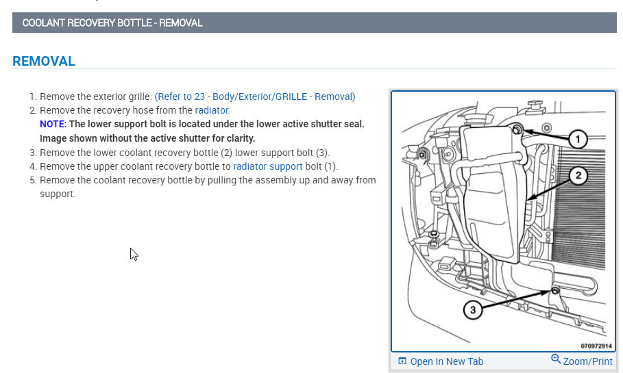

How do you get to the coolant reservoir to take it out? Looks like you would just take out the battery tray, but have taken out all visible bolts and tray won't come out.

Are you talking about the recovery bottle pictured in the attachment? If so this shows where all the bolts are. I imagine you missed one because it should just come out. If not, get a picture of what you are working on and I will get you the process to remove that. Thanks
