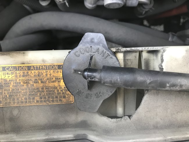

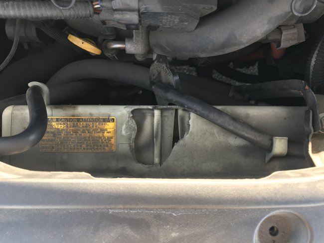

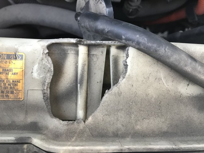

Is it safe to drive my car while my coolant reservoir tank is cracked until they can find the replacement part? Please reply ASAP.

Where is the crack? Can you upload a picture of the tank and the area that is cracked?

Yes, please review.

Thanks. Do you have the piece that broke off? That's a big hole.

No, I did not even know until David at Jiffy Lube popped my hood up for an inspection. So, can I still drive it or do I have to wait?

That is an overflow tank and there is no pressure there.
Yes, you can drive it but get the part ASAP. You may notice it leaking on the ground and check the level daily.
