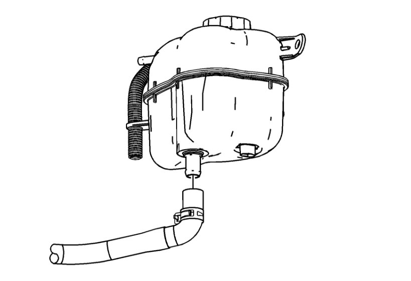

Coolant reservoir is leaking from the bottom of it, did not see any holes in the tank or the hoses. When I take the cap off it leaks and when I start the car it leaks.

Is this where it is leaking?
https://www.2carpros.com/articles/coolant-reservoir-replacement
https://www.2carpros.com/articles/radiator-pressure-test

It leaks with the cap on also but not bad as when the cap is off or the car started. It did get hot when it started leaking suddenly. I think it may be coming from the square looking hole that is in the bottom of the tank, but not completely sure.

I would start with a radiator cap. Beyond that you will need to do a pressure test to find the exact failure.

I got a new cap and put it on and it is still leaking when I start the car. The coolant in it that was left overnight was still in the tank this morning.
Aug 18, 2018 at 9:15 AM
Okay, you need to rent a pressure tester and pressure test the system to find the leak.
It could be a hose, switch or the tank itself.
