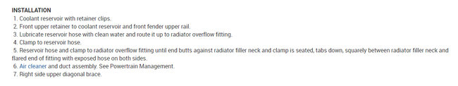

I need to replace the coolant reservoir on my car listed above GTP.

Replacement is not difficult. You will need to remove the cross brace under the hood, but that is easily accessible. Also, the air filter box and induction tube will need to be removed to make access.
Once those things are removed, there are two retainer clips holding it in place.
To further help get you started, here is a link showing how it is done. You can use this to help guide you.
https://www.2carpros.com/articles/coolant-reservoir-replacement

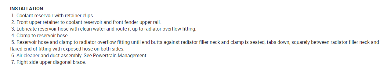

Additionally, if you look at the two pics below, they include a pic and the directions specific to your vehicle for replacement.
