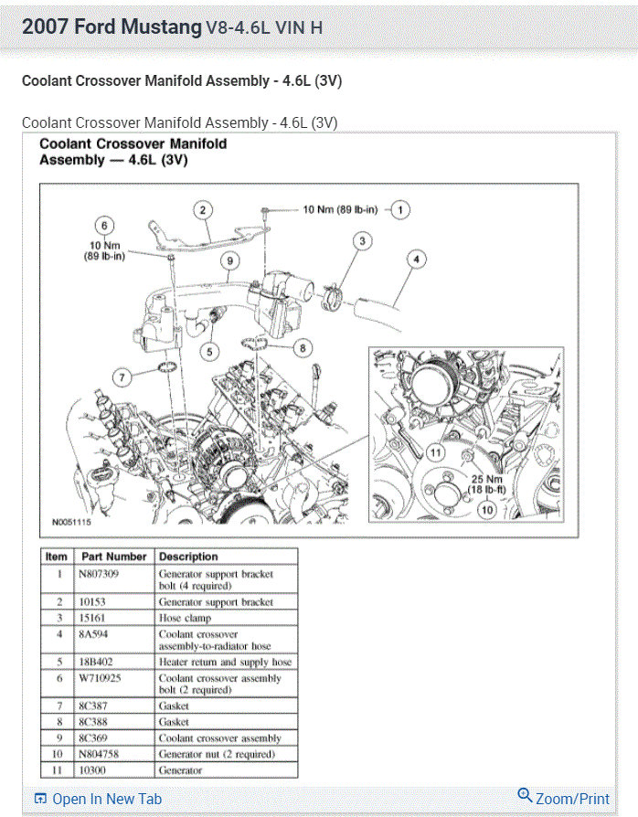

What can leak under the intake of these v8 engines? It just developed a leak. Once it gets to optimum temperature, I see a leak coming from the back of the motor, and I looked under the intake, and I see some rust and some water from that leak.

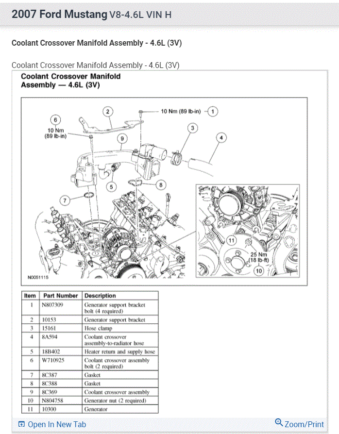

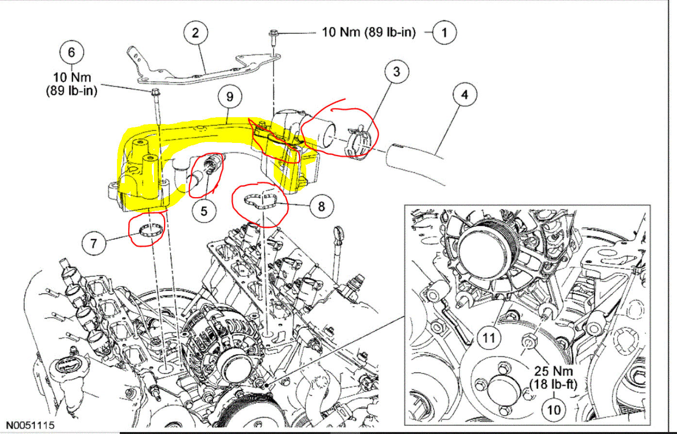

I suspect you have the 4.6L V8. There is a coolant cross-over on the rear of the engine that can be leaking.
If you look at pic 1 below, I highlighted the cross-over and circled all the places that could leak. Check those areas first.

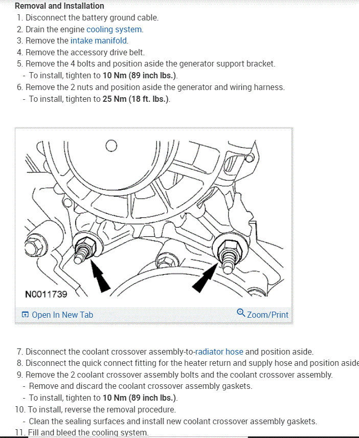

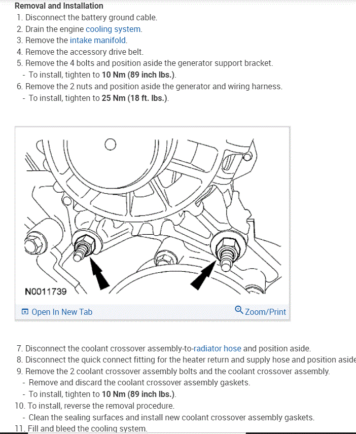

If you find it needs to be removed to fix the leak, pics 2 and 3 provide the directions. You will also need to remove the intake manifold.
Let me know what you find or if you have questions.
See pics below. Note: If you have a 5.4L, let me know.

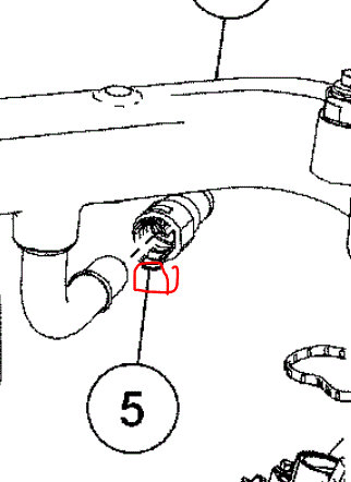

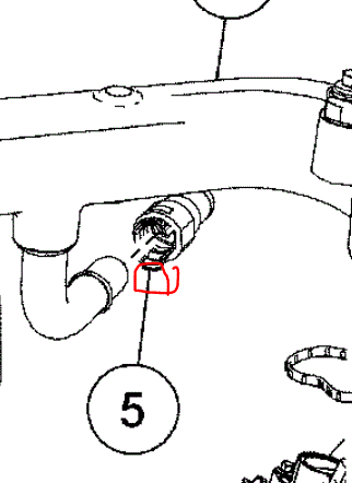

I attached a pic below. Is that the one you are referring to, the heater supply hose? If it is, that is a quick connection. Gently push in on the connector and remove the push pin I circled. Then, pull it off.
Be careful removing it because there is a rubber O-ring in the connector. If it gets damaged, it will leak.
Let me know if this helps.
See pic below.

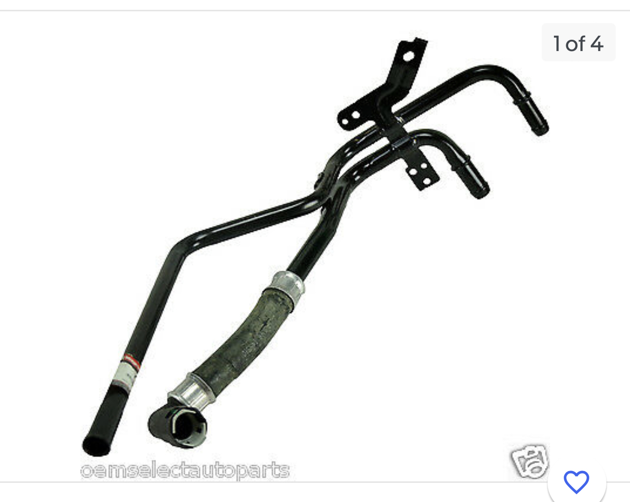

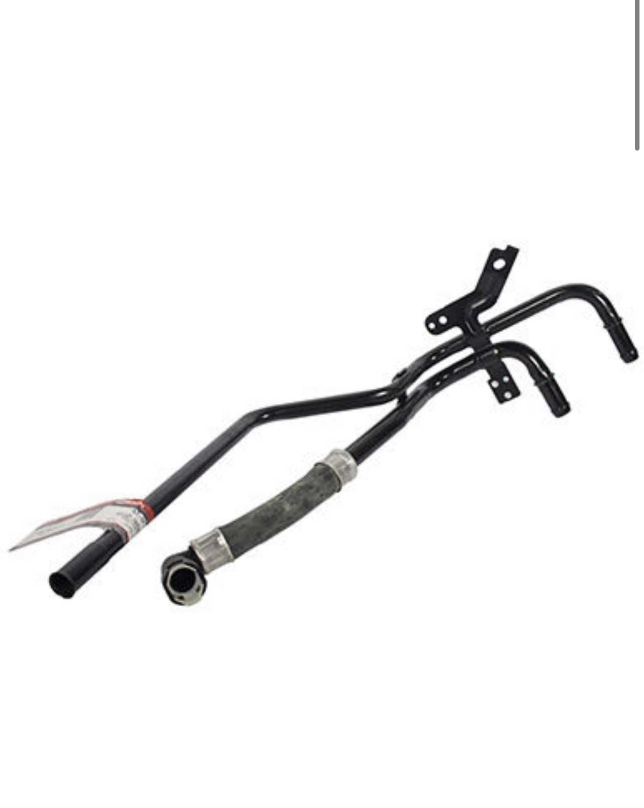

This hose to the left which comes with the other hose, where does it connect? It's mostly metal. It lies down on the bottom underneath the other one a d connects from front to back.
Saturday, January 8th, 2022 AT 6:16 AM
  • 110,194 POSTS
One is a heater return and the other is the heater supply hose. It goes from the heater core under the intake and to the back of the water pump.
Saturday, January 8th, 2022 AT 11:16 PM
DIVIDES
  • 954 POSTS
Yes, that is it. Is there an o ring where it attaches behind the water pump? Couldn't find anyone replacing it and how to remove it.
Sunday, January 9th, 2022 AT 6:42 AM
  • 110,194 POSTS
On one end will be a quick connection. On the opposite side, there is an o-ring. That portion is at the rear of the water pump. Before you install the new o-ring, make sure to lubricate it with coolant. That hose will then be bolted into place.

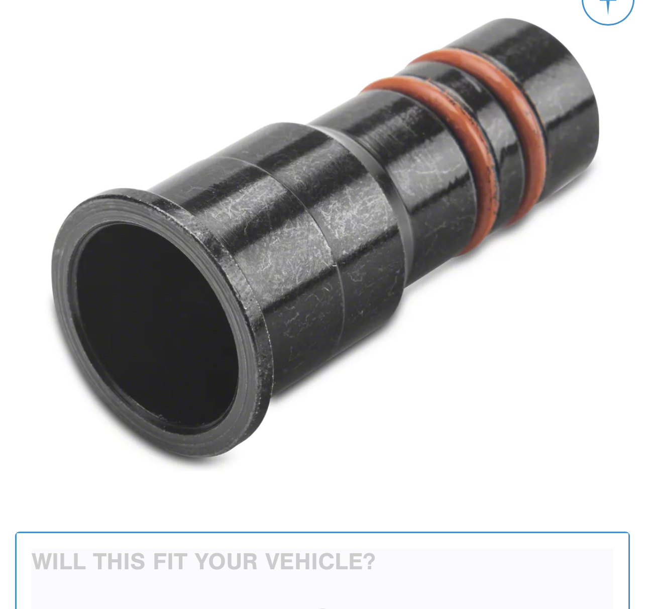

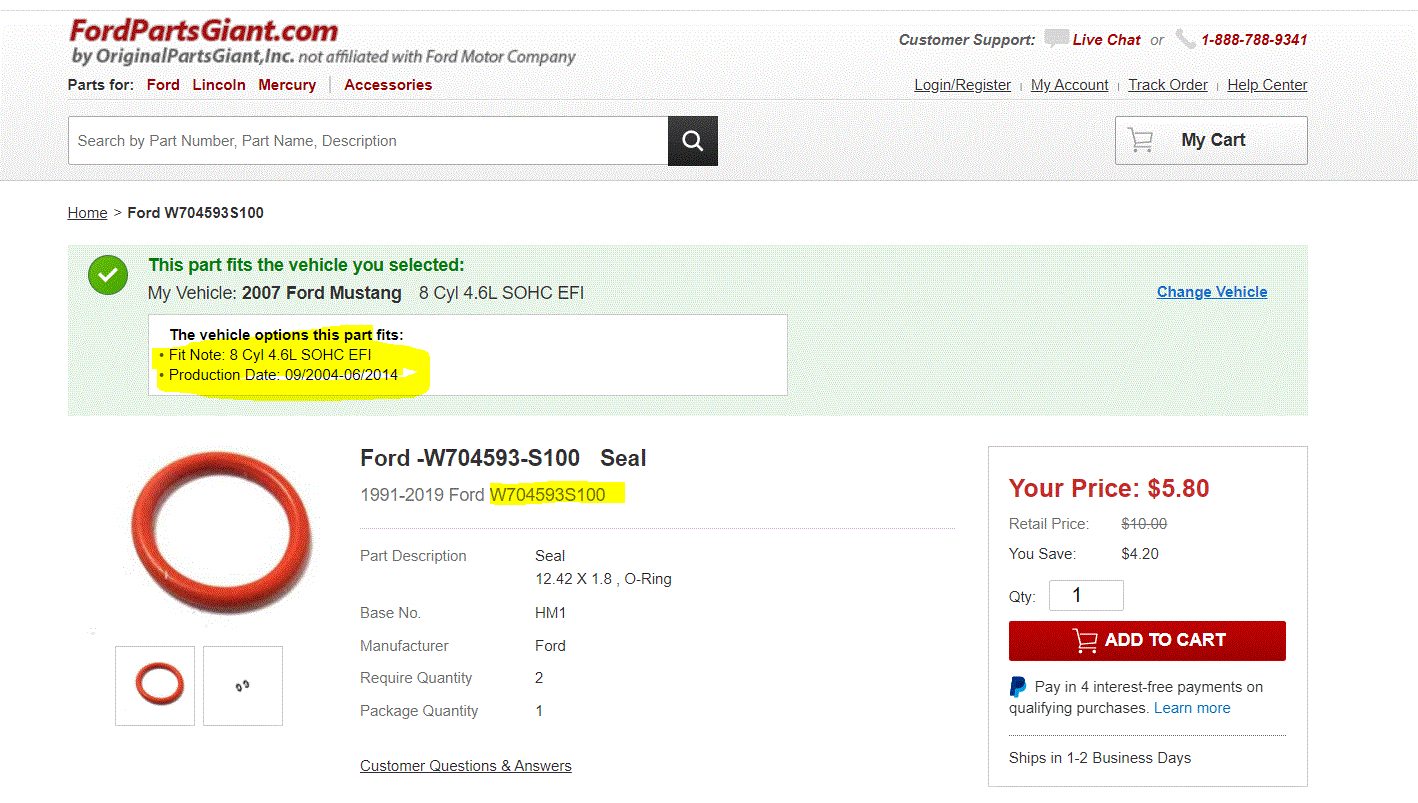

Got it out. Looks like the back of water pump that connects to lower metal pipe has 2 o rings, can you find out what is the part number?
Monday, January 10th, 2022 AT 12:56 PM
  • 110,194 POSTS
Yep, there are two. If you look at the pic below, I attached a pic and the part number. The part number, W704593-S100, is a Ford part number. I'm sure you can find one that works the same in a different brand and for less money.
I hope this helps.
See pic below. Note: I just picked the first Ford dealership that came up to show you. Neither 2CarPros nor I have anything to do with them. In other words, I'm not trying to make money. LOL
