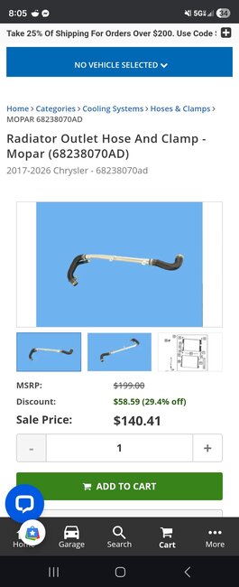

Coolant leak from hose in middle front?
2021 CHRYSLER VOYAGER
180,000 MILES • 3.6L • 2WD
MARIAHALEASE
Coolant is leaking from hose in middle front underneath the van. Each side is clamped onto a silver nipple. There is no other attachments to the hose . Just a black hose and clamps and a mesh black sleeve. I can’t find out what part it was removed from in order to search the hose . It looks similar to an upper rad hose but it’s not on the top of the car it’s underneath the bottom in the middle and it doesn’t have a black plastic tip on the end. It’s just a tube.

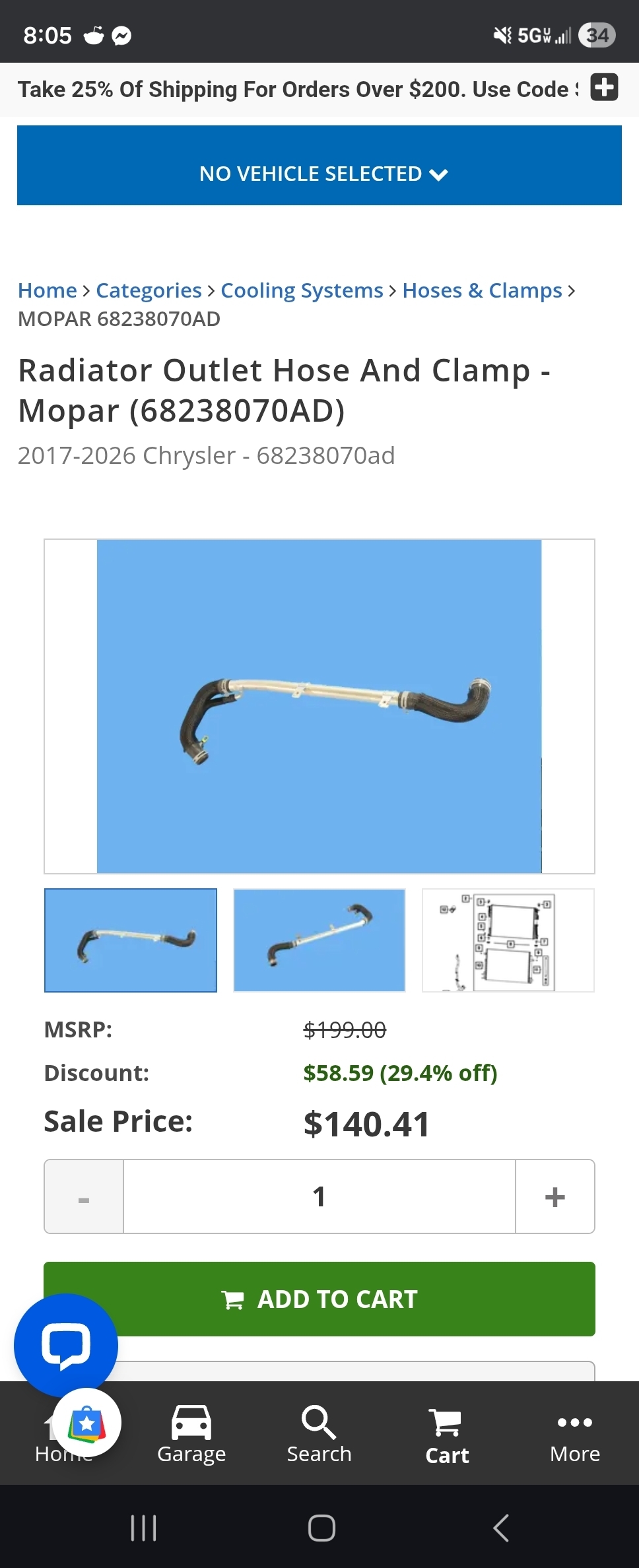

This?
Sep 29, 2025 at 5:55 PM
  • 54,494 POSTS
Yep, that looks like what they are describing, this part is made from thin metal and can corrode causing the leak. Good find BLACKOP555 :)
