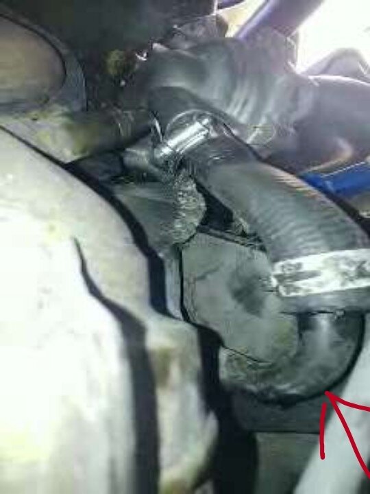

I managed to get the photo to upload. The water pump is visible above. The coolant hose that leads to the oil cooler connects to a hard line that is before the oil cooler. I can't tell where that line goes but it doesn't immediately go to the oil cooler as far as I tell. I drew an arrow approximately where the leak is. It's a drip with reservoir cap on, but it's a stream with the cap off. I'm wondering about the name of the part to be able to replace it. I'm also wondering if it can be patched with some sort of wrap or jb weld.

I believe that it is a heater hose. Am I looking at the water pump at the rear of the engine or is this the auxiliary pump near the radiator?
Thursday, December 15th, 2022 AT 8:47 PM
FYTKID
  • 10 POSTS
At the front near the radiator.

Okay, tried to verify where I thought the leak was coming from. This time with the reservoir cap off so I wasn't just getting the drip as I showed you before. I really can't see exactly where the water is coming from well because the radiator fans are so close to the engine. I'm beginning to think it's the lines closer to the oil cooler and that I might be better off rerouting the coolant to delete the oil cooler lines altogether. At least then I could drive it again. Unless I've had coolant loss, I've never had overheating issues and engine temp has always run below the half hash line. I'm thinking that perhaps the heat shielding around the oil cooler coolant lines has allowed the exhaust manifold to rub through those lines. I'm pretty sure the oil cooler is probably a little much for this engine. What are your thoughts or recommendations about how to bypass oil cooler lines?

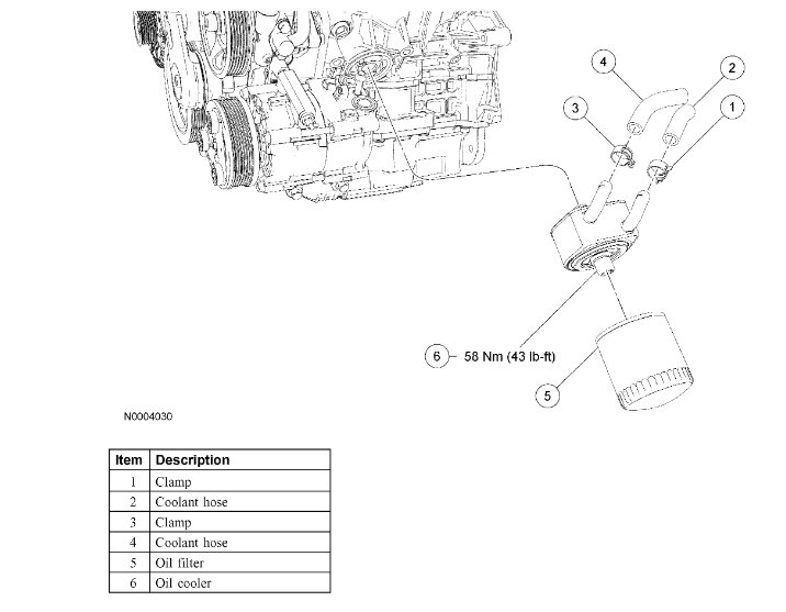

Okay, decided to pull the radiator and try to get a better look. Exhaust manifold is in the way too. I got one hose off the oil cooler, but what I assume is a return line is completely obscured by the exhaust manifold and small cat. If I'm going to replace this assembly with a new one behind the exhaust, I'll need to know what it's called. I've tried shopping online using several of my guesses and nothing matches or seems to exist. Oil cooler coolant line assembly and many other variants didn't work. I wouldn't design a system with rubber hoses between the engine and exhaust manifold, why would anyone? So, who can guess what they named that assembly? They seem to be attached. The in and return I mean.
Wednesday, December 28th, 2022 AT 4:30 PM
  • 110,194 POSTS
Take a look at the pic attached. That's what they give me. LOL
Wednesday, December 28th, 2022 AT 8:43 PM

  • 110,194 POSTS
I have no idea why that didn't attach. Here it is again. Let me know if you get it.

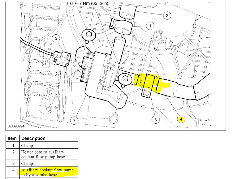

I've seen that pic before. It doesn't show the coolant lines and hoses routed from the water pump that is driven by the camshaft pulley that goes behind the exhaust manifold to the oil cooler and the return from the oil cooler going god knows where.
Friday, December 30th, 2022 AT 1:06 PM
  • 110,194 POSTS
Are you sure it doesn't run up to the auxiliary water pump? See pic below.
If I had it in front of me, it would help. However, I "think" the one hose goes to the water pump at the rear of the engine and the other hose goes to the auxiliary pump.
