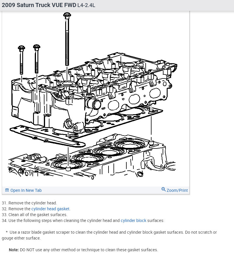

Coolant mixing with oil is a sign of a blown head gasket.
https://www.2carpros.com/articles/coolantantifreeze-in-the-engine-oil
Using leak stop product to seal head gasket or any other leak is a hit or miss. It works for certain leaks but not the others.
