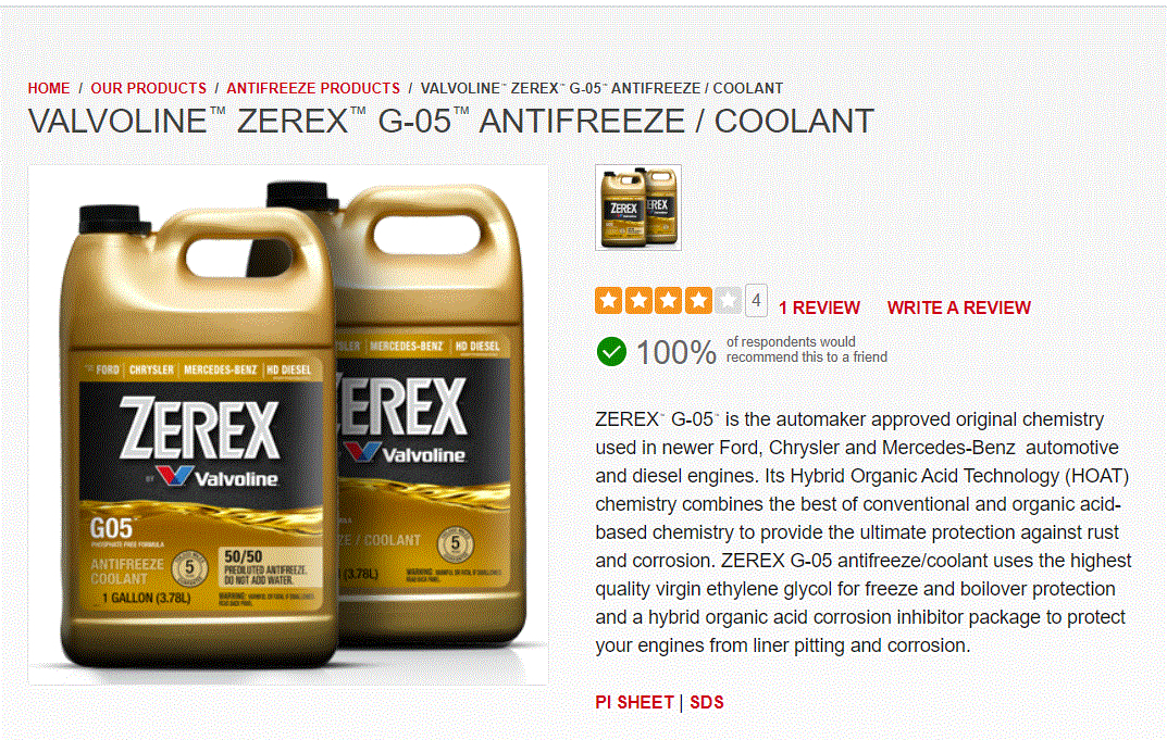

What coolant do i use? What color? Can i use any or specific HOAT whatever that means?
Mar 30, 2020 at 3:53 AM
  • CAR REPAIR CONTRIBUTOR
  • 110,193 POSTS
Here are the engine coolant requirements that the vehicle came with. This info indicates the original type of coolant used by Chrysler and quantity used from empty. If you take the original part type to a parts store, they will get it for you. I will also tell you there are universal types that work with the newer vehicles. Now, the original coolant your vehicle came with should be yellow in color. HOAT stands for hybrid organic additive technology. Again, they now make a universal
The one that we use on our shop is a basic GO-5 universal coolant which can be used in conjunction with the original coolant in your car. I attached a pic below to show you what it is and the pic includes a general description.
2008 Dodge or Ram Truck Grand Caravan V6-3.3L
Fluid Types and Capacities
Vehicle Engine, Cooling and Exhaust Cooling System Coolant Specifications Fluid Types and Capacities
FLUID TYPES AND CAPACITIES
Fluid Types
COOLANT TYPE
Mopar Antifreeze/Coolant 5 Year/100,000 Mile Formula HOAT (Hybrid Organic Additive Technology)
Capacities
Coolant Capacity .................... 13.4 quarts (12.6 liters)
NOTE: Includes heater and coolant recovery bottle filled to MAX level.
IMPORTANT: Add 2.9 quarts (2.8 liters) if equipped with rear heater.
