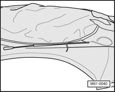

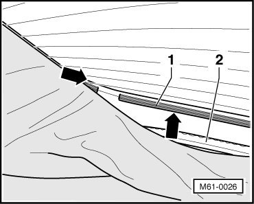

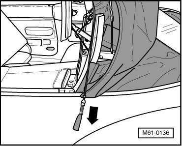

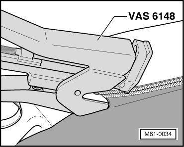

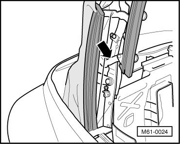

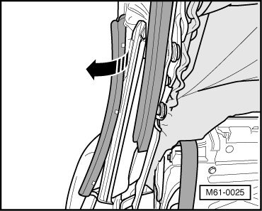

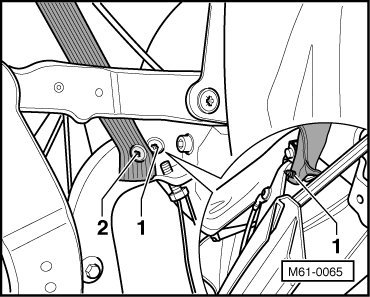

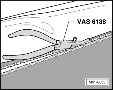

Here are the directions. The attached pics correlate with the directions.

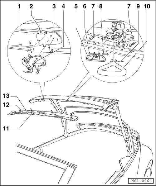

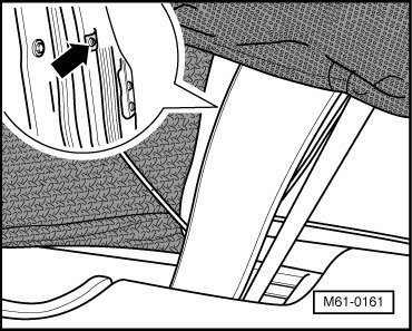

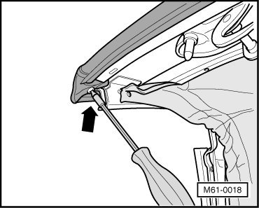

- Using plastic wedge, remove clips - 11 - from front side of roof edge trim - 13 -, then remove clips - 12 - from rear side of roof front edge trim.
- Turn handle - 10 - 90o and loosen roof edge trim - 13 -.

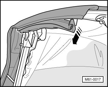

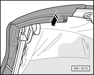

- Pull front roof frame seal off roof frame - arrow -.
Pic 2

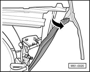

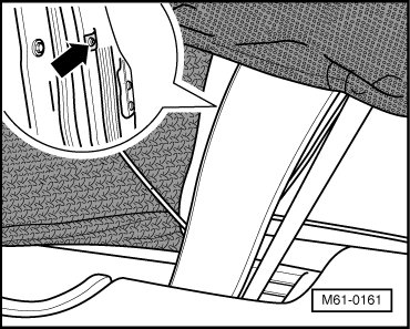

- Remove mounting bolt for convertible top cover - arrow -.
Pic 3

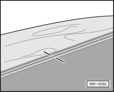

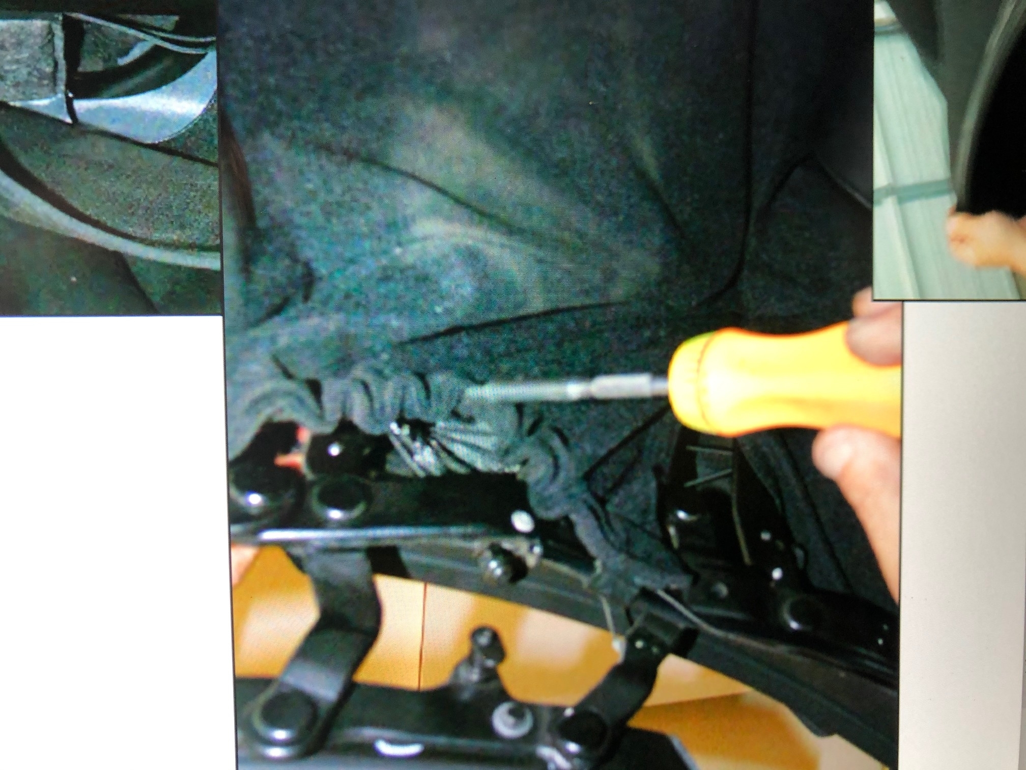

- Pull clamping strip out of front roof edge channel - arrow -.
Pic 4
- Pull convertible top cover of sealing tubing out of side roof edge sealing channel - arrow -.
Pic 5
A pliers helps ease this work step.

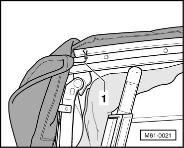

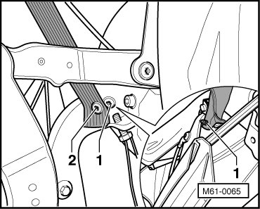

- Unhook cable with ball - 1 -.
Pic 6

- Remove bolt - 1 - for convertible top cover tension cable.
Pic 11
- Pull tension cable downward in - direction of arrow -.
Pic 12

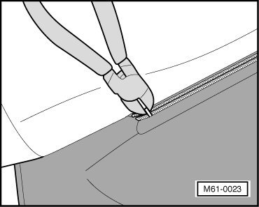

- Cut through clip using side cutter and open zip fastening.
Pic 13

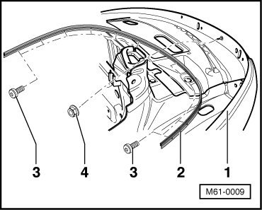

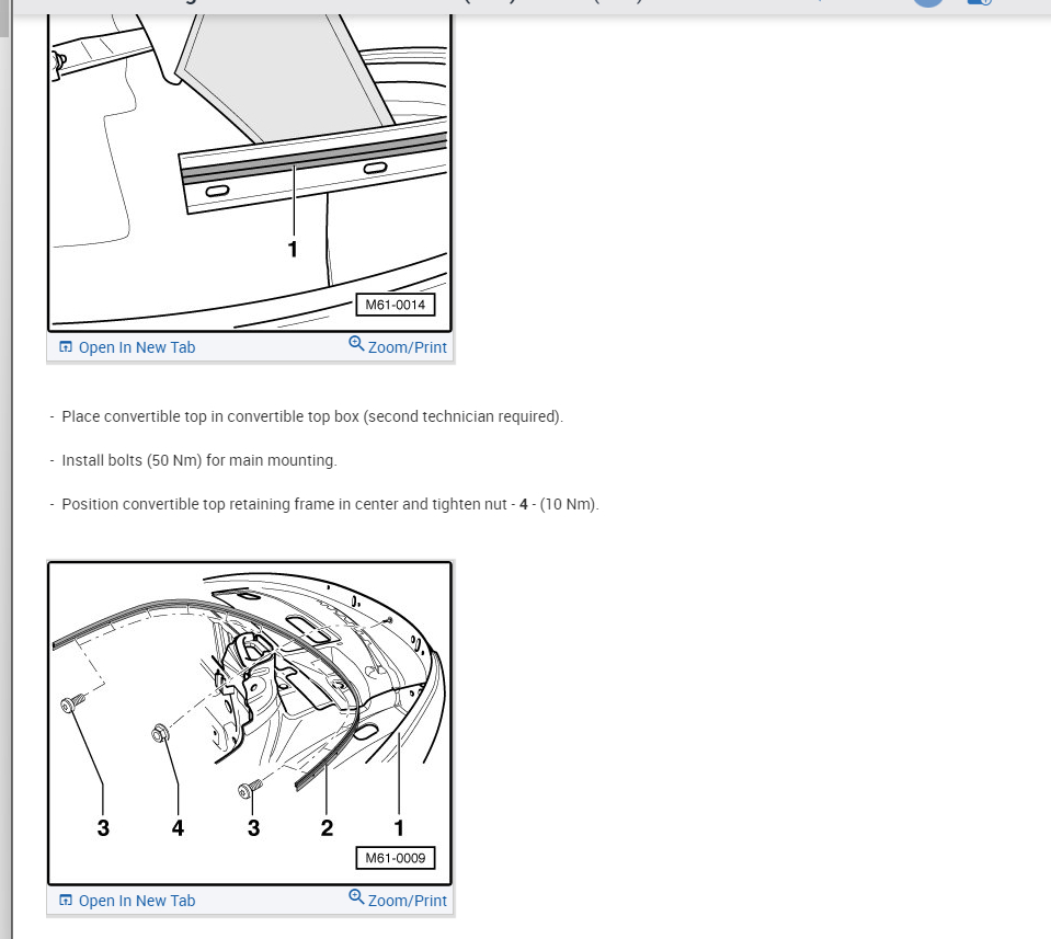

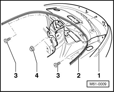

- Remove bolts - 3 - (Qty. 12, 10 Nm) and nut - 4 - (10 Nm) from body - 1 -.
Pic 16
- Remove convertible top retaining frame - 2 - from body - 1 -.

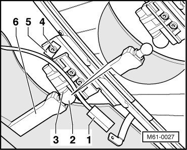

- Carefully drill out pop rivet - 4 - from retaining clip - 5 -.
- Remove securing clip - 3 - from ball socket - 2 -.
- Pull hinge - 6 - out of ball socket.
Observe routing of rear window wiring harness.

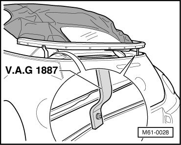

- Secure aluminum retaining frame to body using fitting bracket ( V.A.G 1887).
Pic 18

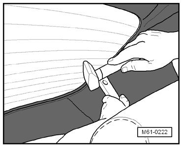

- Install convertible top headliner in rear window channel, starting from lower center upward leading to the sides. It is recommended to let engage convertible top headliner into rear window channel according to illustration, using plastic wedge and plastic hammer.
Pic 20
Make sure that both markings on headliner (upper and lower) align with notches on rear window channel. Make sure that headliner is distributed evenly along window channel.

- Using closing pliers (VAS 6138), close zip fastener beginning from center.
Pic 22
- Secure ends of zip fastener using staple gun ( VAS 6148 ) (3 to 5 mm from end of zip fastener). Make sure staple is closed correctly.

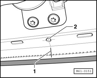

- Before installing roof edge strip into roof edge channel, align marking (strip) - 1 - of convertible top cover with center line of hole - 2 - of roof edge. It is recommended to ease pressing in roof edge strip using glass cleaner.

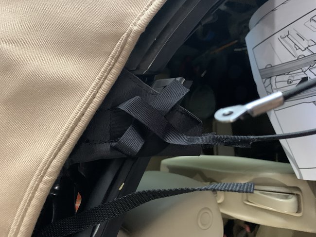

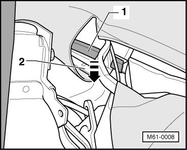

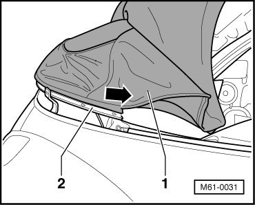

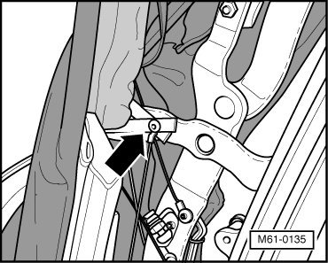

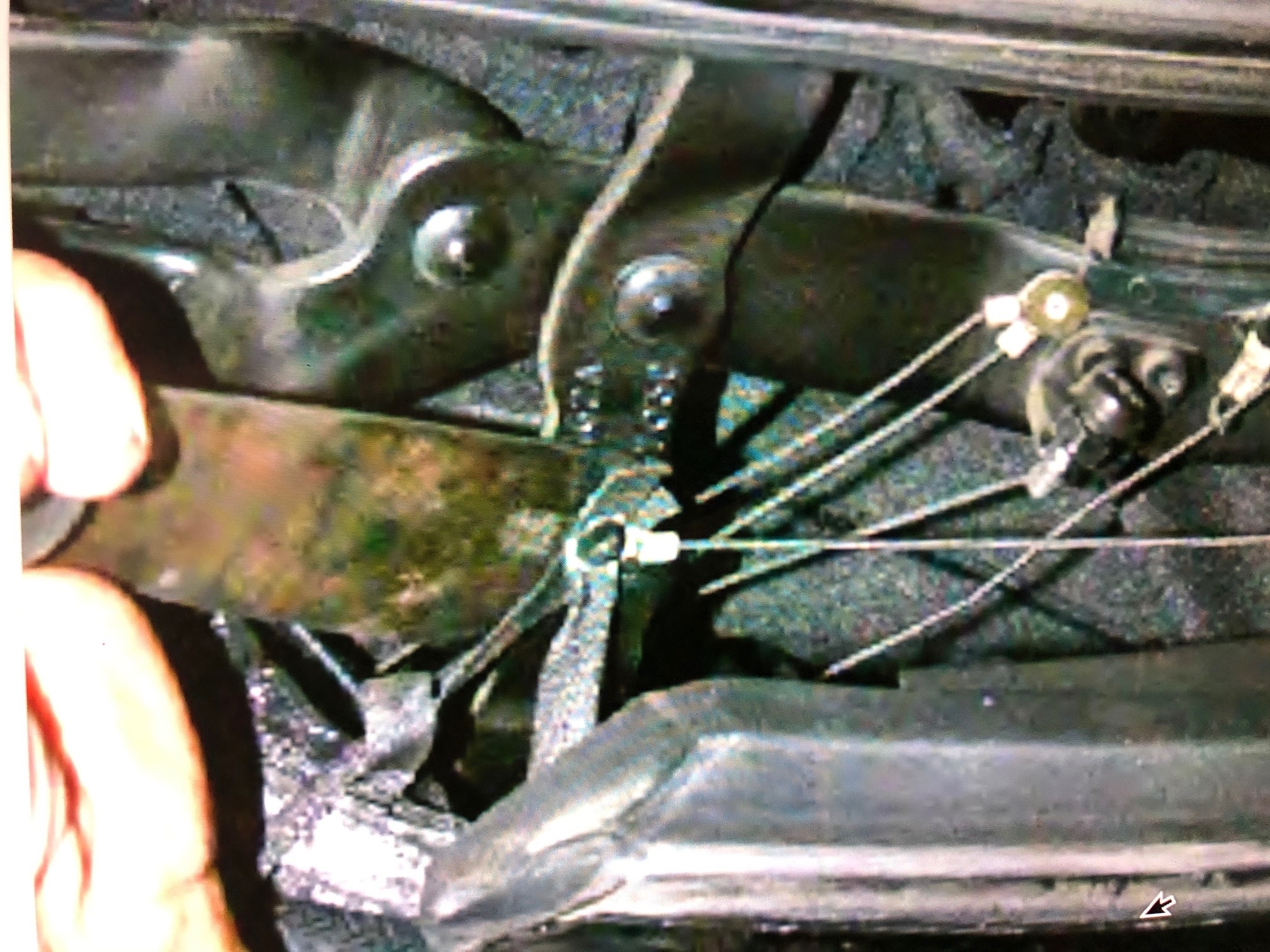

Someone else took the outer shell off. Having trouble locating where these straps go that are pictured. Can anyone help?
+1
Saturday, October 10th, 2020 AT 1:15 PM
NASER NASER
  • 836 POSTS
I have done 3 of these and I always take pictures of where they strap to as it is very confusing. The one with the cable is obvious, the one that is loose straps to the inside frame, they should see a hole, but there is another little strap that has a banjo like hole which also straps to the same hole, hard without pictures. The other one that isn't showing in their picture goes underneath the inside headliner, so it depends on which one they have already attached.
Saturday, October 10th, 2020 AT 1:24 PM
GCOOTS
Thanks for the pics. I tried to make out where things went. Guess I was wrong! Top won’t close all the way. Back to the drawing board. There are no good instructions out there.

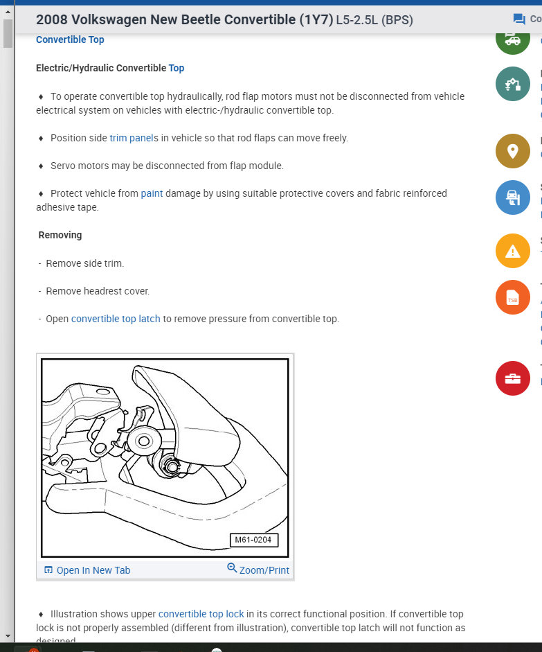

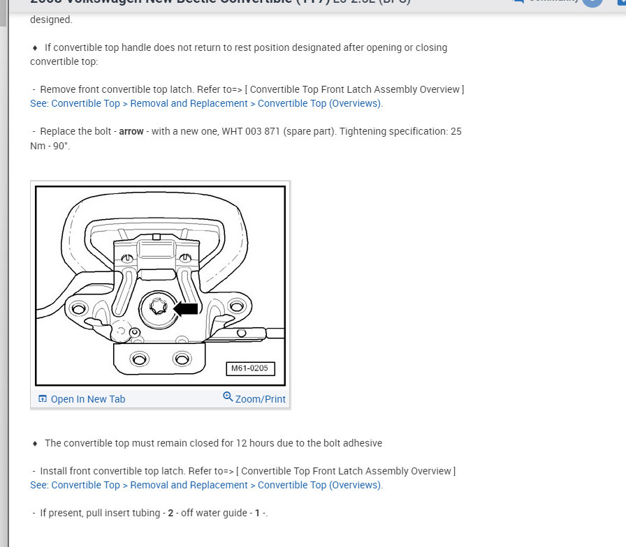

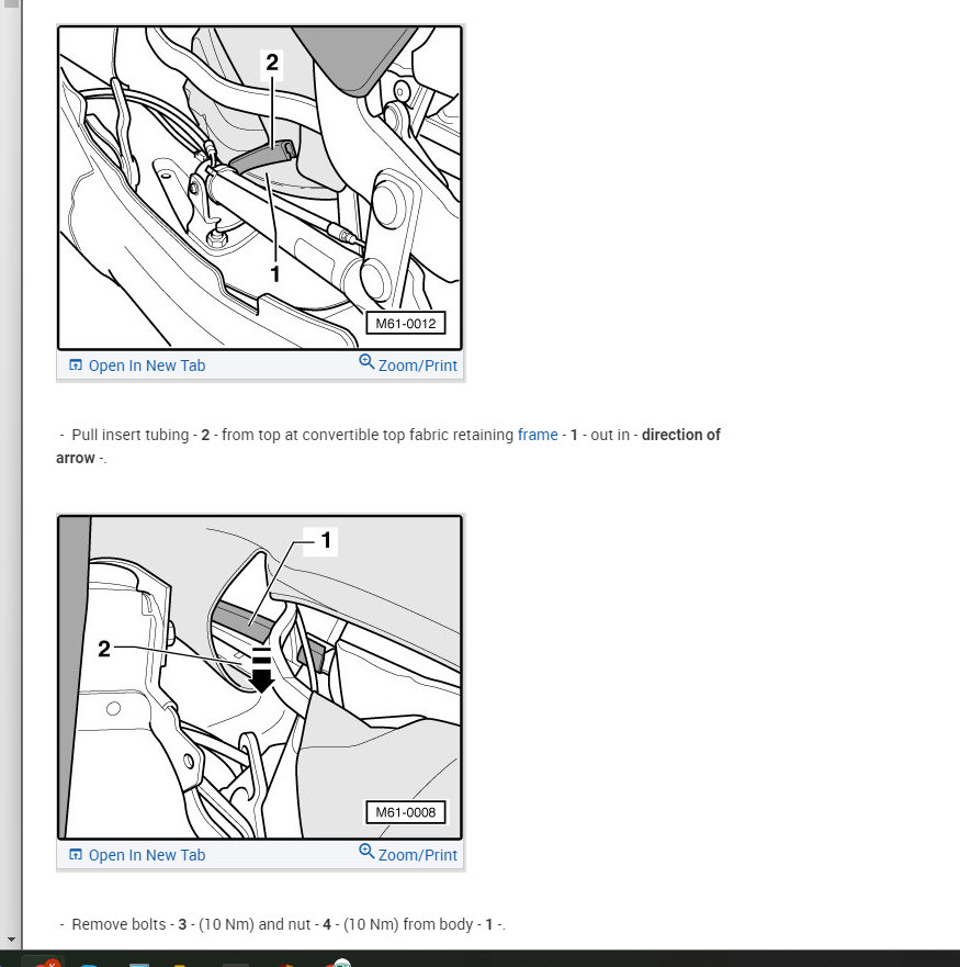

Friday, May 13th, 2022 AT 5:46 PM

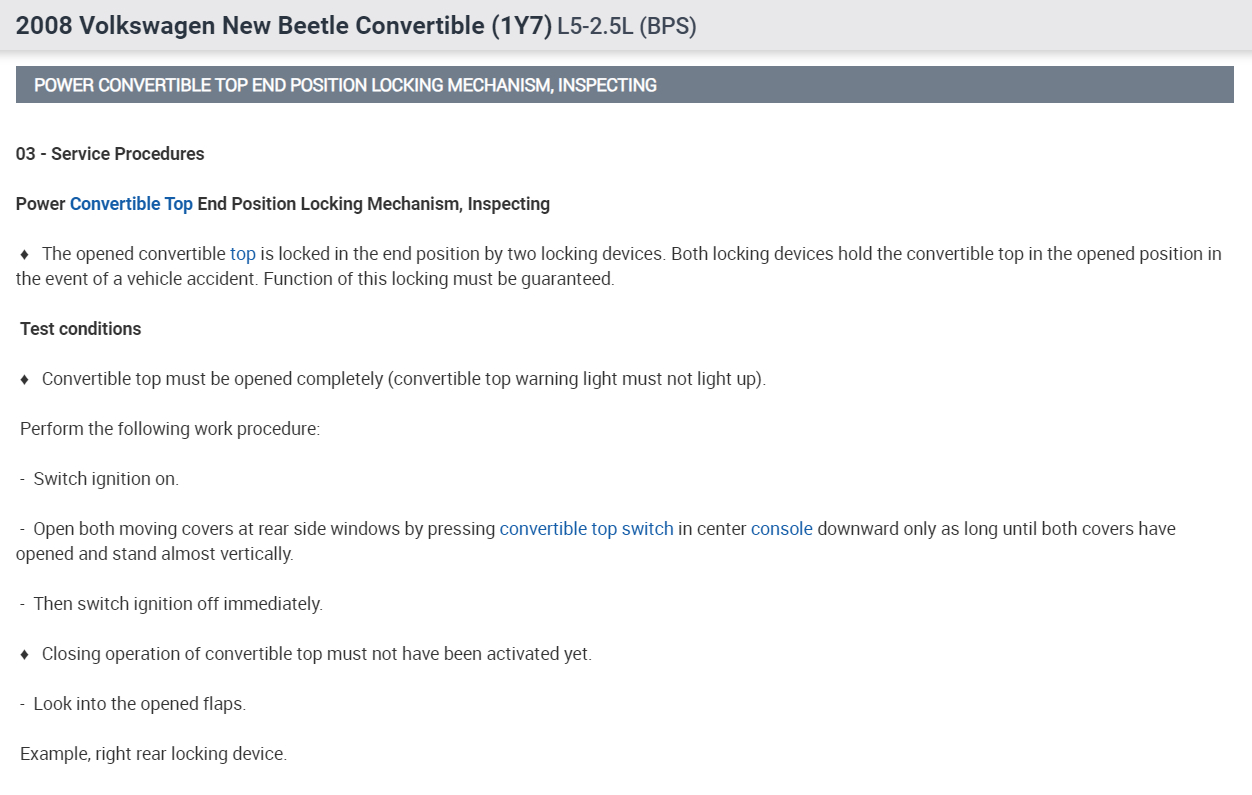

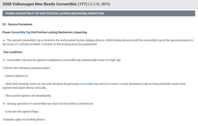

Thanks for the request. Unfortunately, we are not able to upload these as a PDF as that format is not supported by the site.

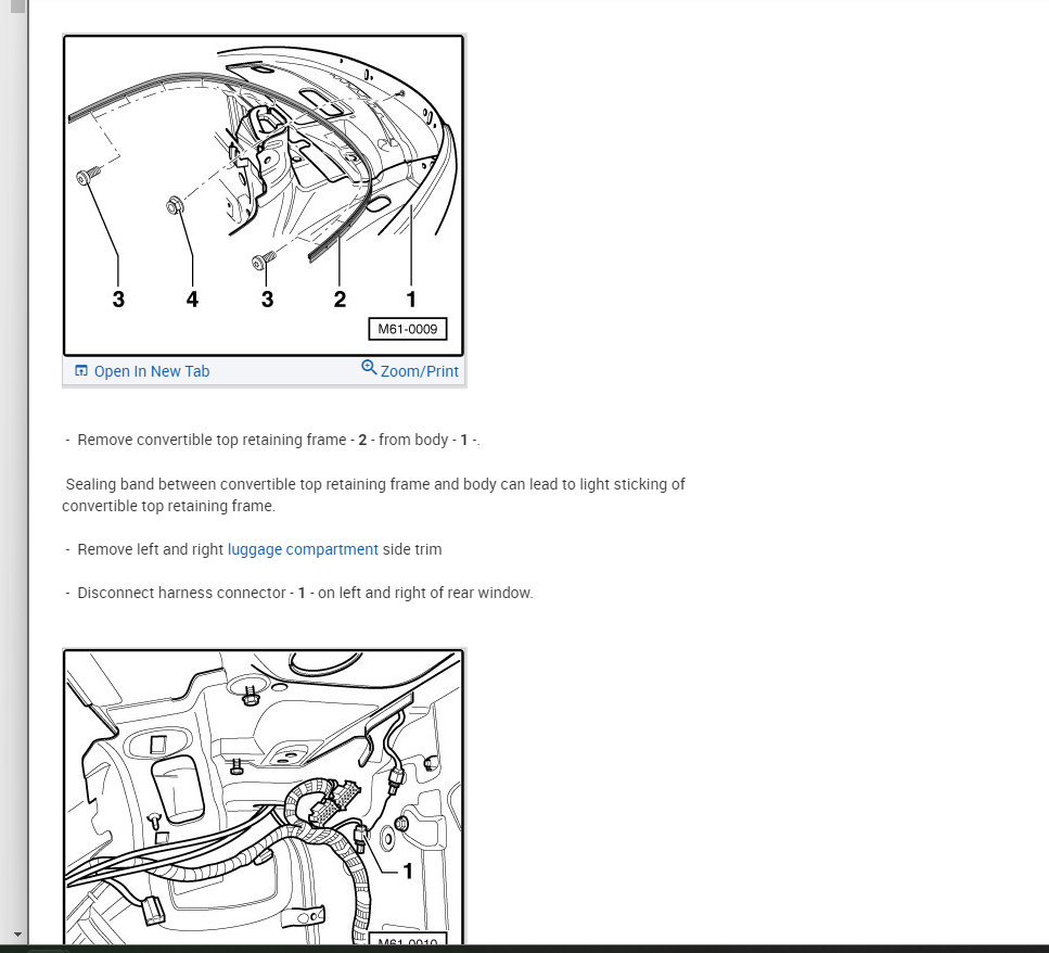

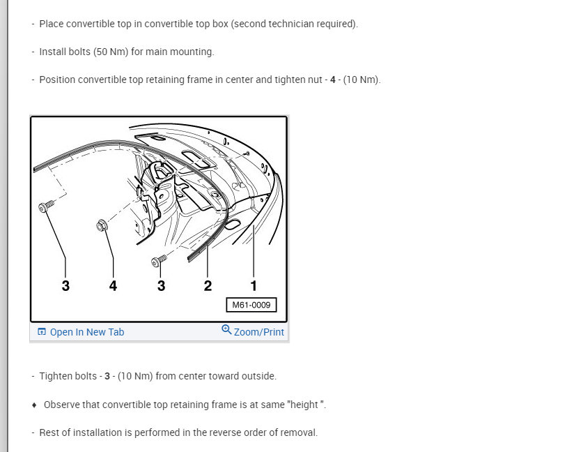

So, we have to rely on the attachments below. I attached them slightly different than what was above.
Please run through this and let us know if you need something different. Thanks
+1
Friday, May 13th, 2022 AT 7:06 PM
BUGGYBOYSHANE

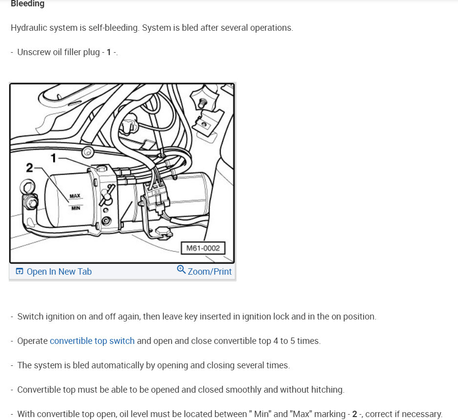

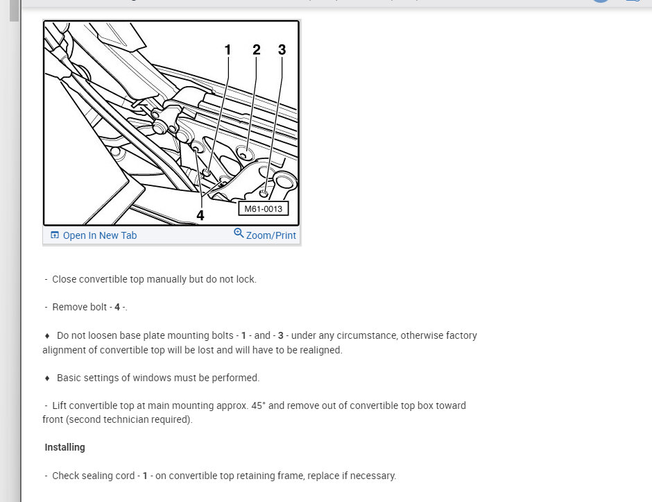

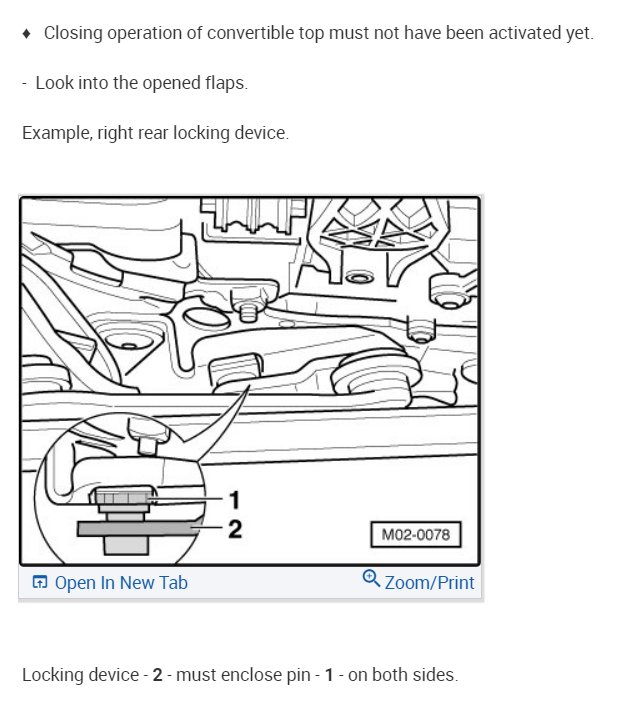

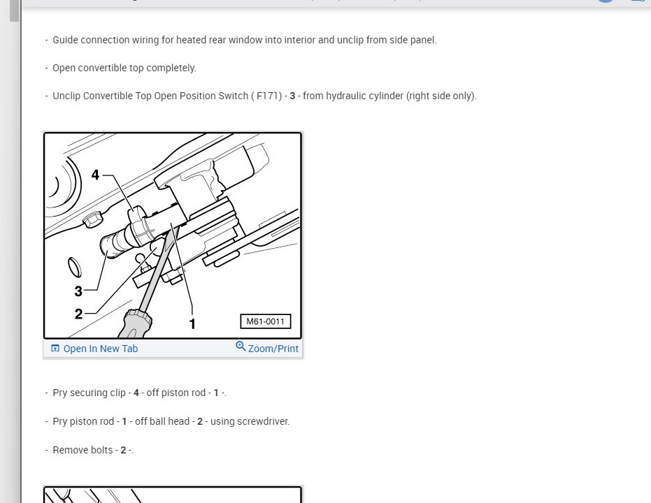

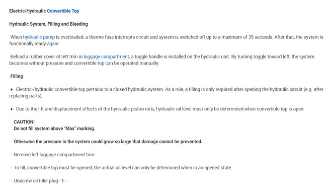

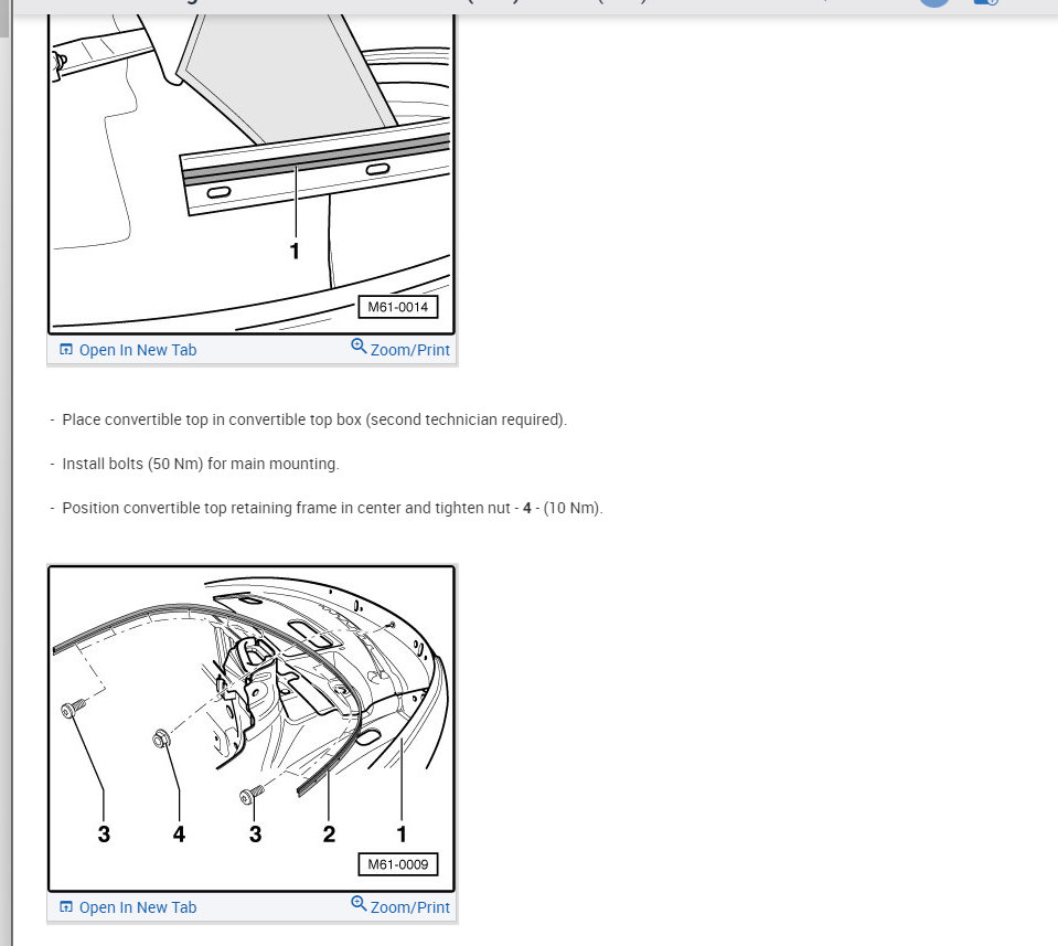

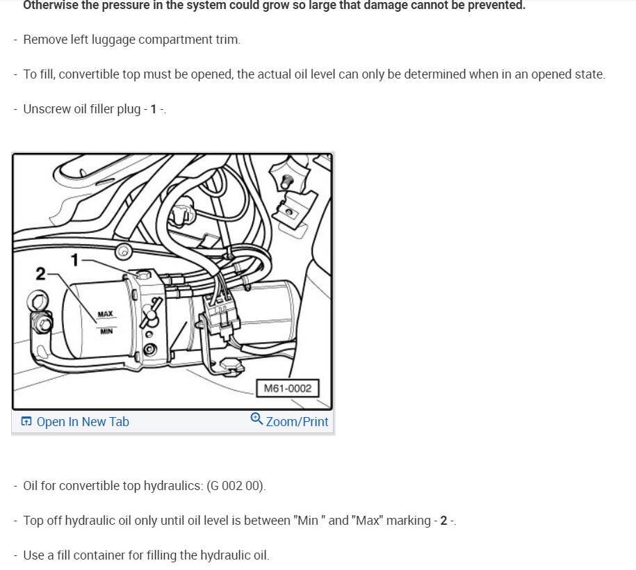

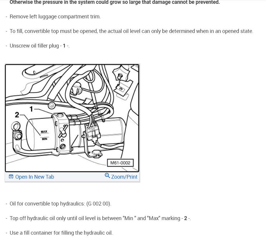

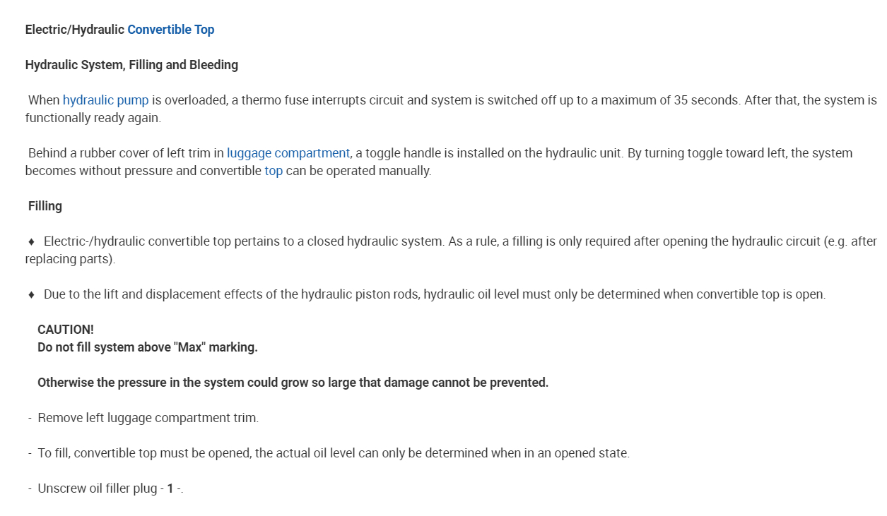

I am having the same issue here, I’ve followed all the steps I believe, but the roof is just too tight to pull the handle down to lock the roof in place. Can you provide any help on how to adjust the tension or how to move the roof forward? It’s sitting about 10mm too high at windscreen and I just get it to pull down enough. I only did the outer skin and used a used part from another beetle, so a genuine item. Any help greatly appreciated.
Thursday, August 10th, 2023 AT 1:37 AM
KEN L
  • MASTER CERTIFIED MECHANIC
  • 55,302 POSTS
I would make sure the hydraulic fluid is full and then bleed the system, here is how. Check out the images (below). Let us know what happens and please upload pictures or videos of the problem so we can see what's going on.
