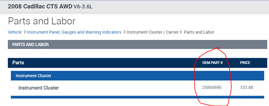

I need to buy a new one. What number do I need a match to used ones online to know if it will work for my car?
Friday, November 18th, 2022 AT 9:46 AM
MECHANIC
110,194 POSTS

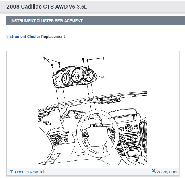

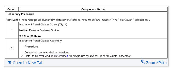

When you say control panel, are you referring to the instrument cluster? If that is the case, pic 1 below indicates the OEM part number.
I'm not sure if you need them, but the last two pics are the directions for the removal and replacement of the cluster.
