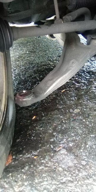

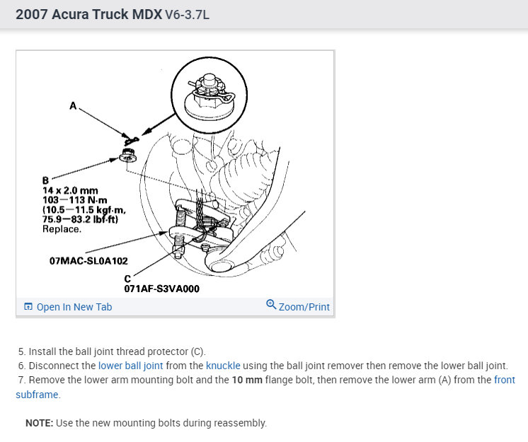

The car started pulling hard and quick to the left back up and this is what I found. Control arm?

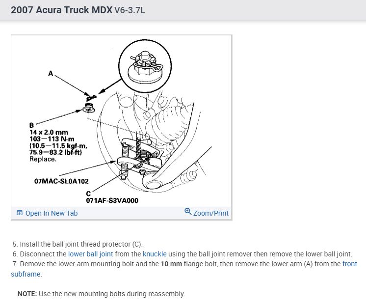

That is the lower control arm that has the ball joint broken/separated.
Keep in mind that it is not safe to drive the vehicle in this condition.

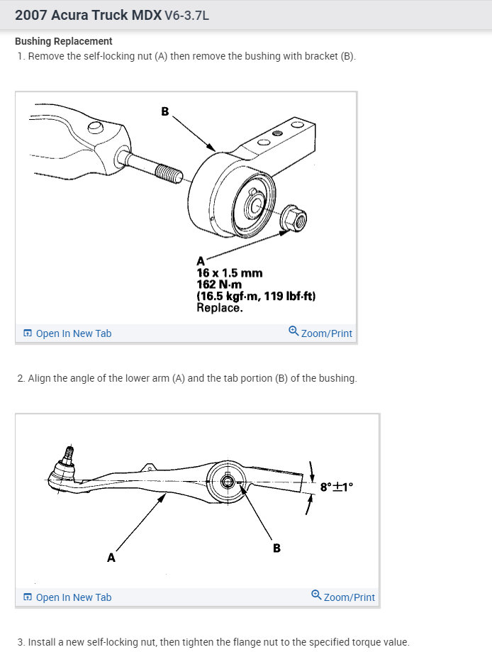

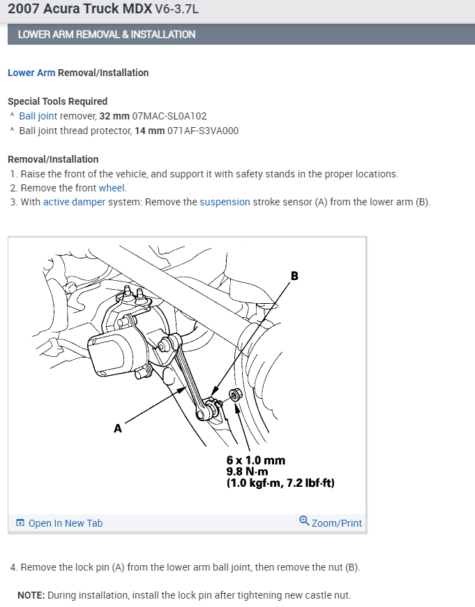

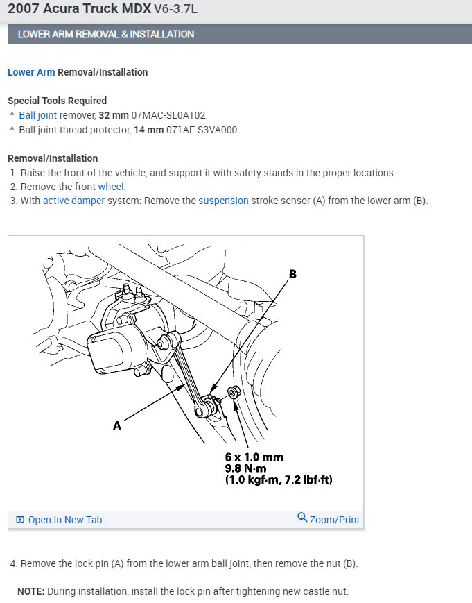

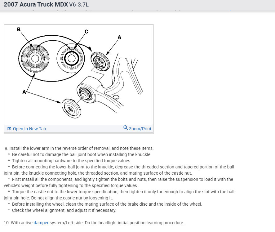

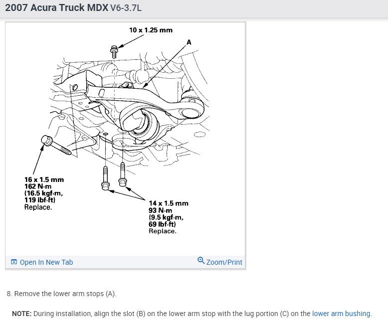

I have attached the replacement procedure for the control arm below.
Let me know of any questions.
https://www.2carpros.com/articles/lower-control-arm-bushing-replacement
